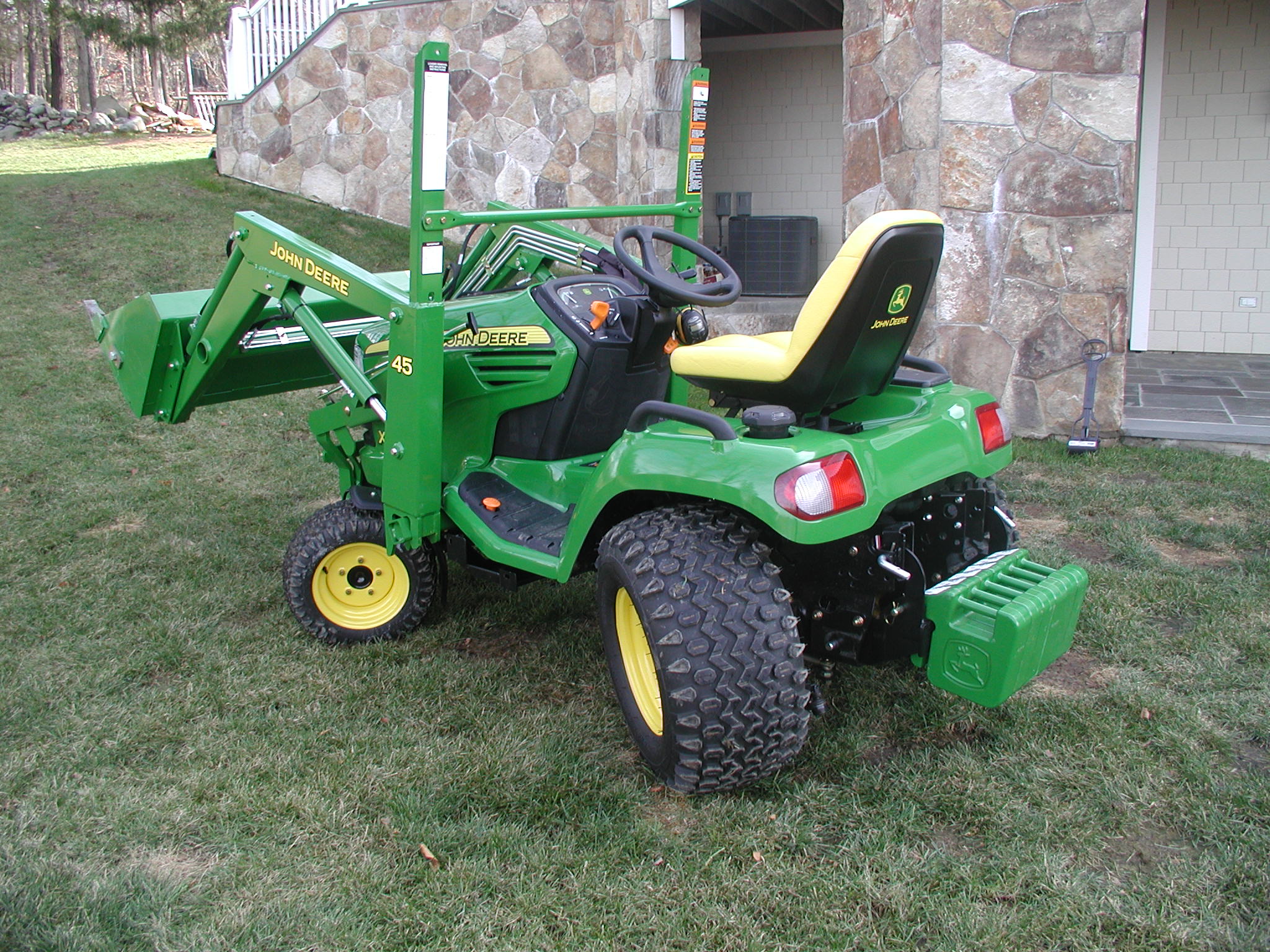

45 loader on a X729, no problem. Here's mine.

Deere Dealers are not supposed to sell loaders for any AWS tractor but hopefully yours will bend the rules for you (obviously Tommyadvanced's dealer helped him out). I'm not sure which catalog you were looking at but all the current brochures and online info do not list the 45 as as compatible with the X729 (or X749 which is also AWS). That's not to say you can't put a loader on, but Deere Engineering does not recommend it on AWS tractors since it's easier to roll the tractor over if you are turning tightly with a loaded bucket.
I'm not trying to be the Loader Police here, I'm just telling you so if you get any grief from your dealer you know why. If you are only moving around light stuff and you keep the bucket low to the ground you shouldn't have any problems. But if you have an accident or cause any damage to your tractor Deere will NOT cover any of it.
