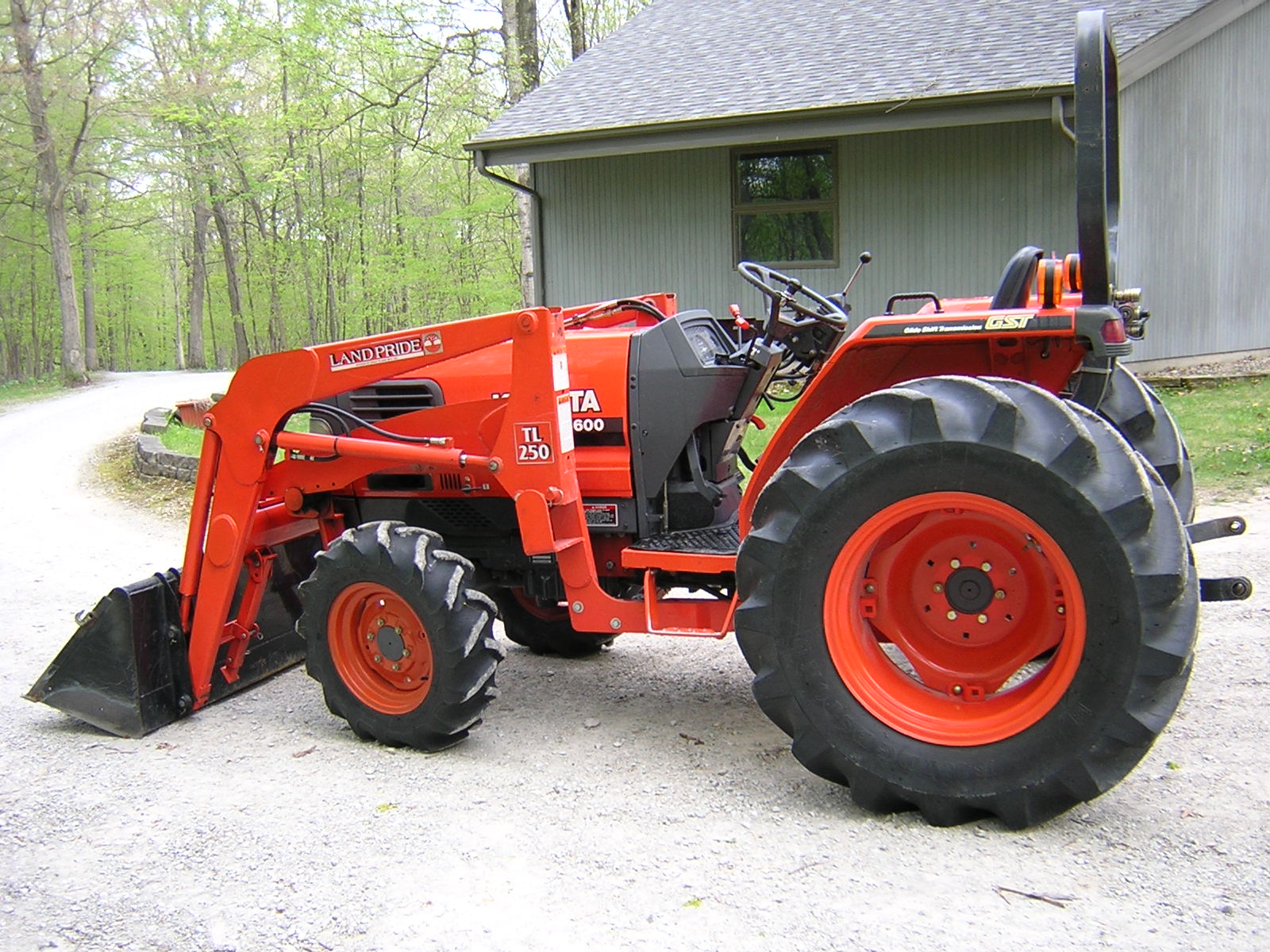

Gotta sell my '96 L3600GST. Need some help in deciding what to ask for it. Here are some details:
4WD, Landpride loader, 720 hrs.,looks new (always shedded), mid and rear PTOs, ballasted ag tires, 1 rear hydraulic remote plumbed thru a triple circuit
solenoid operated manifold (lets you control 3 seperate cylinders by flipping solenoid switch), shuttle and glideshift transmission.

I'm a geezer--never posted any pictures. But I'll give it a try.
