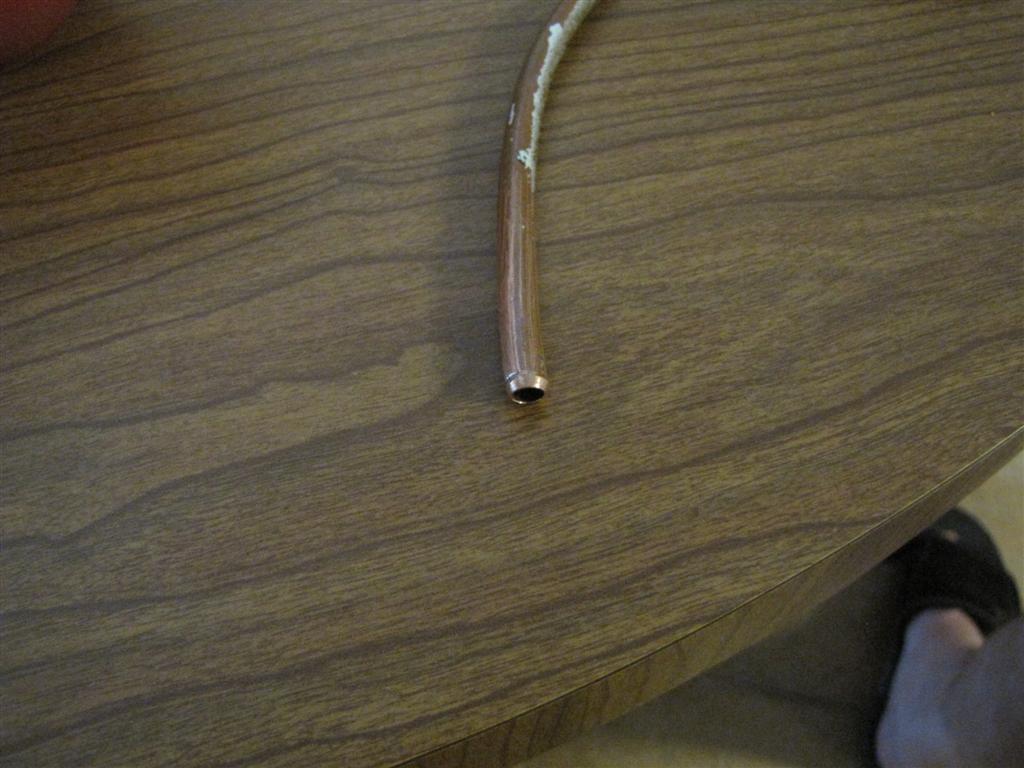

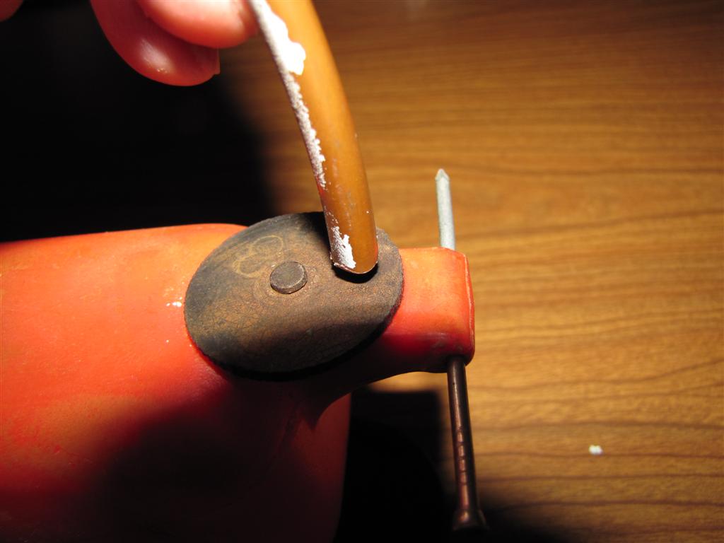

I looked for the old valve that I made but could not find it. I did find an old float. This will illustrate how this valve works. The tube is a copper tube that I beveled at the end to a fine point. The rubber disc on the float is 1.25" D so a small valve can be made. For this particular valve the most critical part is that the pivot point is placed so the rubber disc and the tube meet at a right angle. This will provide the best seal.
As the water rises the float will move up and the seal will contact the tube. This will start sealing the water flow. As more water rises more pressure is placed on the float. Eventually the rubber seal cuts off all water flow. It does not take a lot of pressure to stop the flow.
IIRC, when I made my valve I used a metal cap that fit the end of the hose. I drilled a hole in the cap to pass the tube. I made this a tight fit and then sealed the hole edge so no water passes. Then I just made the housing that holds it all together.
Rethinking this valve idea for your needs, I would make a small pivoting float. Like thin PVC pipe. Seal both ends a grind as much material away from the end caps to make it as light weight as possible. Then you could work this valve in at an angle and then secure the water hose vertical. I think it is possible that this may work. Any way hope this helps and good luck with your project.
