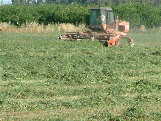

Here's my neighbor's self-propelled swather, an old Hesston 6650 that he bought for about $6K. The sicklebar head is 13-15 ft wide IIRC.
He mows 30 acres of irrigated alfalfa (three 10-acre fields). Takes about 7 hours to do all 3 fields. Mowing interval is about 5 weeks (May thru Oct).
