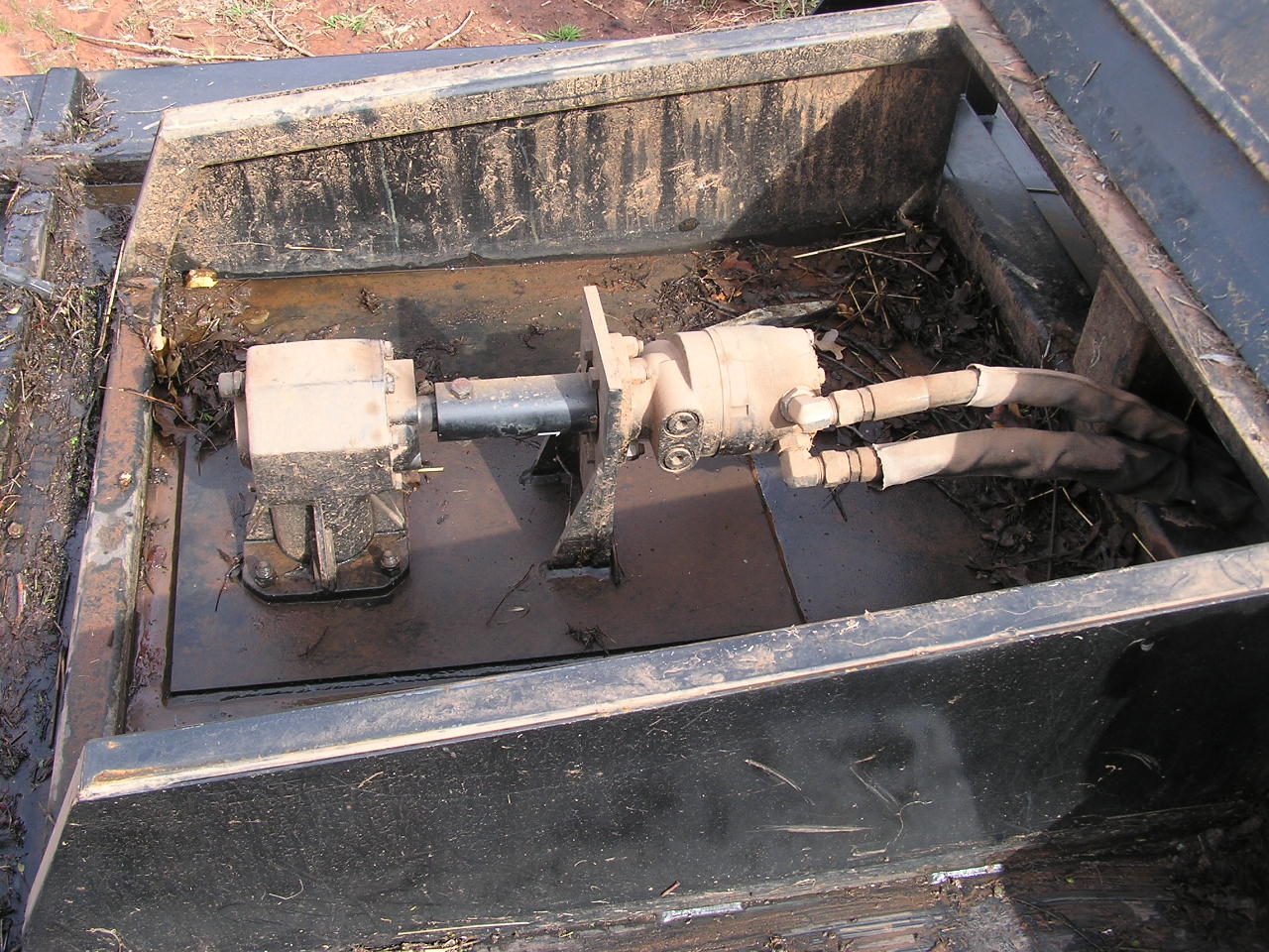

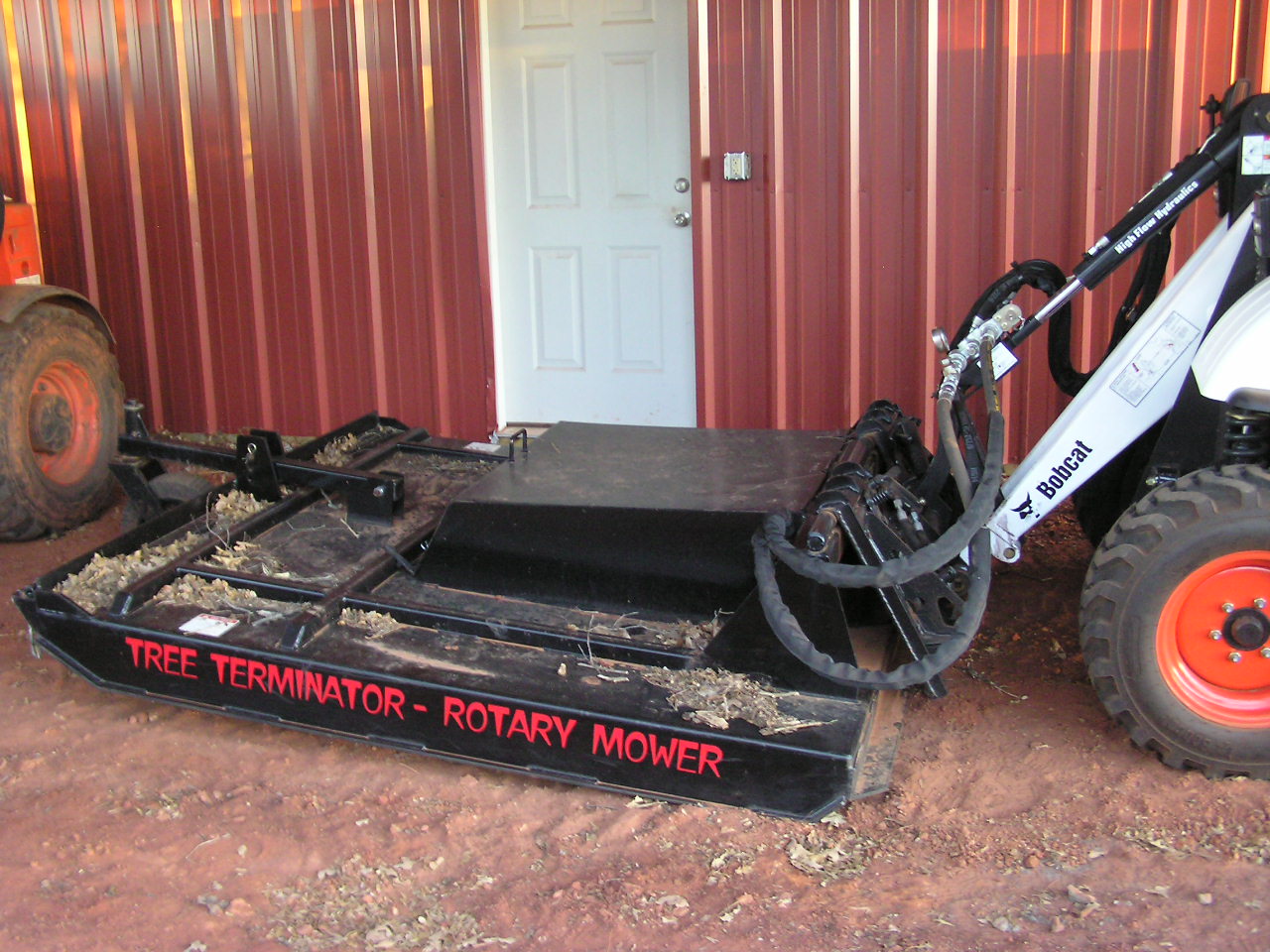

For power, consider hydraulic. Depending on your tractors hydraulic specs, you would likely need a PTO hydraulic pump and reservoir. There have been several conversions posted here on TBN.

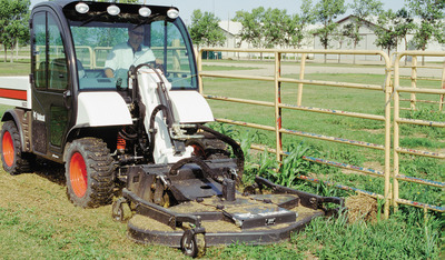

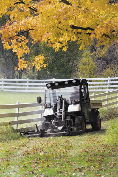

Front is best for me and the 7' brush hog.
Bobcat has a front mount finish mower, so you know it works.
Mower Attachment - Bobcat Company
And one for a UTV.
Mower Attachment for Utility Vehicles (UTV) - Bobcat Company
