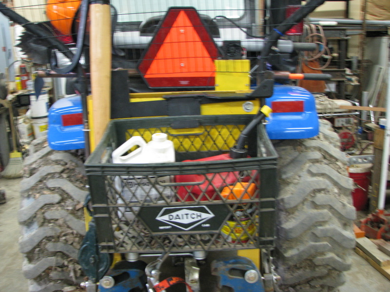

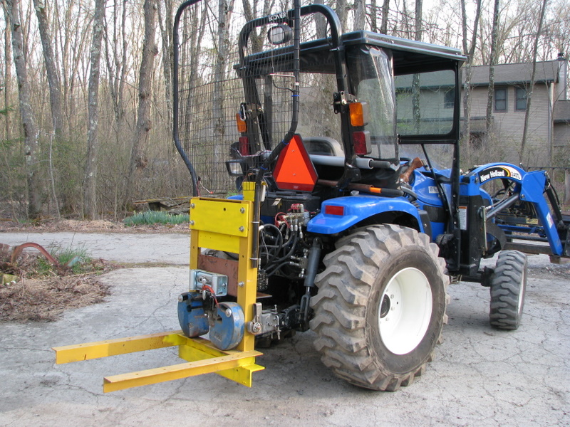

logging winch plus

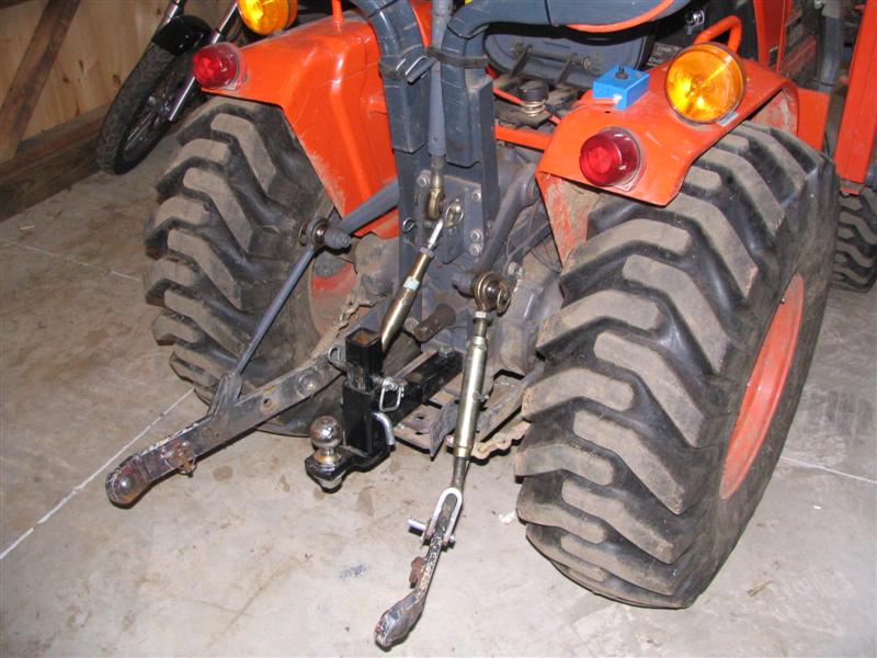

Needed a real sturdy fixed hitch for pulling a 10,000 pound trailer with up to 2,000 pounds of tongue weight with a 20 hp tractor. My solution was a bolt on truck hitch with a top link to suspend the tongue weight from the 3pt top link attachment point. Here's a picture.

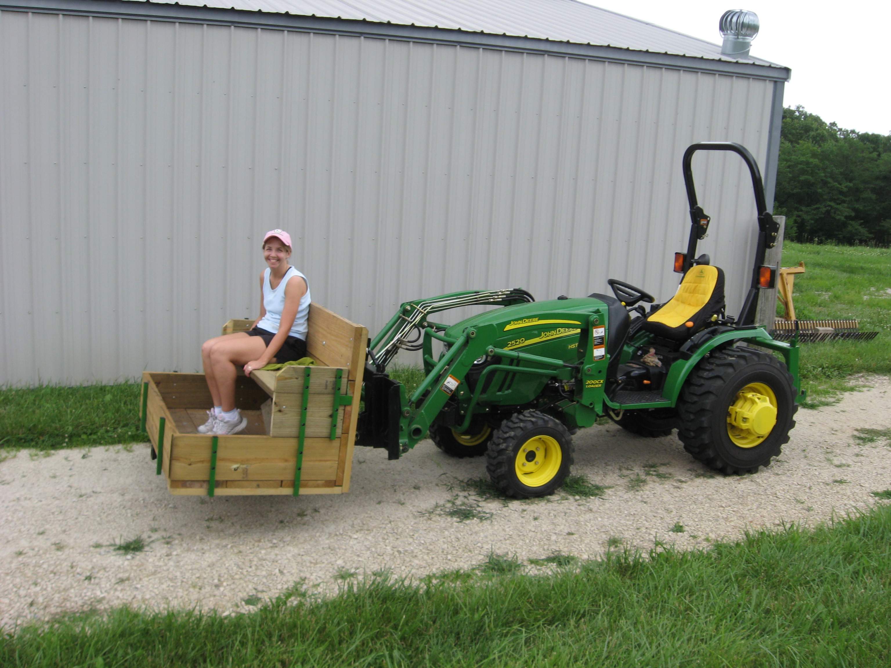

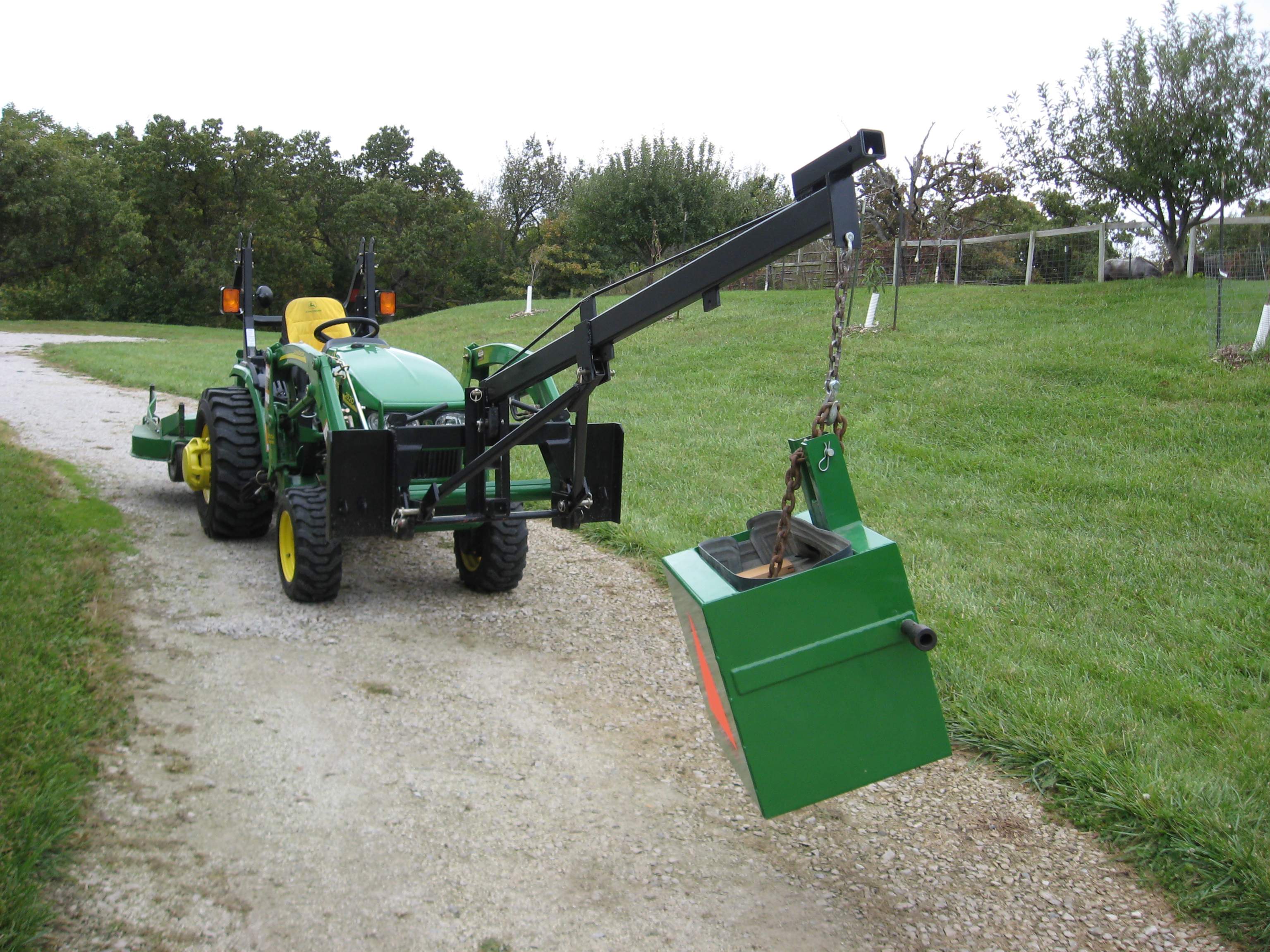

My most used is the front quick-hitch (either with, or without my three-point hitch mounted). With it, I can put any three-point attachment on the front, including my carryall. Coolest so far is my boom pole (in my humble opinion).

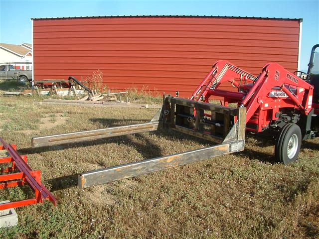

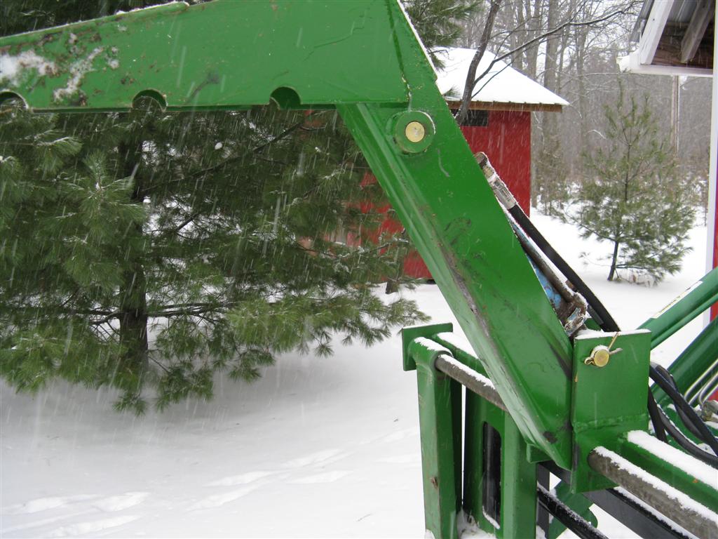

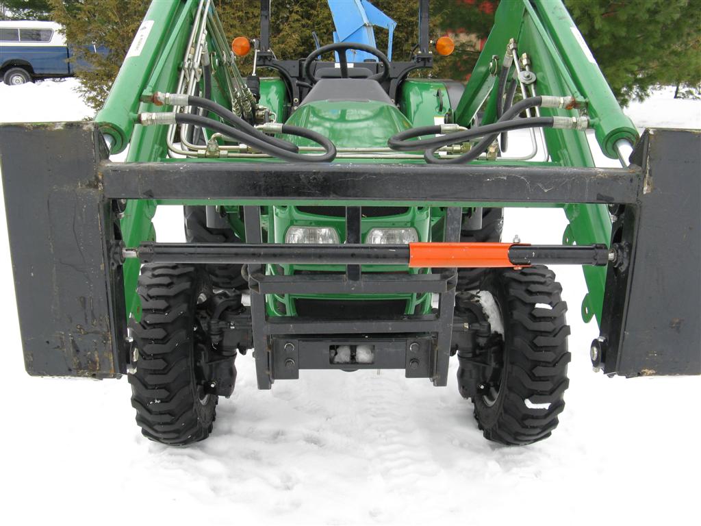

Bale accumulator/bale squeeze with skid steer QA adapter for my Mahindra 5525.

I am debating building something very similar to your carryall. My father is in a wheelchair and visits once a year. There are 5 steps to get into my house, which makes it hard for him. I was thinking I could use something very similar to what your carryall looks like to lift him to where he can just roll out onto the porch.

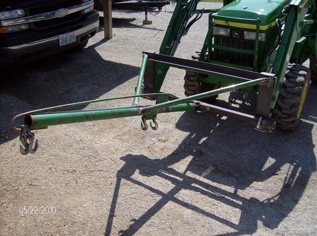

5' boom for my 300 loader, so far, it's painted now:

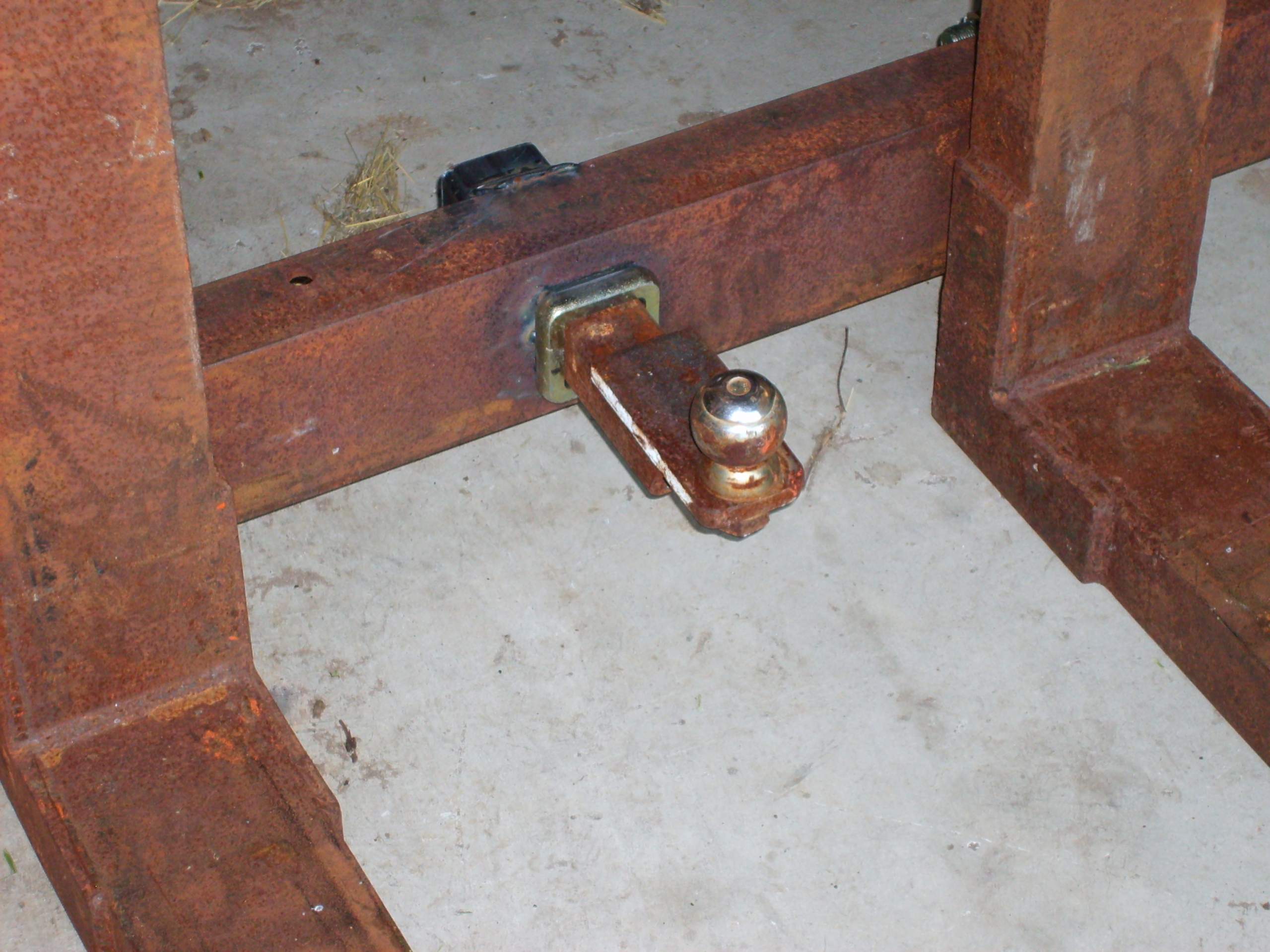

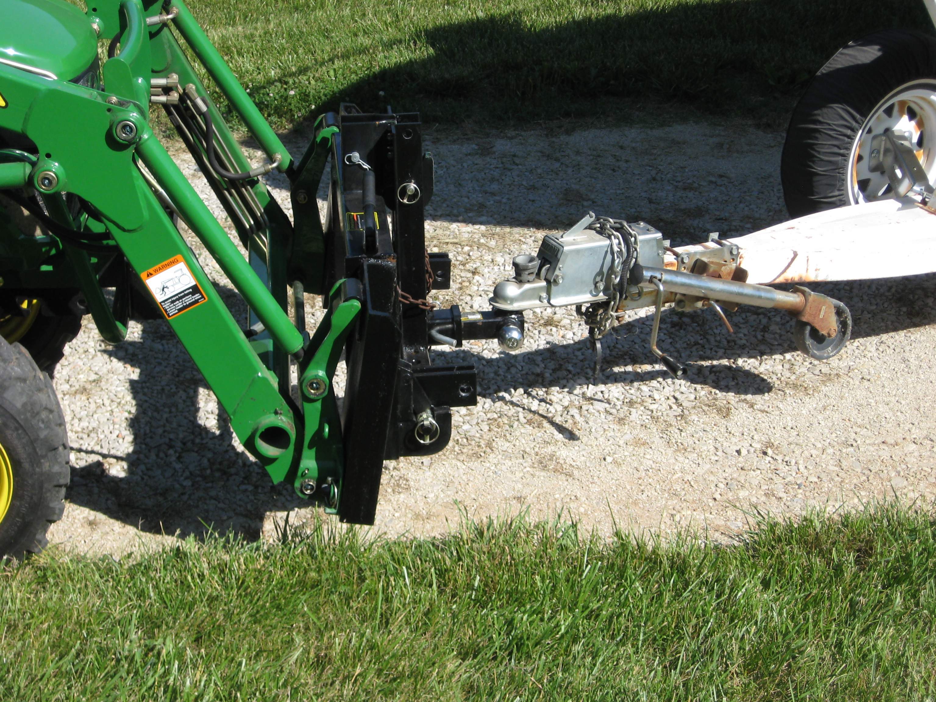

So far it's my forks. So many uses and I'm adding more to attach to the main frame. Receiver and top trailer ball as well. A boom pole is in the planning stage to adapt to the main frame.
