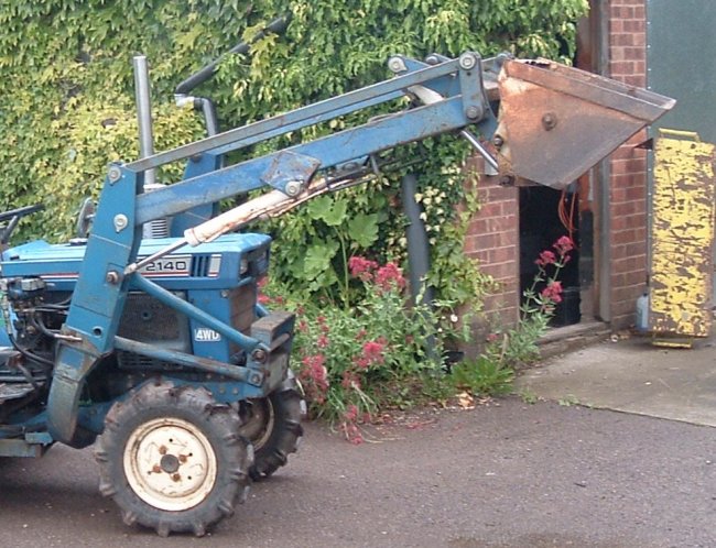

I have an Iseki 2140 with a Polymark front end loader with a self levelling bucket. Has anyone engineered any sort of indicator to give the position of the bucket without having to lean over to look at the side of the bucket?
Thanks for any useful ideas :)

I have seen on other tele handlers and the like, the indicator is just a bit of round bar that slides with the front bucket mounts with a couple of 45 deg bends that locate or sit by a marker, it would just need welded/bolted on, hope that makes sense, have you seen the type I refer too, you will have seen them too.

Weld a piece on the top outer edge of the bucket that is parallel to the bottom of the bucket then regardless of the position of the bucket you'll always be able to reference the angle of the bottom of your bucket.
