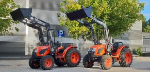

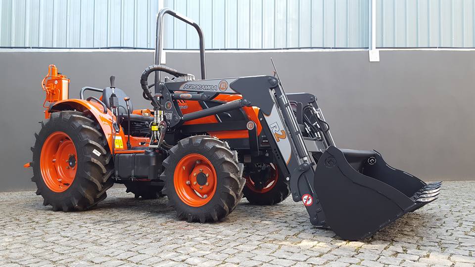

If you are into fabricating/slightly engineering, you could retrofit your loader with this style. It's been used for years over here. Basically you have two additional cylinders mounted above the lift cylinders that are tied into the curl/dump circuit. Whenever you lift the loader, these small cylinders will work as slave cylinders and keep the bucket level.
Now the tricky parts is to figure all the volumes and pivot points to make sure the bucket stays leveled on the full lift range of the loader.

What is that option you're talking about on Branson? Do you have a link for any info on this? Over here, Branson are sold with an aftermarket self-leveling loader while in the US, they are sold with non self leveling loaders. I know they have been working on something about self leveling loaders tho.

My buddy has a 55HP Kioti and there aren't any extra cylinders, his is all done with linkage. I'm guessing the valve will have to be specific as well as the tilt cylinders will have to have a place for fluid to go as it remains level. He would like for me to fab up the same linkage for his new 50 HP Kioti but I don't think it's that simple.
   / Self Leveling Mod for Compact? #7
212 Kioti Dk55 Tractor W/ Self Leveling Loader
Edit: After looking at the pics in the link above it may actually be that simple :)
Edit again: KIOTI VERY LARGE Compact Tractor DK551 4WD Hydro Shuttle 55HP & Front Loader - PS99,995. | PicClick UK
This has some clearer pictures

These are aftermarket loader. For some reason, we don't get original loaders for any brand of tractor for that matter. So who wants a loader on their tractor, just get an aftermarket one, which are actually very well built.
The loader valve is just a regular one, with float and joystick. I think they add a dual cross line relief valve on the dump circuit.

Anyway, 95%, if not more, of the loaders, are self leveling. Either mechanically or hydraulically like the ones I've shown before.
