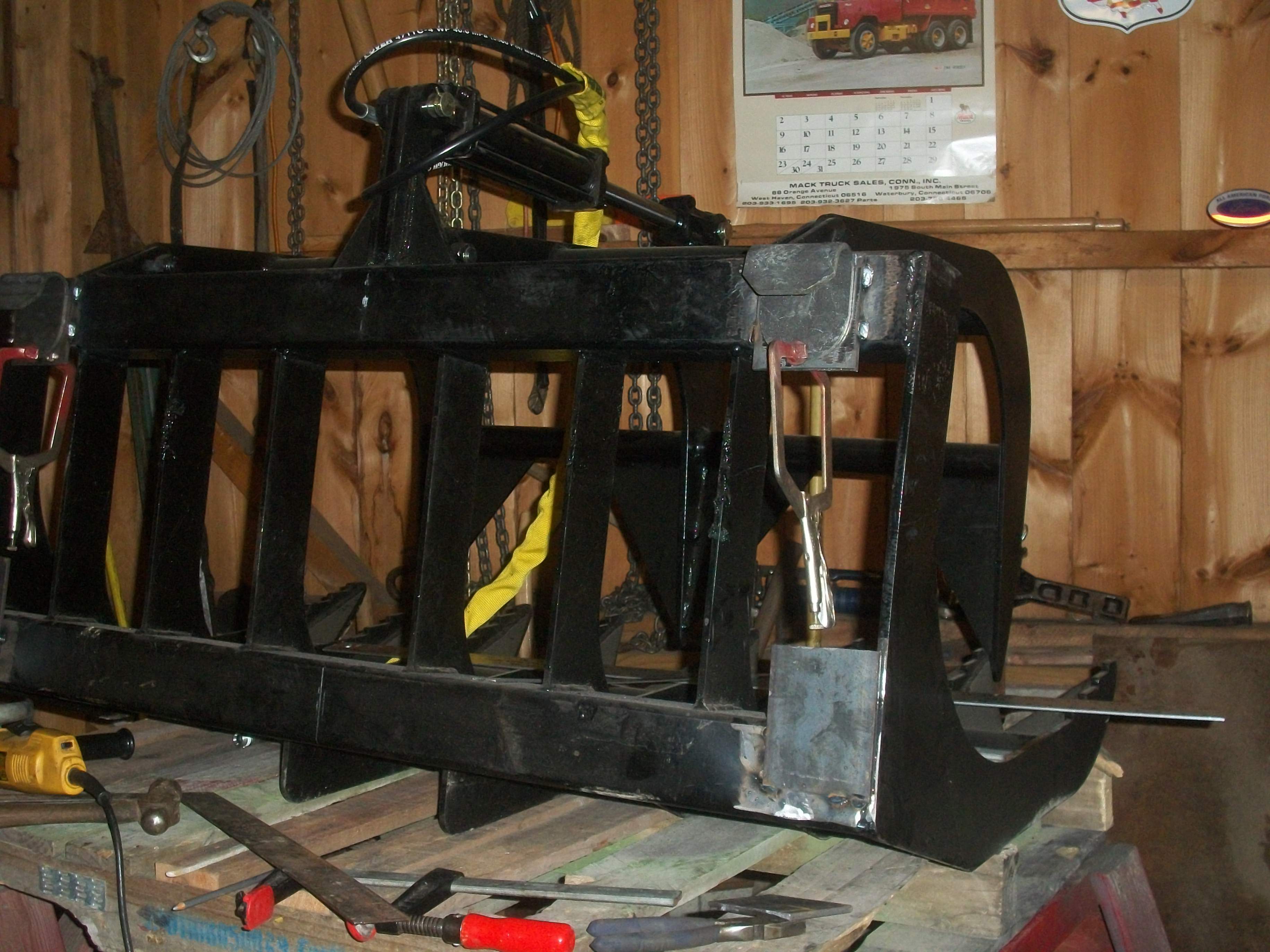

Hello;
I will be installing this grapple on a JD 3320 w/ 300 CX Loader.
I am seriously considering one of two models from ATV Skid Steer in Memphis, Tenn.
The model RG-LW72 at 595# is classified as a Light duty
The model RG-R72 at 700# is classified as a Heavy Duty.
I'm leaning toward the Heavy Duty thinking that the 105# more weight won't hurt me.
Any of you folks using these or any other models from this company?
Thanks, nicholas

I have the same tractor as you.....and after reading lots on grapples I went with a lighter 48" model made by Markham / Gator.
I would not want a larger grapple. This one does all I need it to do and does not "overpower" the size on the loader. Lots of reading on grapples at the attachements section.....do a search for hours upon hours of reading. Most guys will steer you to a size such as I describe for your tractor.
Good luck.

The 2 you listed are too heavy for yor 300x loader. Get a lighter wildkat model.
   / Selecting A Grapple #4
I agree. I have the 48" Markham. The 48" Wildkat would be plenty also. IMHO my Markham should have 8-12" shorter tines. Sticks out in front quite a bit. 48" is good for getting around in the woods and trails, any wider and it's harder to snake around.
I think Markham unit is now North American Implement product weighing 385 lbs. You want it lighter for that size tractor and loader. http://www.northamericanimplements.com/wp-content/uploads/NAI-CATALOG.pdf

I have the 48" markham and it has performed flawlessly...and I have done my best to put this thing to the test. Go for it! Good folks to work with, too.

A word of caution: When I bought my grapple I thought I was buying from Markham....but I ended up buying a "Gator" branded product and Malissa (Markham) was always unavailable so I got some (bad) information from one of the gals that became known as the "gator girls". Beware when ordering that you get things spec'd right as some of us had some issues with what was bought vs what was delivered. Maybe it's better now? A pretty fair product design with a history of confusion for me and some others. (I also wish the teeth were a little shorter, they put the right couplers on for deere, that they would put the deere gussets on the quick tach, and that they had some protection for the tractor in the center of the grapple....so braches dont stab the tractor.)

I bought the Skidsteer attachment grapple and modified it with JD hooks/pins for the 300cx. I can still use on my narrow QA CASE 1840 skidsteer.
got a heck-uv-a deal buying forks at the same time. Modified them also to work on the 3320 and Skidsteer.
