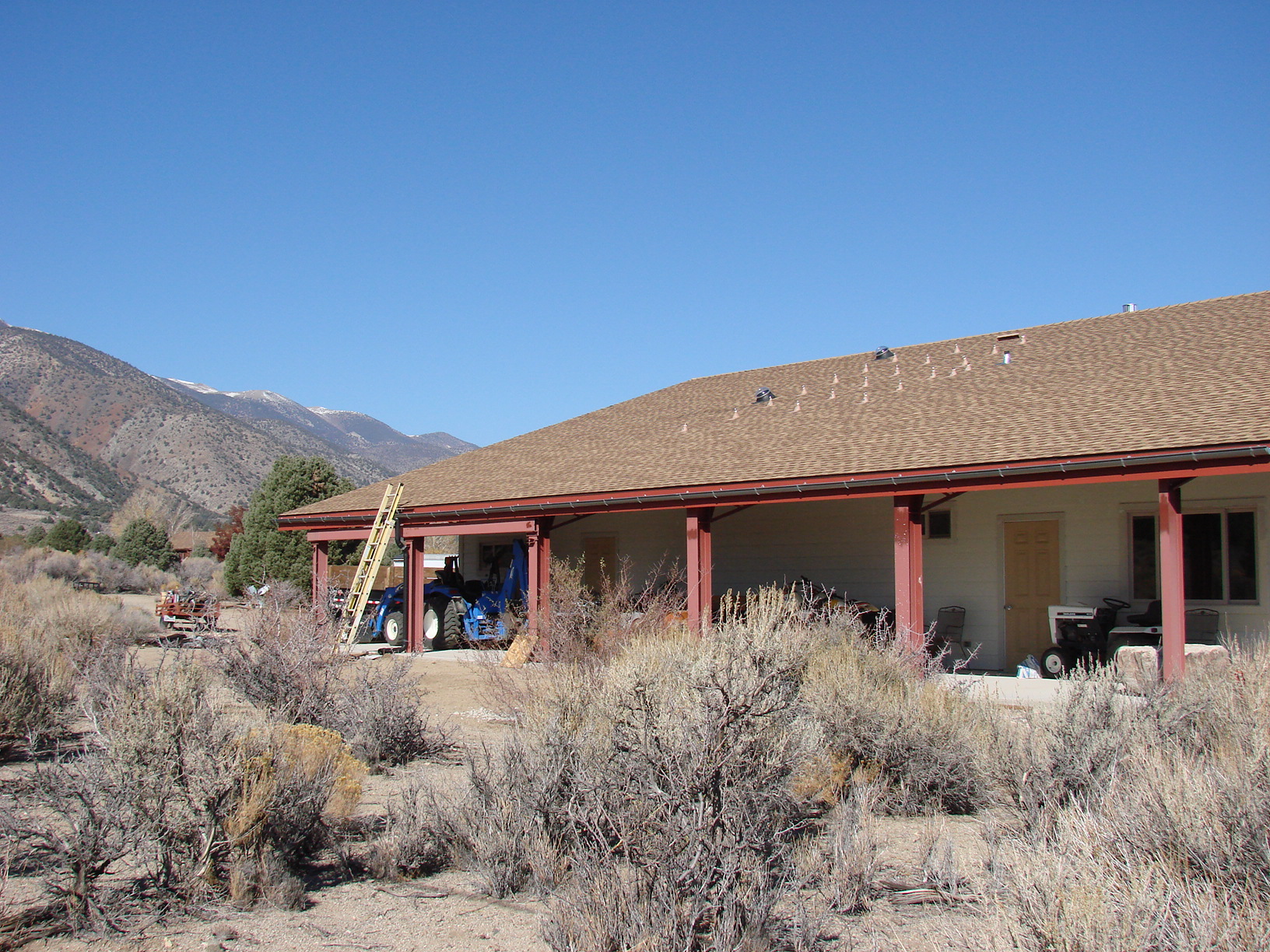

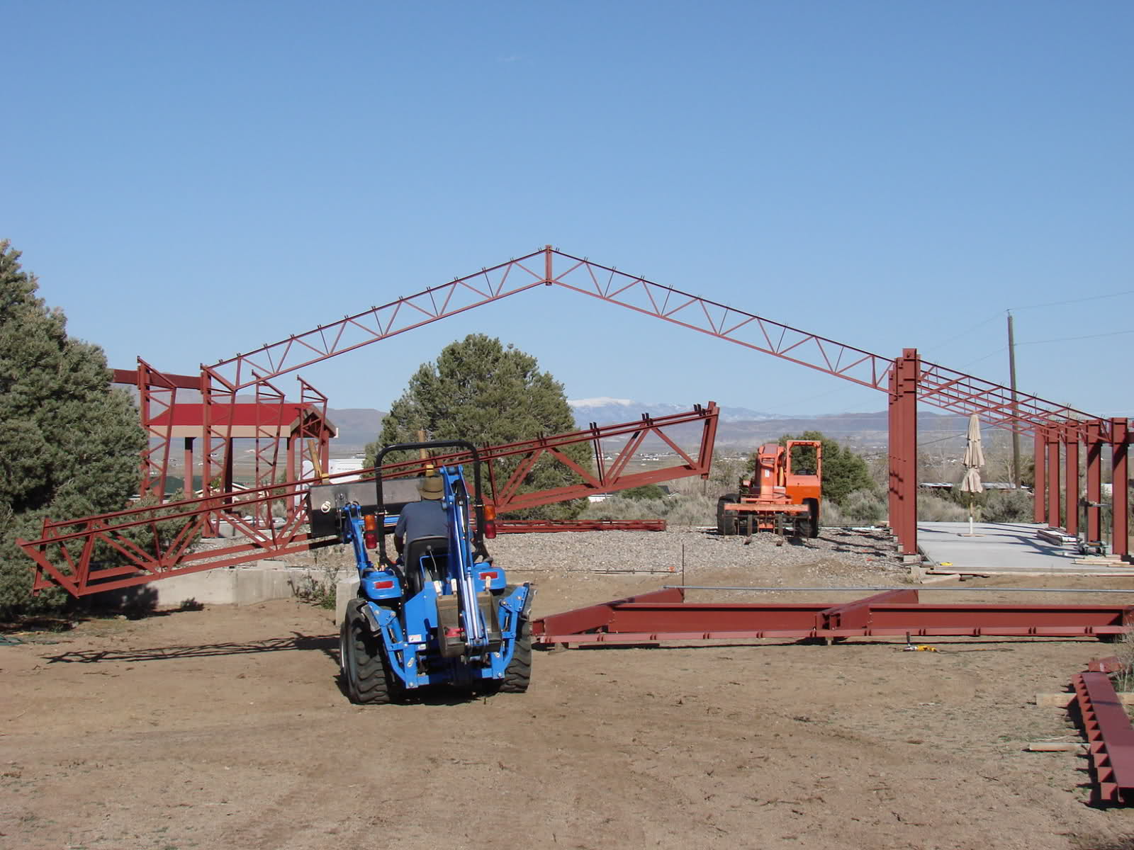

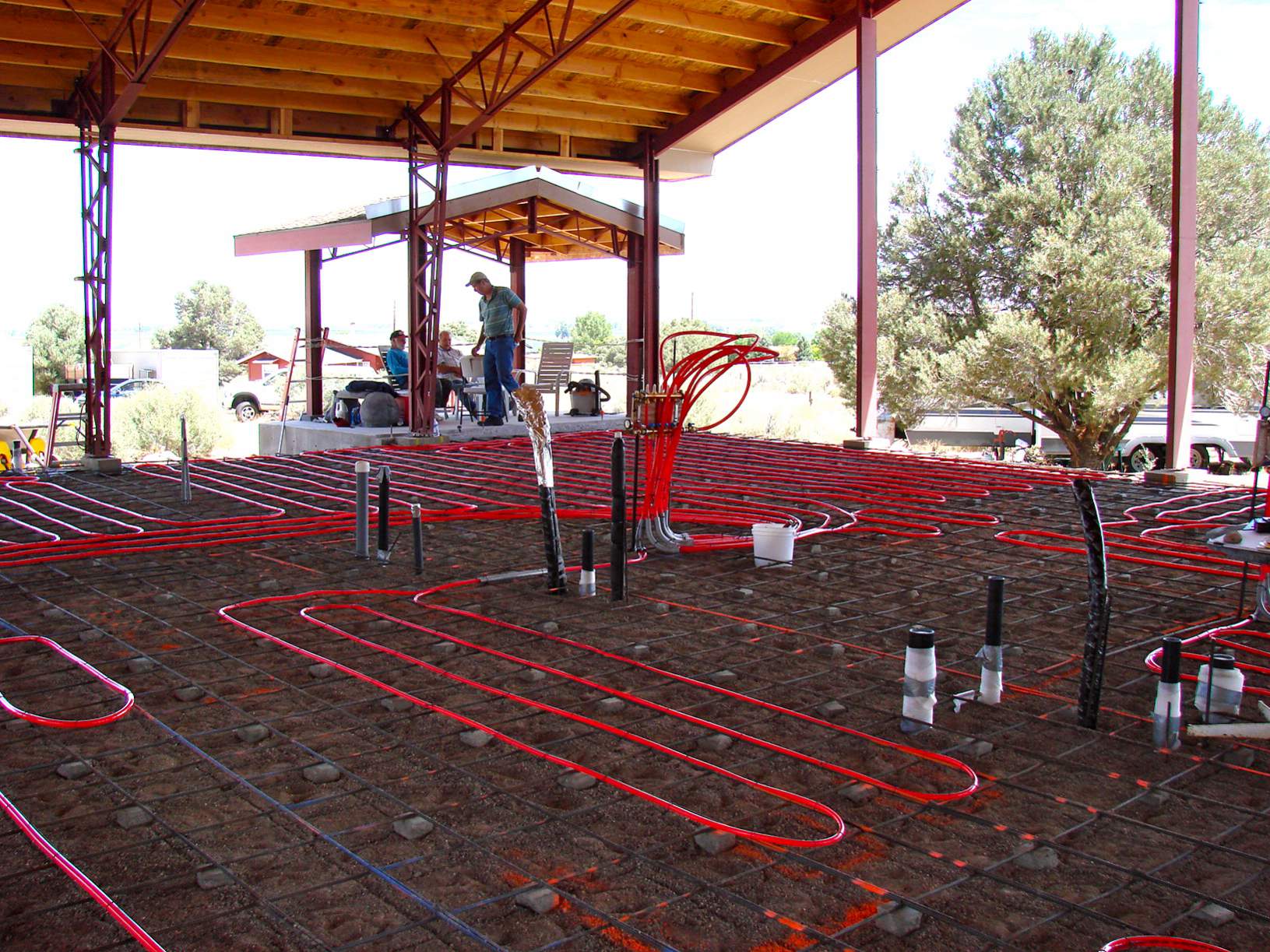

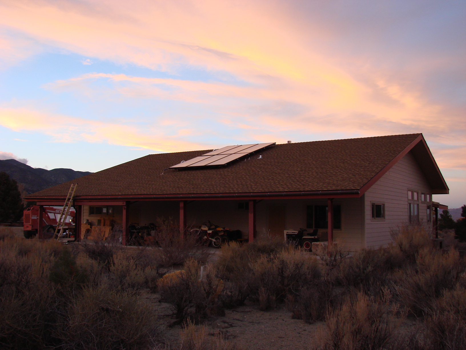

Aaron,
I did a similar thing and am almost done.
A 48 X 60 steel frame building wit a 12' extended overhang for a 60 X 60 area. Plus an added 12 X 12 building added to the front and turned 90 degrees to make a front porch. It's framed out as a two bedroom, 2 1/2 bath home with a loft upstairs.

Very nice bilding there Raspy! I wish I had that much room. I would love to build a larger structure but I just don't have the space. Congrats on yours. Looks great and a heated slab! I suppose that's pretty necessary in Nevada.
