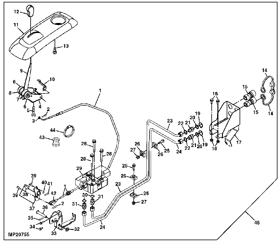

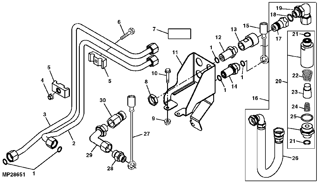

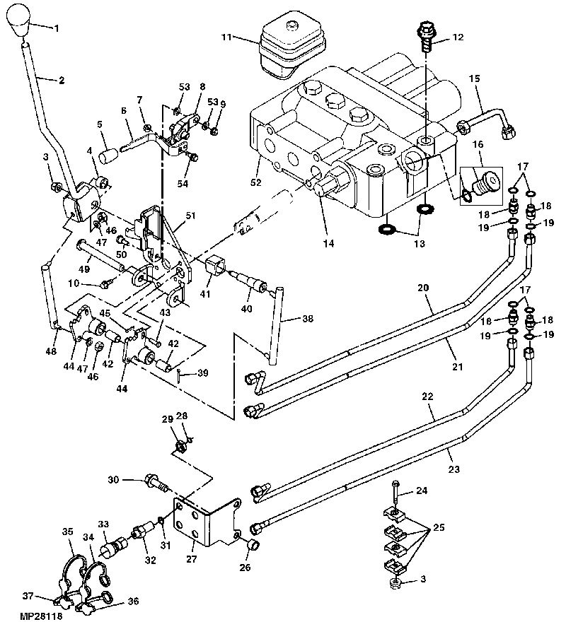

My understanding is that the 4600 has a 3rd SCV kit available as well as a 4th/5th SCV kit available. You would use the 3rd SCV for your grapple control. You would use the 4th and 5th SCV for your TnT. You could swap them around as desired. The three control levers would be installed on your right fender in front of the cup holder. The middle lever would control the 3rd SCV and the levers on either side would control your 4th and 5th SCV. You could switch hoses around as needed. For instance, you may want the left lever to control the grapple and the middle/right levers to control the TnT.
The Power Beyond Kit would be used for your log splitter.

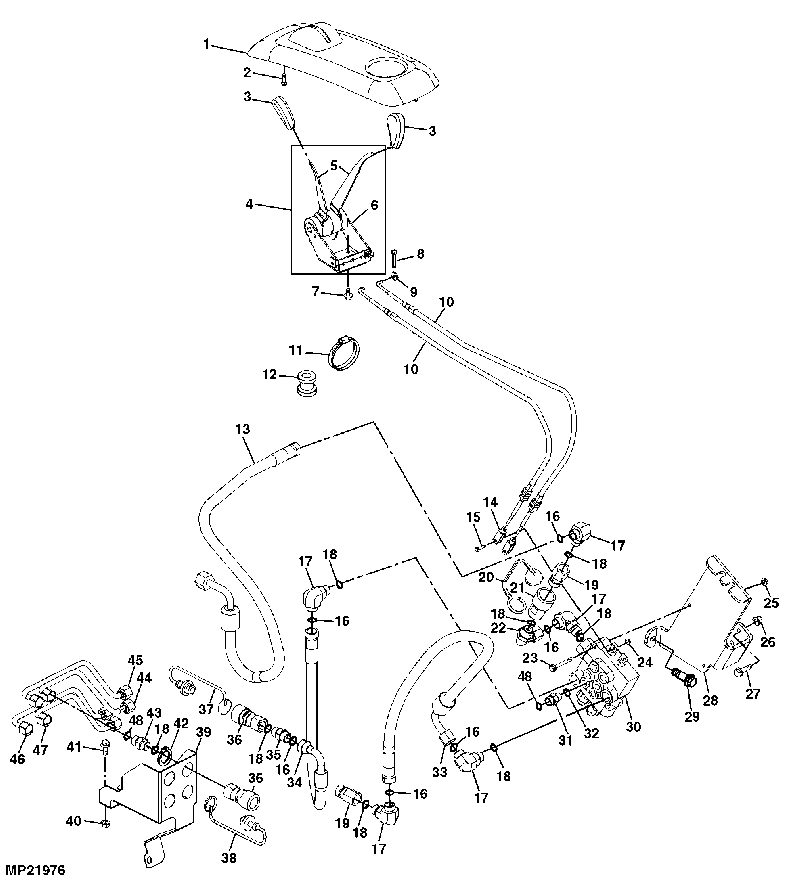

Thanks for the info. I've haven't been able to find any pictures yet but I'm starting to understand this a little better. Does the power beyond circuit have a control valve like a SCV or is it just a couple of ports that quick disconnects attach to? Do you know if the power beyond lines connect to the plugged output/input on the FEL valve or are those plugs for a 3rd SCV?
   / seeking hydraulic advise #5

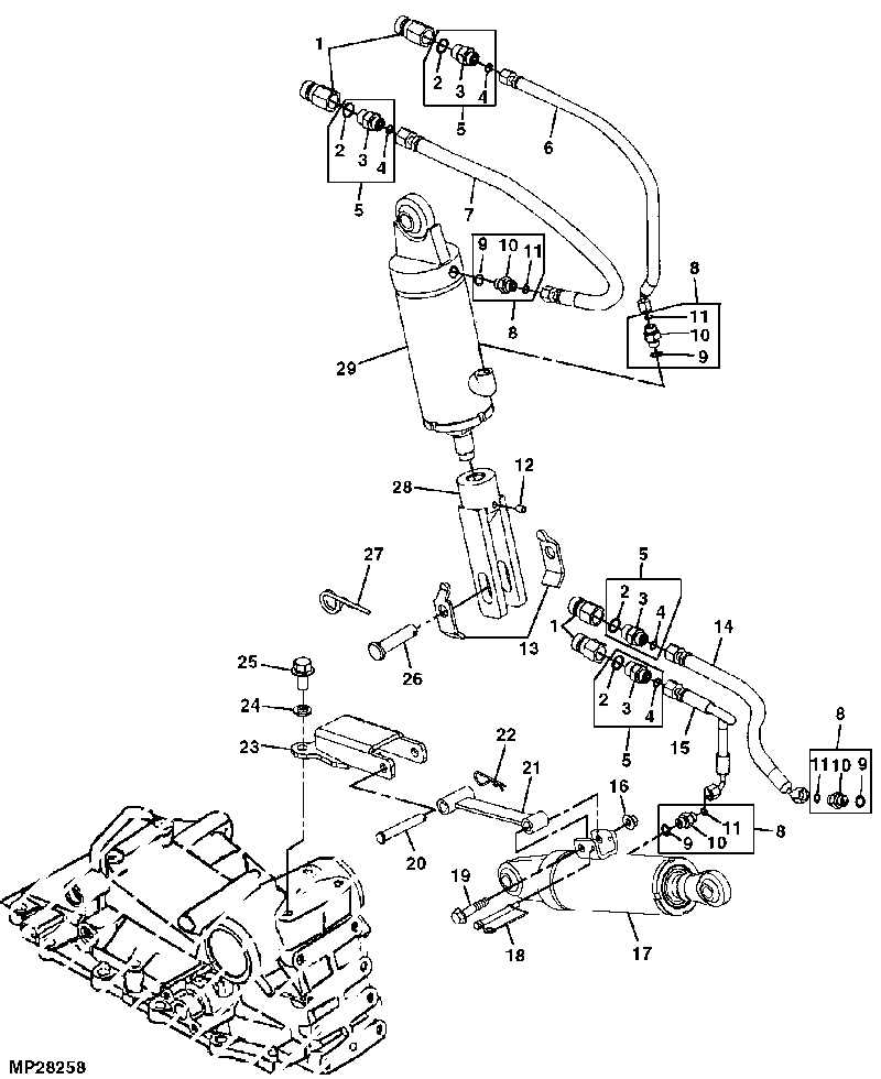

Here are some pictures of the kits we are talking about. I hope this helps. You can see the associated part numbers for these pictures when you look it up in the JD Parts Catalog Online.
I don't have the Power Beyond option on mine. Someone else could probably better answer your PB question. I don't believe it uses a control valve.

Neophyte had some excellant answers. I'll add some, probably repeat, hopefully not muddy things up!
Your tractor came with 3 hydraulic valves if it came with a loader. 1 & 2 are connected to your loader. 3 is capped off. and the lever isn't hooked up. To add the 3rd, JD has a kit that includes the plumbing and lever.
4th and 5th are accessed using a diverter. A solenoid switches the 1 and 2 ports to become 4 and 5. So when the divertor is actuated, the loader does not function.
Power beyond is a direct out, without any valve. The 3 point is disabled while it is in use. It is designed for a backhoe or logsplitter or post friver. The device will have its own valve(s) and the return dumps directly into the sump resevoir.
A Fasse valve is a diverter that the actuator is located on the Joystick. Deere puts theri control on the console between the fender and seat. For Top and Tilt, either is fine.
