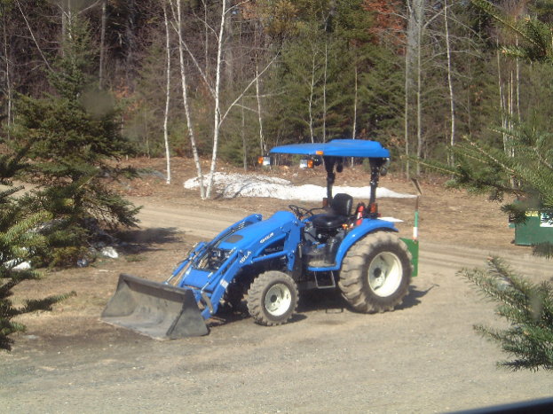

I have the TC35D. I love it !! /forums/images/graemlins/grin.gif photo attached /forums/images/graemlins/grin.gif
Sometimes I think that a smaller size would have been better, but then I climb into the seat of the 35D and instanly remember / realize that I made the right choice.
I Don't have super steer for I don't EVER expect to be operating in the tight quartes where it would be benaficial..
If I ever buy a finish mower it will be a 3PT mount with rear discharge. Considering the above reason, I also did not get the mid PTO option.
I DO, HIGHLY reccomend the Quick - Tach system. It opens up a whole new world of front attachments. Stick with the 16LA loader, you won't be sorry.
At least 1 set of rear remotes is an option WELL Worth getting.
I think loaded rear tires are pretty much a must.
A canopy is a darn nice option, for resonable $$. I spent better then an hour yesterday in a mild drizzel, grooming my driveway with the rake, and stayed nice and dry. There is a company in Canada that makes a beautiful full glass cab for reasonable $$. Maybe in a few years once I pay my loan down, I'll get one. For now the $400 canopy works awesome.
A canopy also opens up the easability of installing auxiliary lights and mirrors.
I presently don't have the need of a toothbar and therefore of course don't have one, So I am of no help there.
Good luck with your decision, I know you will be happy with whichever one you choose.
