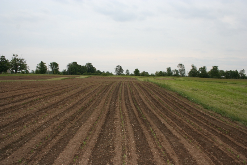

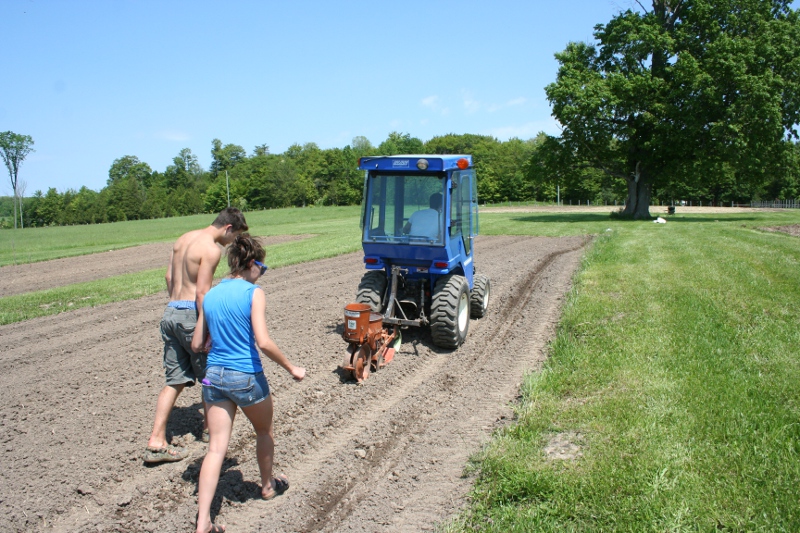

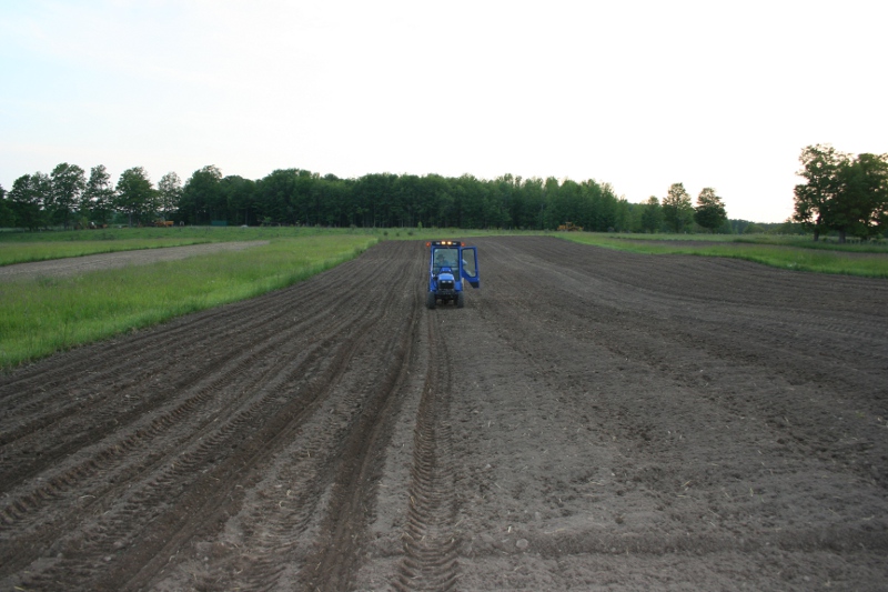

I have both 1-row and 2-row planters which I use to plant between 3 and 4 acres of sweet corn, beans and pumpkins. For pumpkins I use my Cole 12MX single row planter because I like the way it plants hills instead of single seeds. I use 1 row because the wide row spacing, between 8 and 12 feet depending on variety being planted.
I use both my JD 71 and Cole 12MX to plant sweet corn. I have found little benefit to using my 2-row because I stagger my sweet corn planting only planting 6-12 rows at a time. With the Cole12MX I can plant and fertilize at the same time, saving both time while using less fertlizer. Unless you add a side dresser to the JD 71 you would either have to broadcast your fertilizer using much more than if you side dressed it.
My kids prefer the Cole 12MX because they find it easier to set up. All the older Cole 12MX planters (like mine) were made in the USA. The new green painted ones are also made in the USA and the Blue painted ones are made in China. Parts are interchangeable.
I also have a Webb precision planter for planting small seed. It is a fantastic planter but I rarely use it. Instead I tend to use my push Precision Planter for small seeded veggies.
