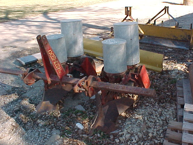

To plant corn this is what I used, a 2 row dempster planter. I built a new 1 row so this one is going to the auction this month.

Well I will try to get the pic on
