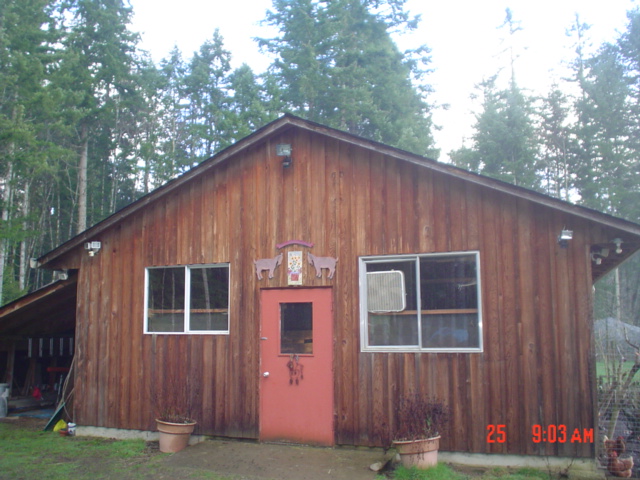

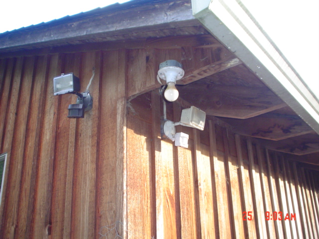

Thought I would add to my earlier post by taking a few pics of what we have on our barn.
These halogen lights all have preset timers built in: 1 minute, 5 minutes and 10 minutes so that way they only go on for a limited time when it sees something. Barn has been up about 9 years and have not had to change many bulbs in that time period. The one at the peak is a 500 watt with the white double 100 watt on the left side. The 2 on the right side are 250 watt. You seem to just need it for seeing the door lock at night so one smaller one will be fine. Just need to put the motion sensor so it sees you as you are going to the door. Our use is more for security and peace of mind when we go out at night to the barn due to the larger animals such as bear and cougar in our area. Have found these motion activated lights will pickup small animals as well such as raccoons.
