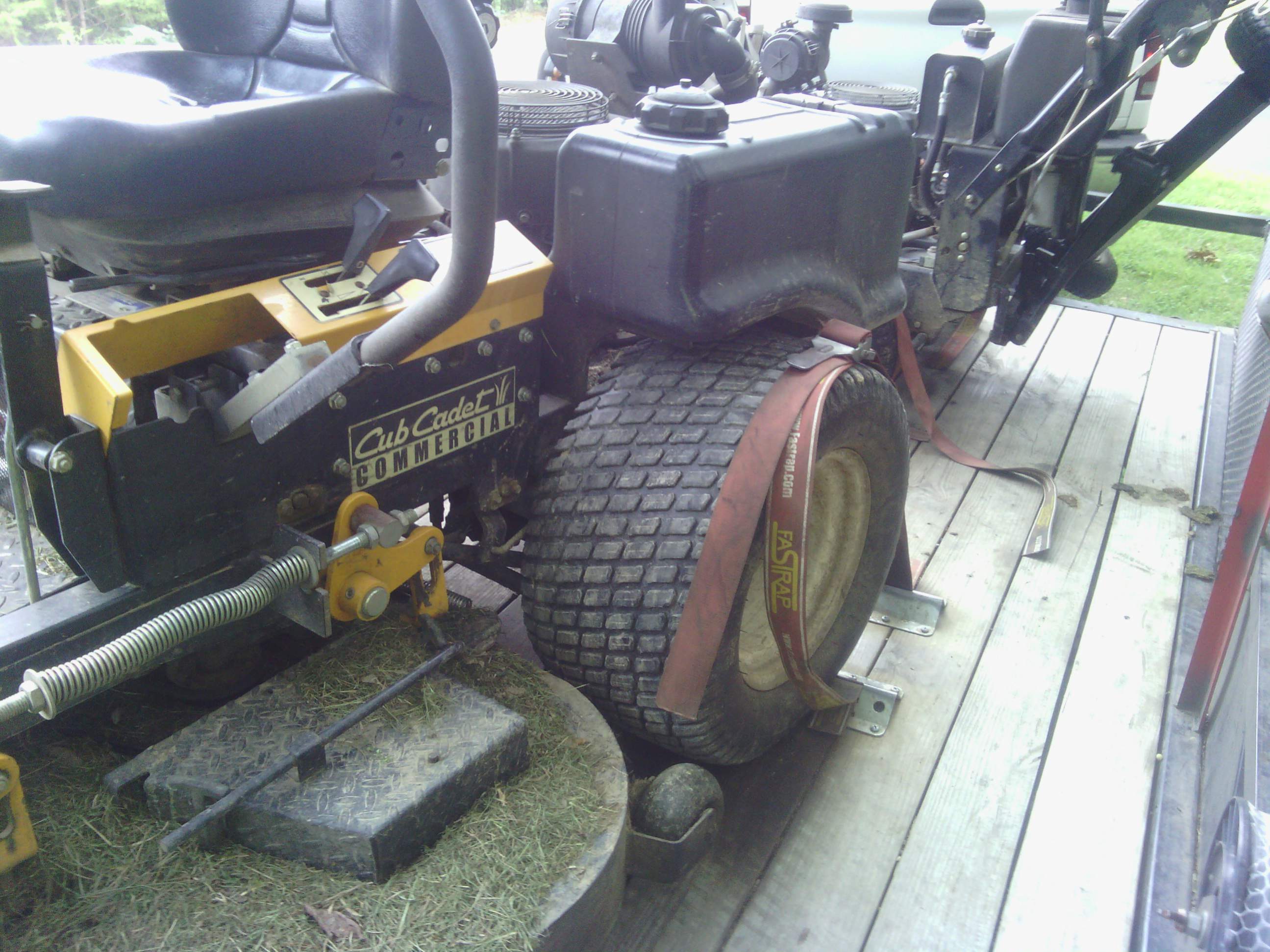

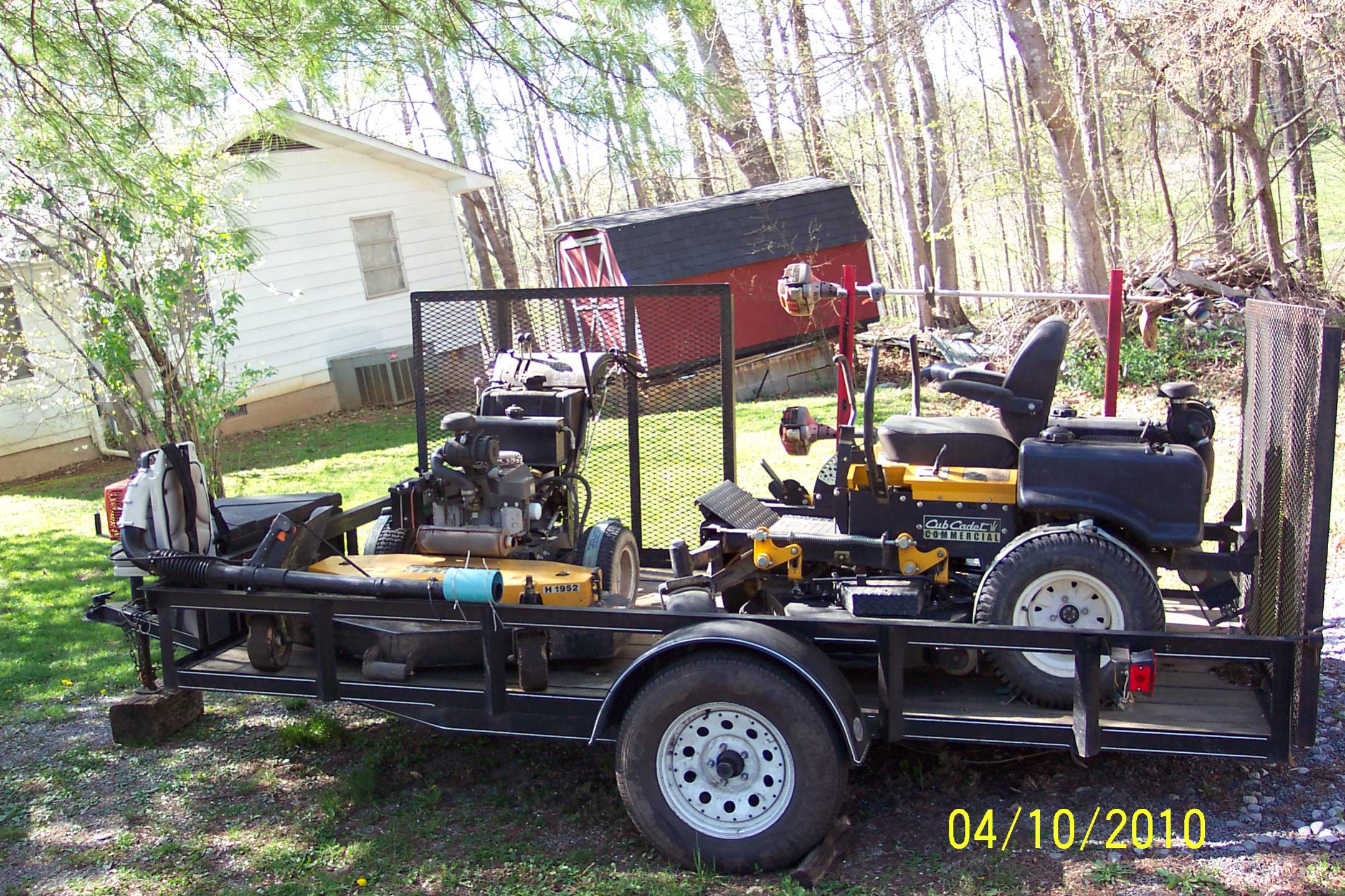

Here is what I have used for several years.
The green straps that secure both the walk behind and the zero turn are called Fastraps. I have used them for years and the green straps were pretty awesome. A couple of years ago an employee was pulling the trailer with those two mowers on it. He got too far too close to the edge of the road and the passenger side tire dropped off the edge of the road and hit a driveway connection and destroyed the trailer.
The straps did their job and kept both mowers secure and in place. The mowers were not hurt.

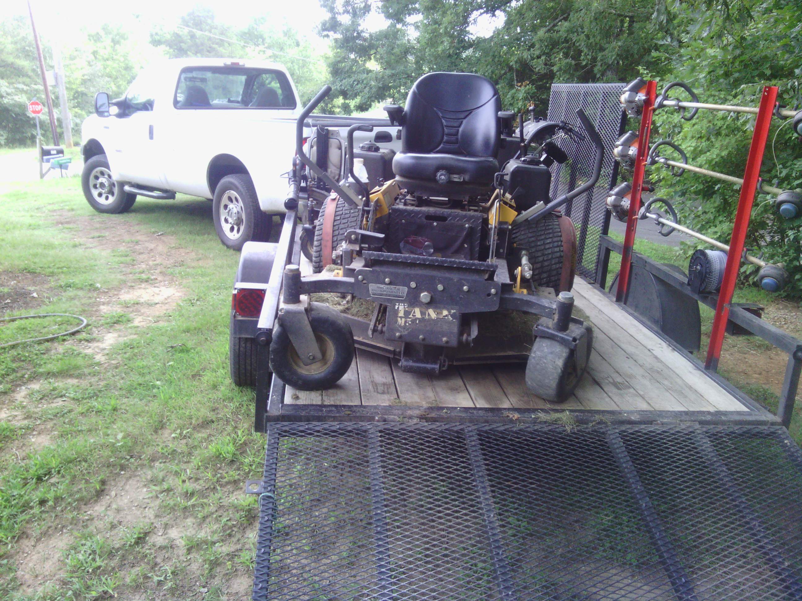

I bought a new trailer and two new sets of fastraps. The new fastraps are now red and I am not nearly as pleased with them. The straps themselves are slicker and will loosen up easily, especially if they get wet.
The straps loosen up if they get wet or I hit a bump then the mower is able to turn sideways on the trailer. I am not all that pleased with the new red fastraps. The next straps I buy I will probably try a set from Rack'em.
