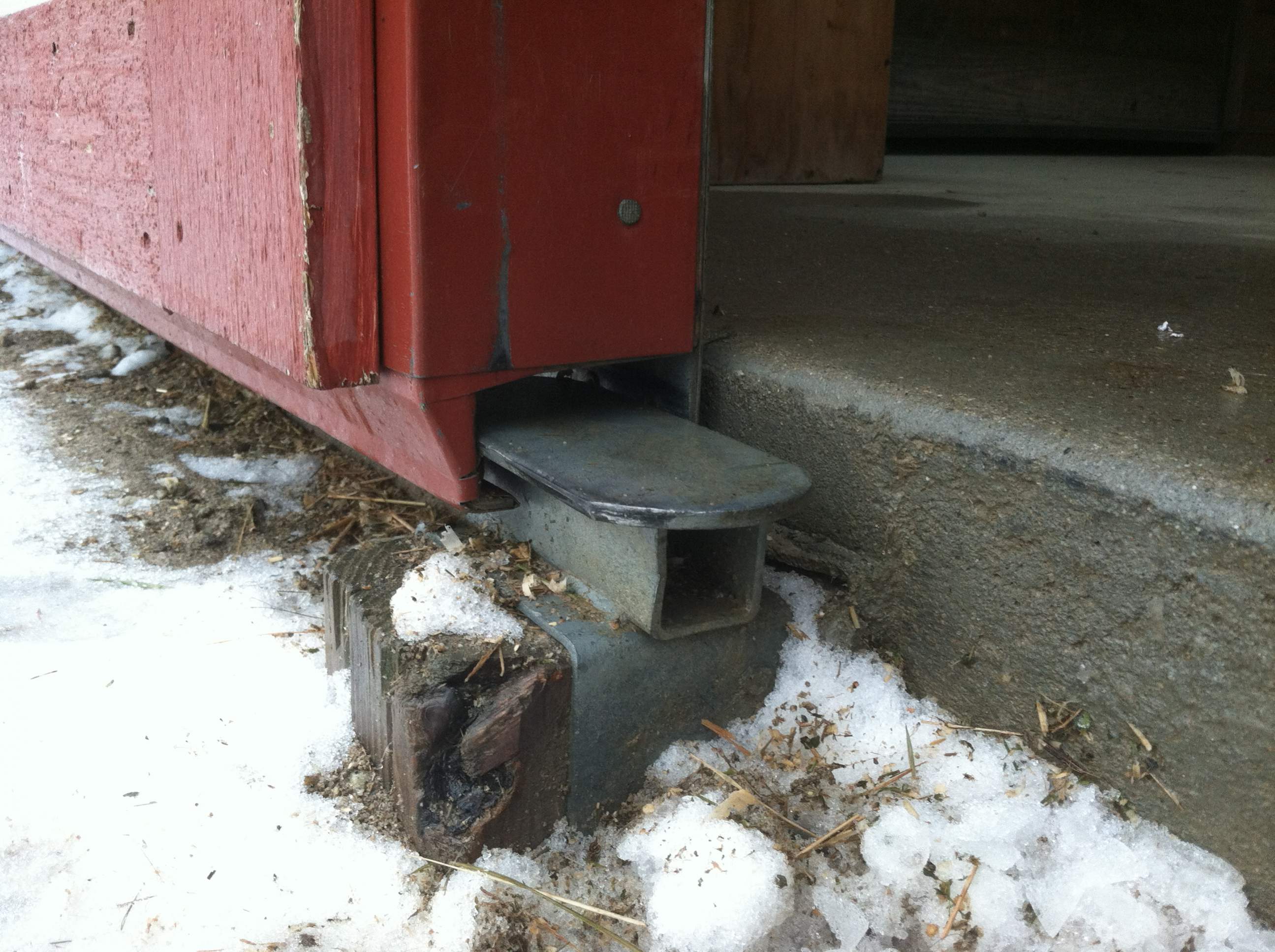

My barn was built by Morton and this is what they used for my sliding doors. It's held up fine to hurricane force winds and they are big heavy doors with a lot of glass in them.
The doors are kept latched together by using two barn door handles which are hollow tubular steel attached to each door. A piece of bent round bar is then used to keep them together.
The doors are kept pulled tight to the barn by a swinging latch on each side of the doors.
The doors are also kept from blowing out by heavy winds by a T shaped piece of steel in the ground which slides into a channel in the bottom of each door.
The latches can be found at Tractor Supply Co. The handles can be found at most hardware stores and the bent bar can be easily made. As for the channel under the doors and the T shaped plate, I haven't specifically looked anywhere for them, but I would think TSC would have them also.
