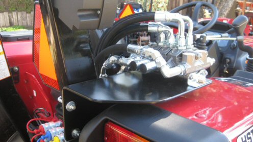

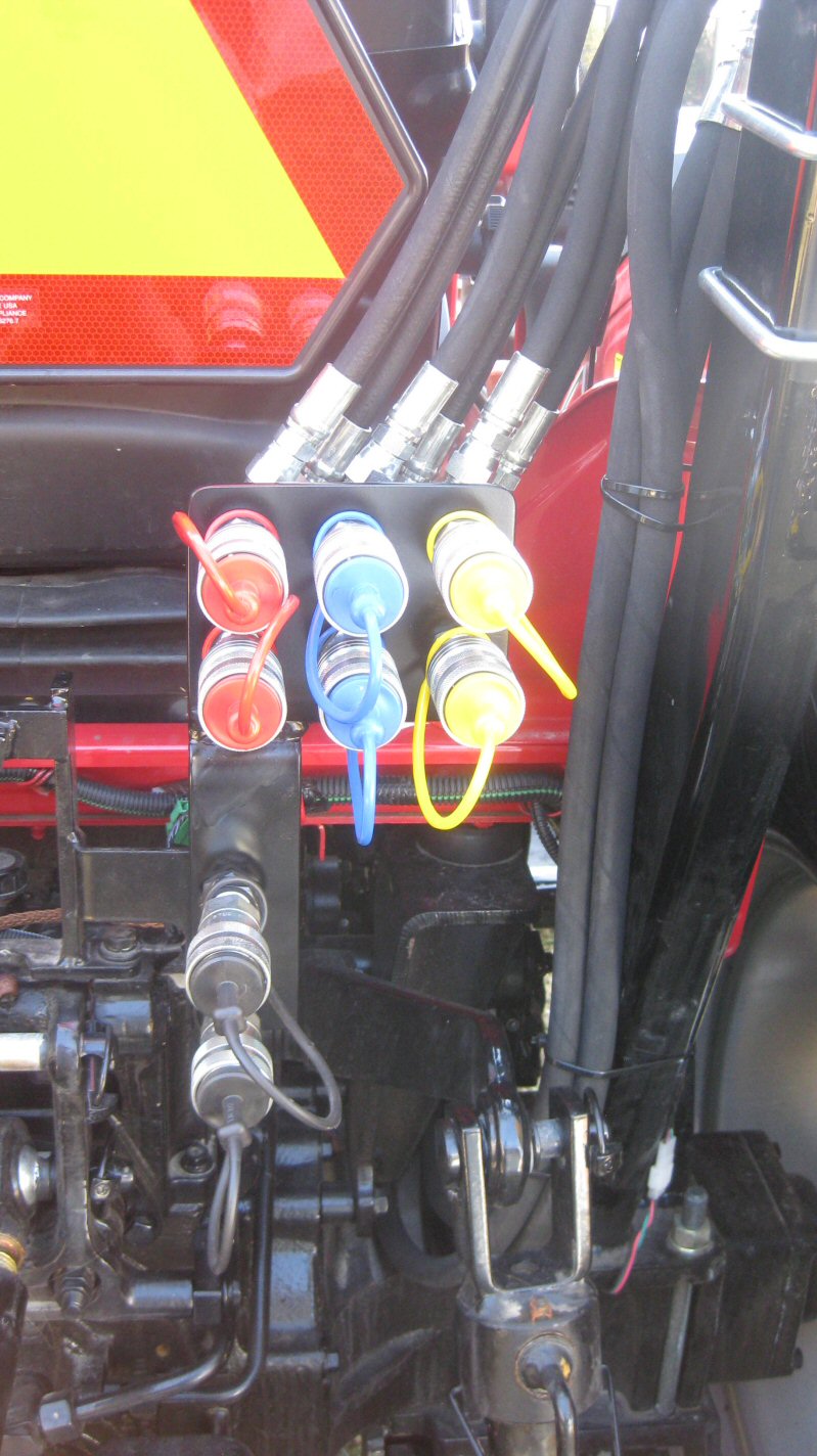

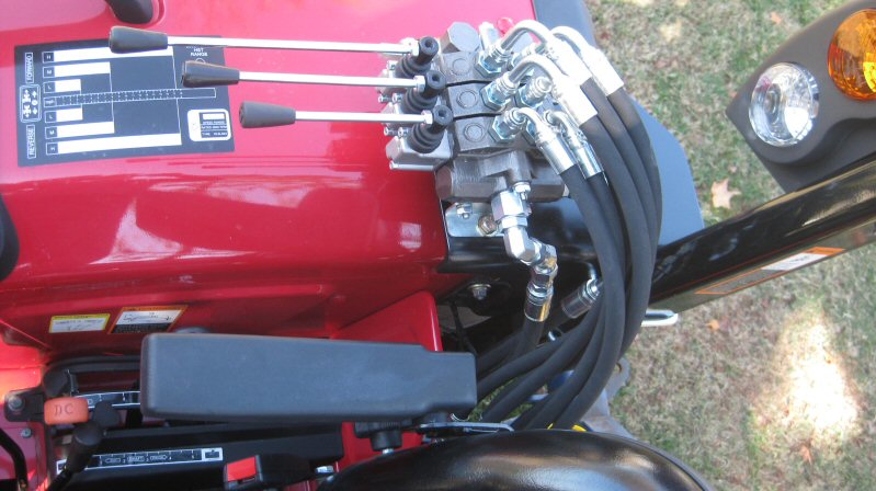

How about 3 additional sets for a total of 4 sets for $1475? :cool:

Its a lot of parts and even more labor. We are usually around $1500 + Ft
You can also do like mtnview if you got the know how... if something does fail in the hydraulic system because of it... your warranty wont hold but done right and mainly used right it can be done
I had a customer once with a Kubota Mx series and one of my systems. This guy was a pro and knew what he was doing. Burned up the pump 3 times. Kubota tried blaming it on the system the 2nd & 3rd time. Turned out that there is a flaw in the Kubota hydraulic design inside their system of that model. It won't handle full RPM flow with constant use day in and day out without burning up the pump. Something about the oil passages being small and cooking the oil. :eek:
Anyway, everything that I had provided flowed more than enough for them to end up taking responsibility.
Like was mentioned, as long as it is done properly, no issues.
You never run an open center system with valves that are to small, just a problem waiting to happen. Not if, but when is the question.
Good luck to the OP with his search and end decision. :thumbsup:

Id like to see the brand names and set ups and how they are plumbed between the two
