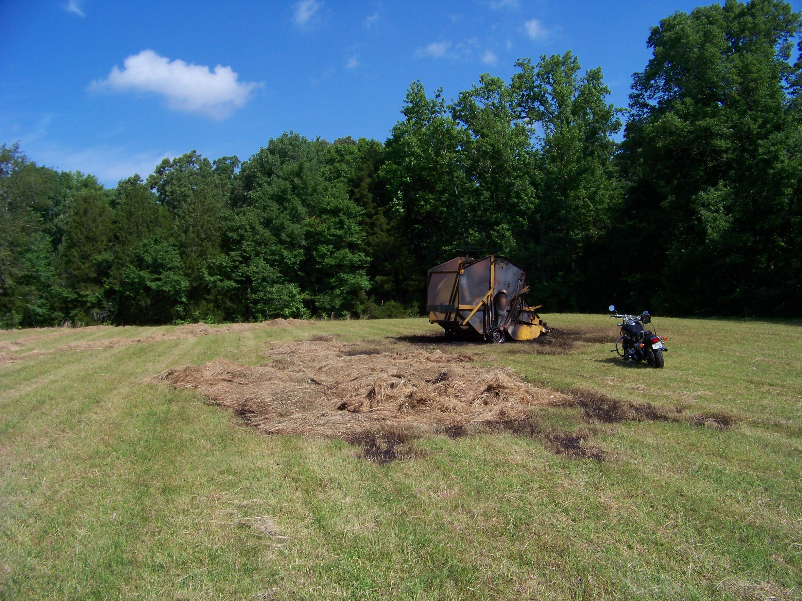

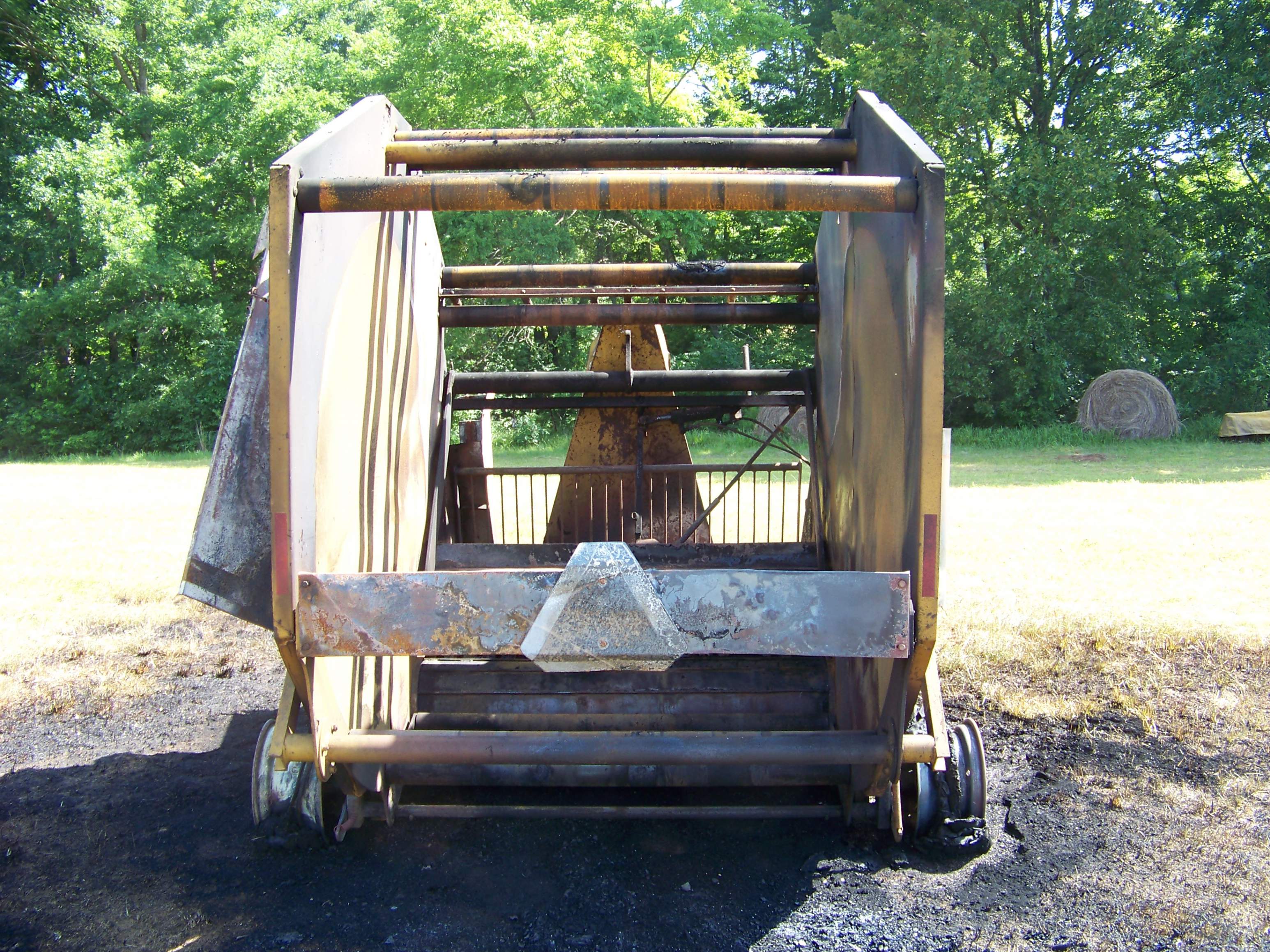

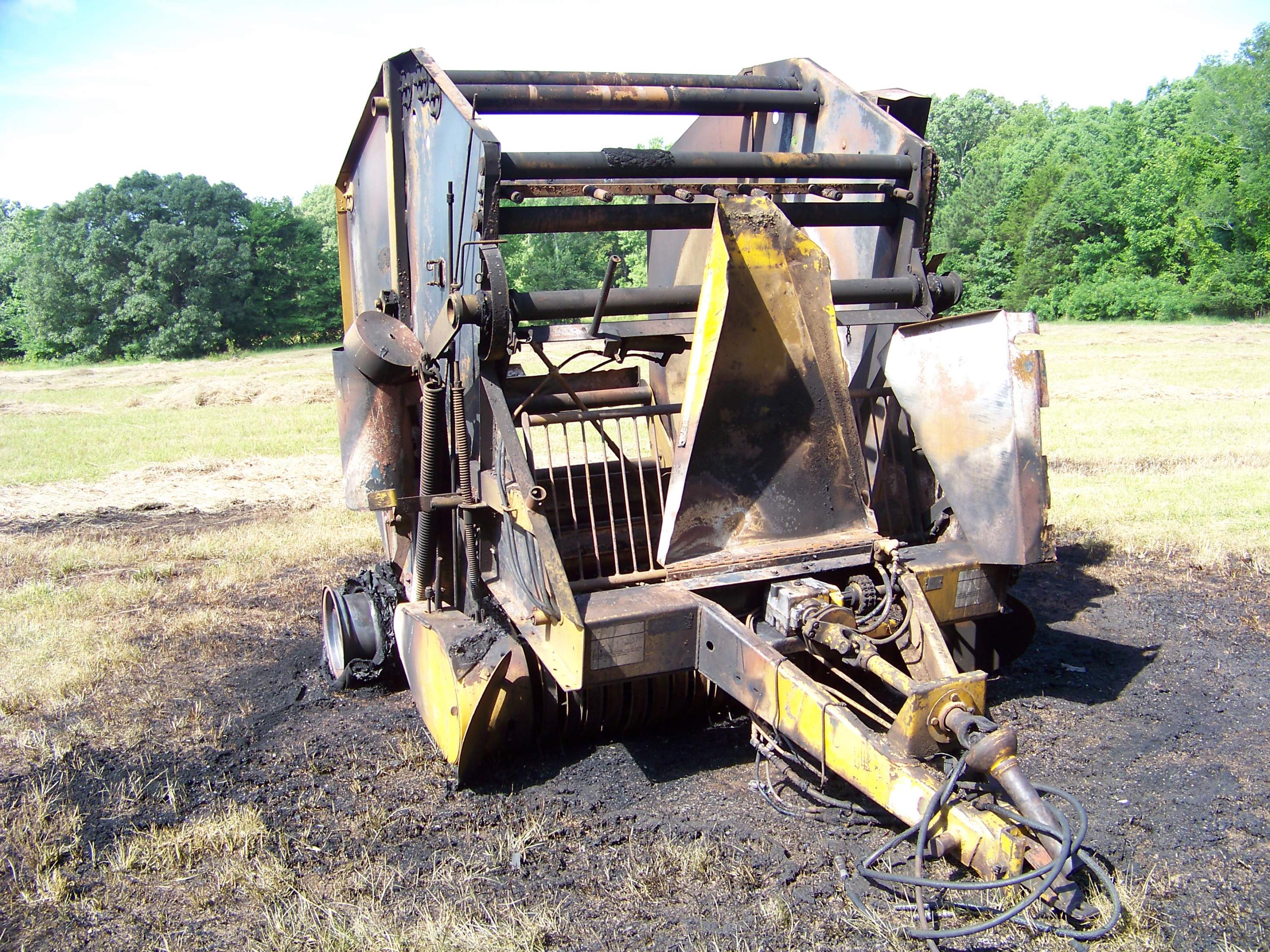

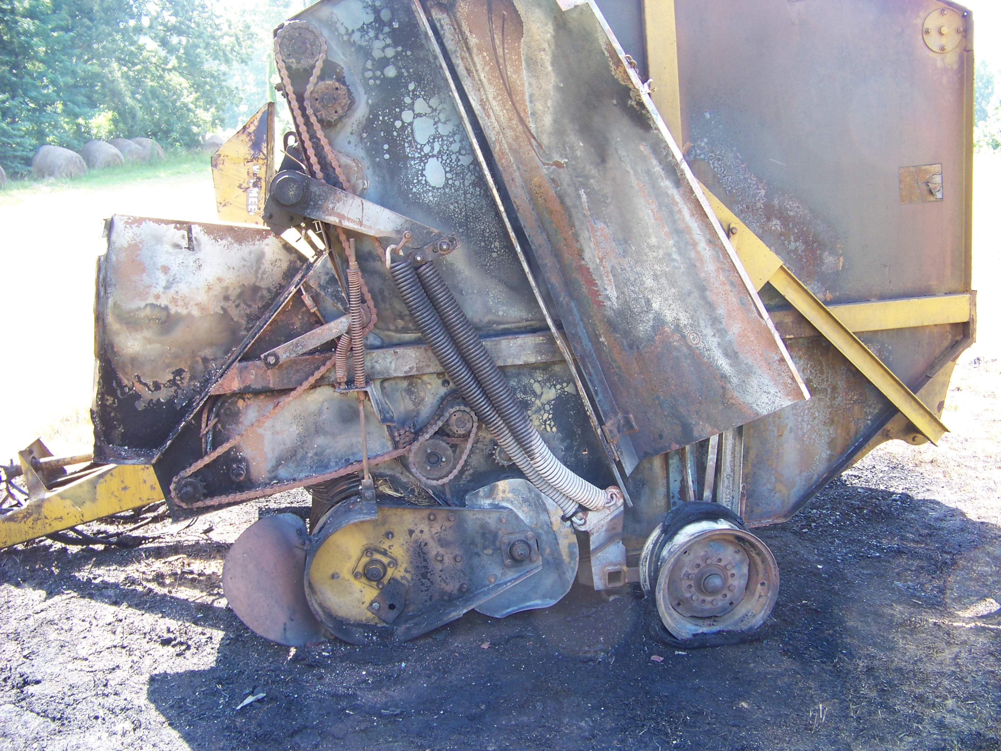

This is the second baler I have to burn on me in two years. Fortunately I didn't own either one of them nor was I operating them at the time the caught on fire so I'm not on the hook, but still it is pretty odd for such a thing to happen two haying seasons in a row. Not for sure exactly what happened to cause it to catch fire, thinking one of the drive chains broke and caused something to heat up. Luckily we got the tractor unhitched in time, the field didn't catch on fire, and most importantly nobody got hurt. It still amazes me that an empty hay baler can turn into an inferno with flames shooting up twenty feet high within less than 3 minutes. And yes, we did have to call the fire department to come and put everything out. Next haying season my spray rig is going to be converted into a makeshift firefighting rig and someone will be on standby in case anything happens.
Pictures of the carnage:

The baler belonged to a friend. We work together getting each others hay up. I usually do the cutting and raking as my Kubota is easier on fuel, he does the baling part. The baler itself had seen much better days... it was a 1986 model Vermeer 504G with a lot of wear and tear. We had been having trouble with one of the drive chains wanting to jump off earlier in the day and noticed that the baler didn't seem to want to "spin up" as easily as it normally does. Kinda hard to tell when your running it off a 1086.
That's the thing with round balers that I don't like. You can have a bearing go down and not know it until you see smoke. By then it's too late.

sounds like that baler blew a bearing when it caught on fire.but old or new balers you hate to see a baler fire.your right bad bearings are sometimes hard to find on a baler.weve got a heat gun to check for hot bearing on a baler.
   / Second baler fire I've had in two years. #5
3 very important things to have when rd baling are water fire extinguisher with "fire out" installed in it,laser thermometer to check brgs and insurance. One thing in common about rd balers is they all have the capability of catching on fire no matter what the brand(color). Local custom baler burn't 4 balers in 2 yrs. As previously stated common fire cause is a faulty brg.
