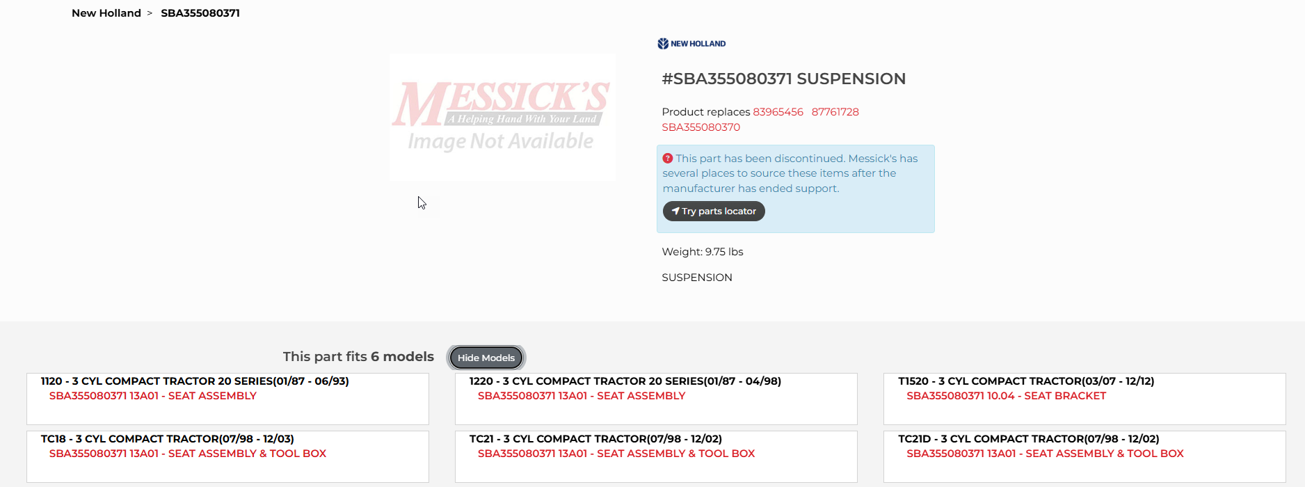

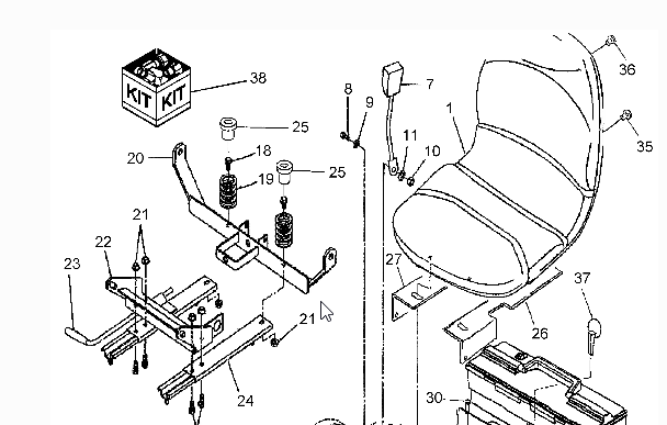

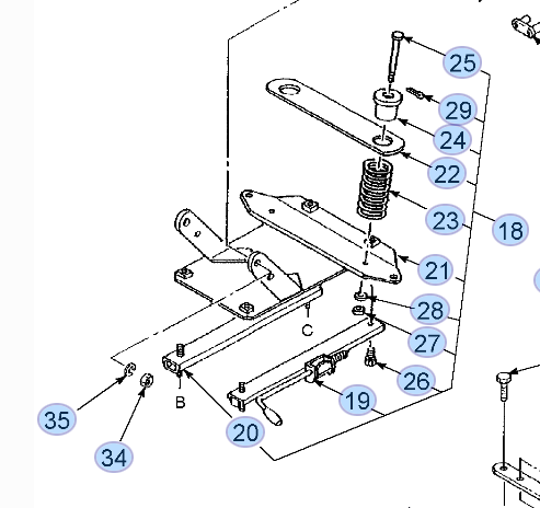

Not according to the NH parts diagrams. They look to be different. The TC18 brackets are discontinued.
Here is the TC18 diagram and the models the TC18 brackets fit.
Here is the TZ18DA diagram.
