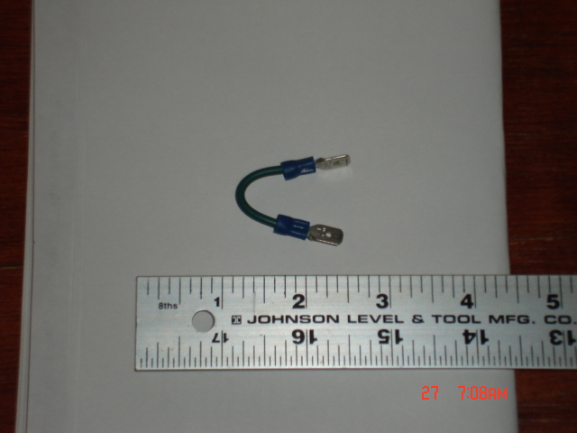

Those of us with MF SCUTs have to deal with this often when the weather's cold- seat gets too stiff to flex enough to trip our switches, so we use a jumper. Here's the one I made:

Thanks guys, but I'm not sure how it gets connected. Any pics of how/where to connect the jumper?
   / Seat Switch #5
Haven't looked at mine, but they all usually just unplug, and on the tractor harness side, jump the pins in the connector, then your done.
   / Seat Switch #6
"they all usually just unplug, and on the tractor harness side, jump the pins in the connector, then your done"
Yep.

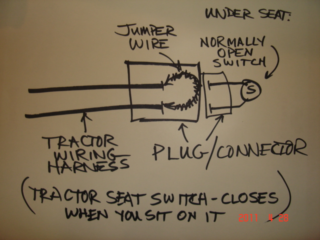

OK, I think I got it. The jumper that irvingj posted above would just connect into the tractor side harness and the other side does not plug into anything? I guess I was thinking the other side had to be plugged into something. All I really need is a jumper with one end?
roger4400-that was my other idea.
   / Seat Switch #10
Yup. Ignore the end of the wire going into the seat. The wire coming up from the frame - fashion a jumper to connect each contact. The wire going into the seat is simply an on/off switch. Place your big *** on the seat and it presses a switch so the electronics think, 'yup, someones big *** is on the seat so it's ok to run'.
I suppose it serves a purpose for some. Me, mowing with the yard tractor I have to continually get off to move a stick, a Frisbee, a dog toy... with the woods tractor you have to jump off for a minute to adjust a chain, move a stick, move a gas can, whatever. I like to think I'm cognizant enough to know when I can just jump off for a second or when I should shut the tractor down.
It's always been my first move on riding machines to jump the seat switch.
