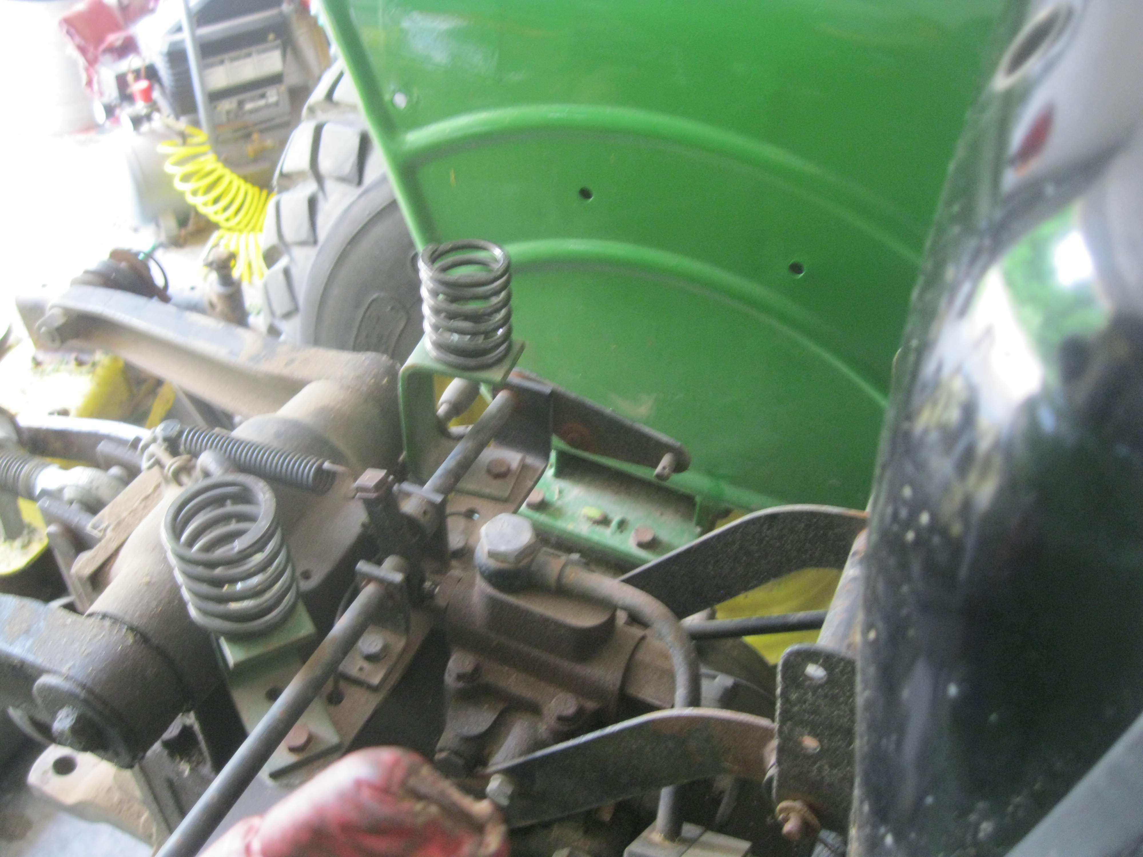

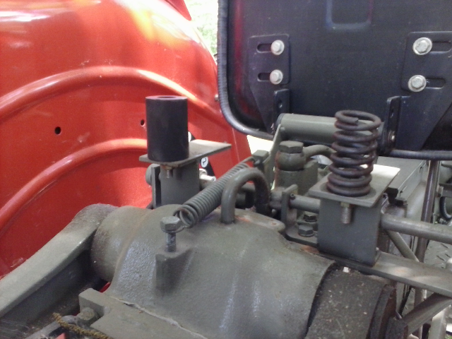

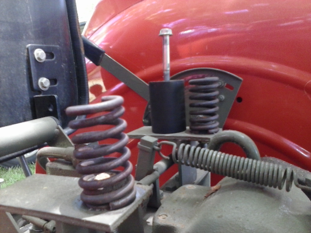

After hearing others have done this I decided to do it my self. After about 2 years of thinking about it and forgetting until a long weekend on the tractor I finally did it. When I was at the small engine store to get fuel lines for rotted ones on a blower thanks to ethonol I asked if he had any parts mowers. He said he had one and pointed after I told. Him what I wanted. It had the 2 seat springs on it. I think it was an Ltd of the 90 s vintage?? Anyway he pulled them an said $4. Not a super steal but cheaper than what I was seeing on eBay. Not having my own junk nor knowing anyone with any I thought it was fair.

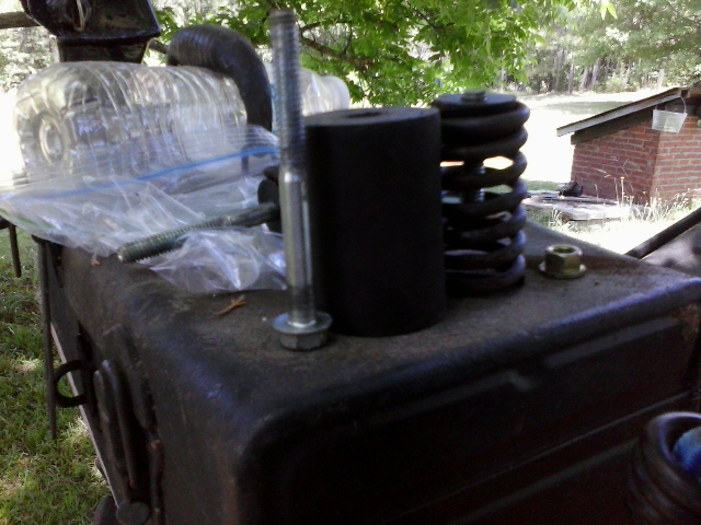

Anyway this is an easy 5 minute task that gives some relief to your back while in the seat. They were the same height but I need to add a few washers as spavers as the 3 point lever hits the seat bottom with me in it towards. The top of the arc due to compression of my weight. But the washers will fix it and I did not even notice till I was putting the tractor IP because I was bush hogging and don't lift it all the way anyway. Now for he pics.
One more thing I took the long bolt out that mounted them to the lawnmower and used the tractors original bolts.

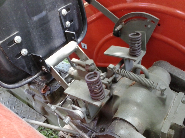

Picture 001.jpgYeap! my seat was a little to laid back also. The bottoms are springs then I used pvc. freeze plugs for extra lift. From the looks both of our Back Heights seem to be about the same. ;) Sure made it Alot more comfortable. Mine's been like this for 5Yrs. atleast.

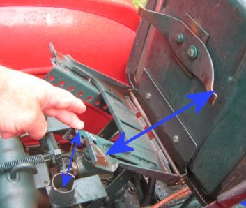

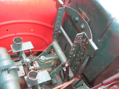

Oh! so that is the way its supposed to be,:confused: when I got my tractor the seat was in very poor condition, rusty and duct taped, there were no coil springs making the seat very uncomfortable, So I scored a nice high-back at the local salvage from a large lawn tractor, it had its own mount and spring system, which was nothing more than a arched pc kinda like a leave spring, so I fabricated it to fit the tractor, it sits relatively comfortable but after seeing the small coil spring I think I might can improve on the comfort by adding some coils into the cups;)
Good job and Thanks for sharing the photo,
here's one of my .... uh! ghetto-rig:D

I didn't respond earlier.....but what is all that braketry?? Is that the stuff from the. Mower seat?
Also it looks like u have metal pipe where my rubber was and now springs?
/ seat springs.
#12
What is all that braketry?? Is that part of the mower seat?
Also it looks like u have round metal pipe wherre I have the springs and what was rubber bushishings.
/ seat springs. #13

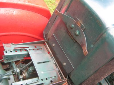

Not much to it really, what I did was to weld some punched angle iron to each side of the underside of the lawn tractor seat bracket, The holes provide the forward and backward adjustment and align with the tractors original seat mount, the angle iron then folds down and sets on and to inside of the two cups/pipes preventing the seat from shifting side to side, it looks more complicated then it actually is, It's only that now the seat has double action hing:D The arched spring is strong enough but yet flexible enough to absorb most the shock, We've all driven lawn tractors with seat suspensions like this , The high back seat itself is where the comfort is, I'm thinking by adding coil springs I may have to cut some of the pipe off to let the springs protrude 1 1/2 using the cup/pipe as the spring retainer, Perhaps then I could have double action shock absorbers,;)

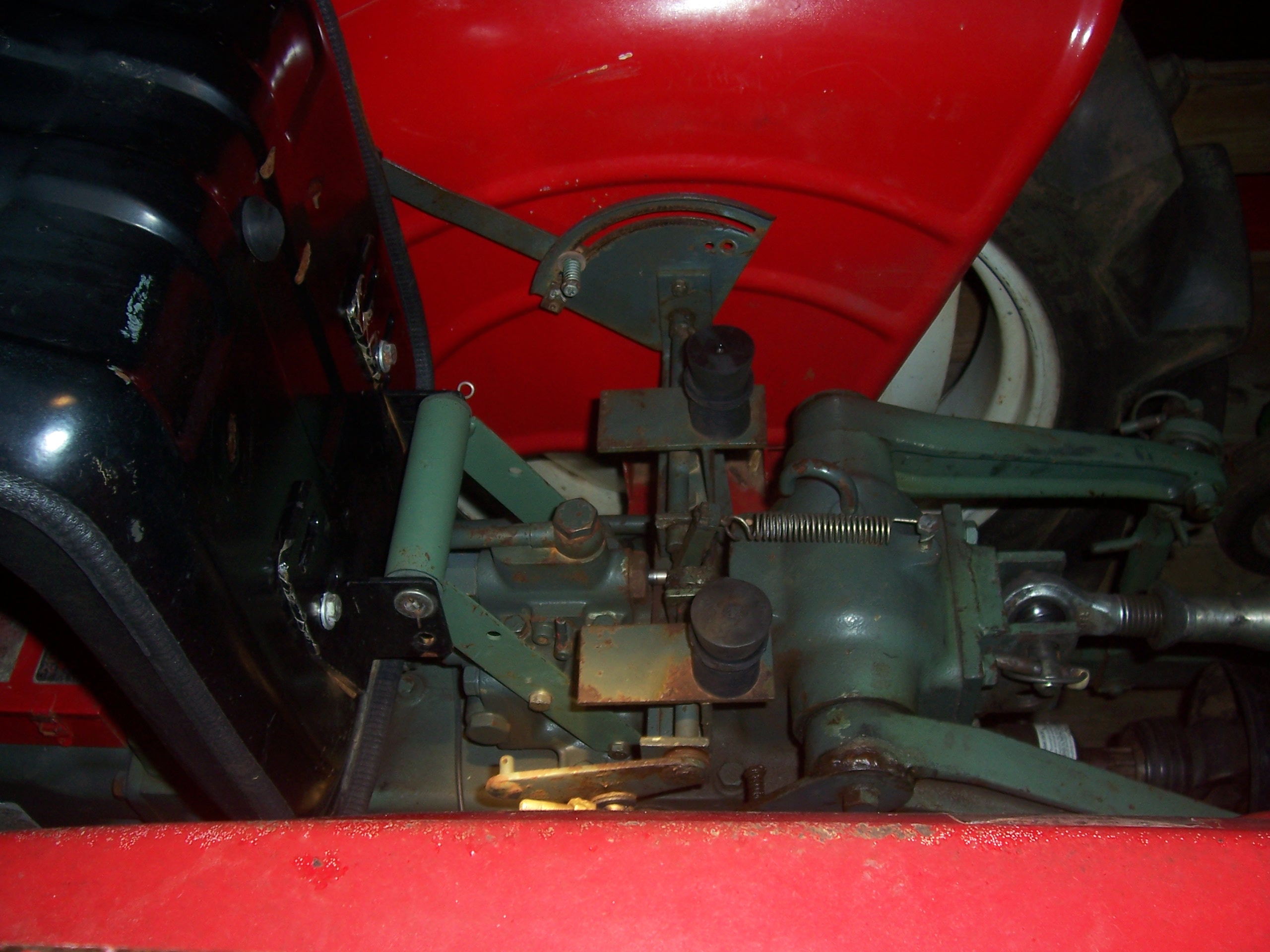

Mine has those stiff rubber bushing things that i showed in my pics. There is no metal "cups" nor have i seen any with them i think that is a rig job by a previous owner when the rubber deteriorated. And the rubber is proably slightly more forgiving than the pipe, but not much.
