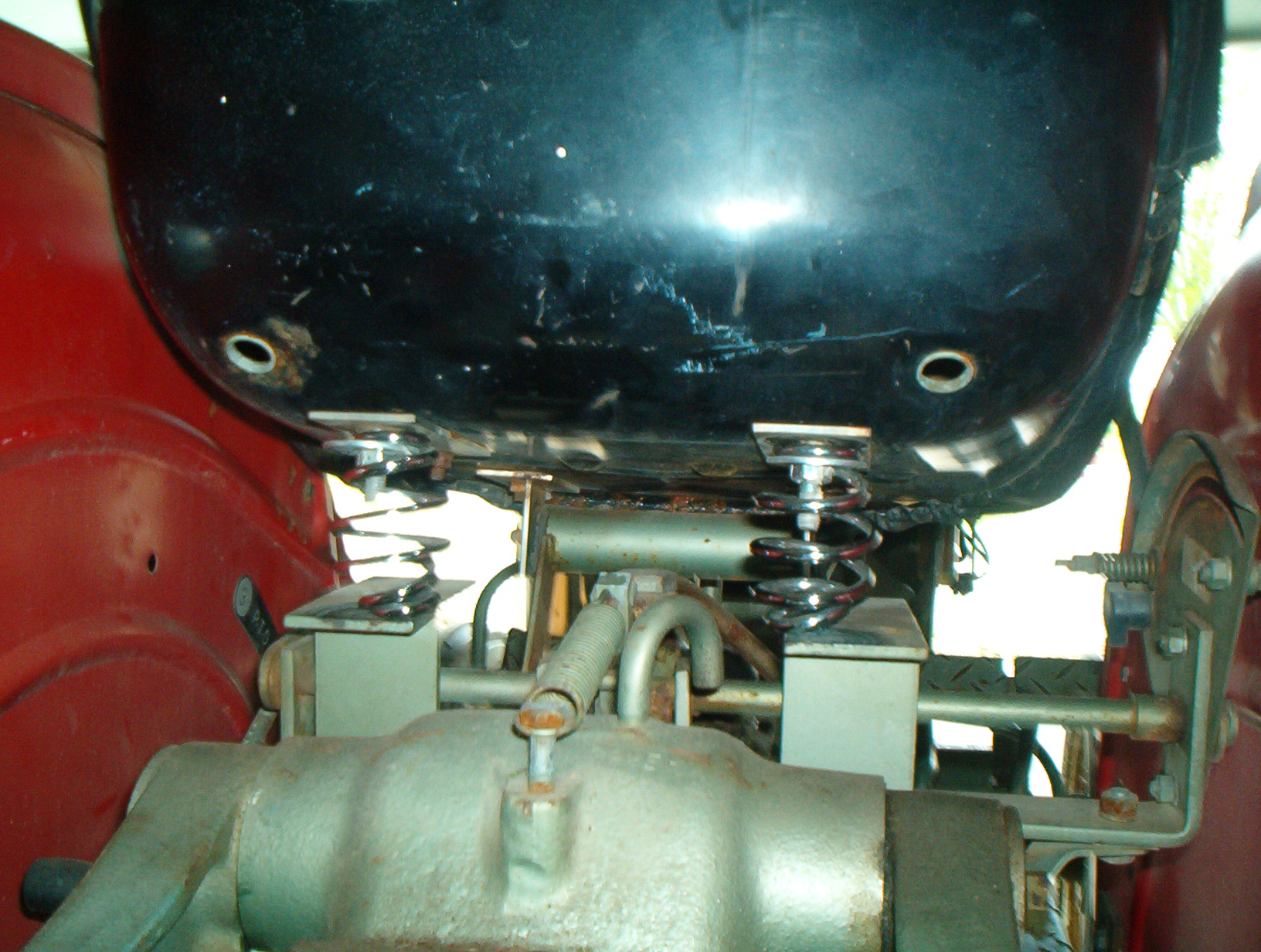

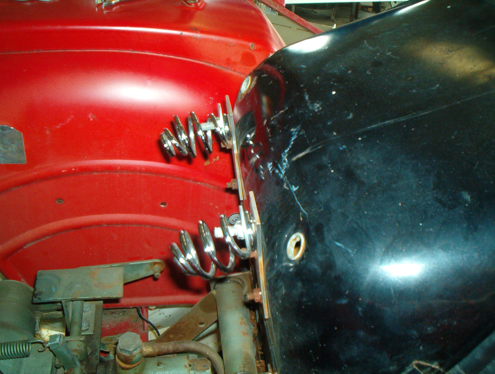

   / Seat Springs #8
got those motorcycle seat springs mounted to my seat this weekend here are some pics
