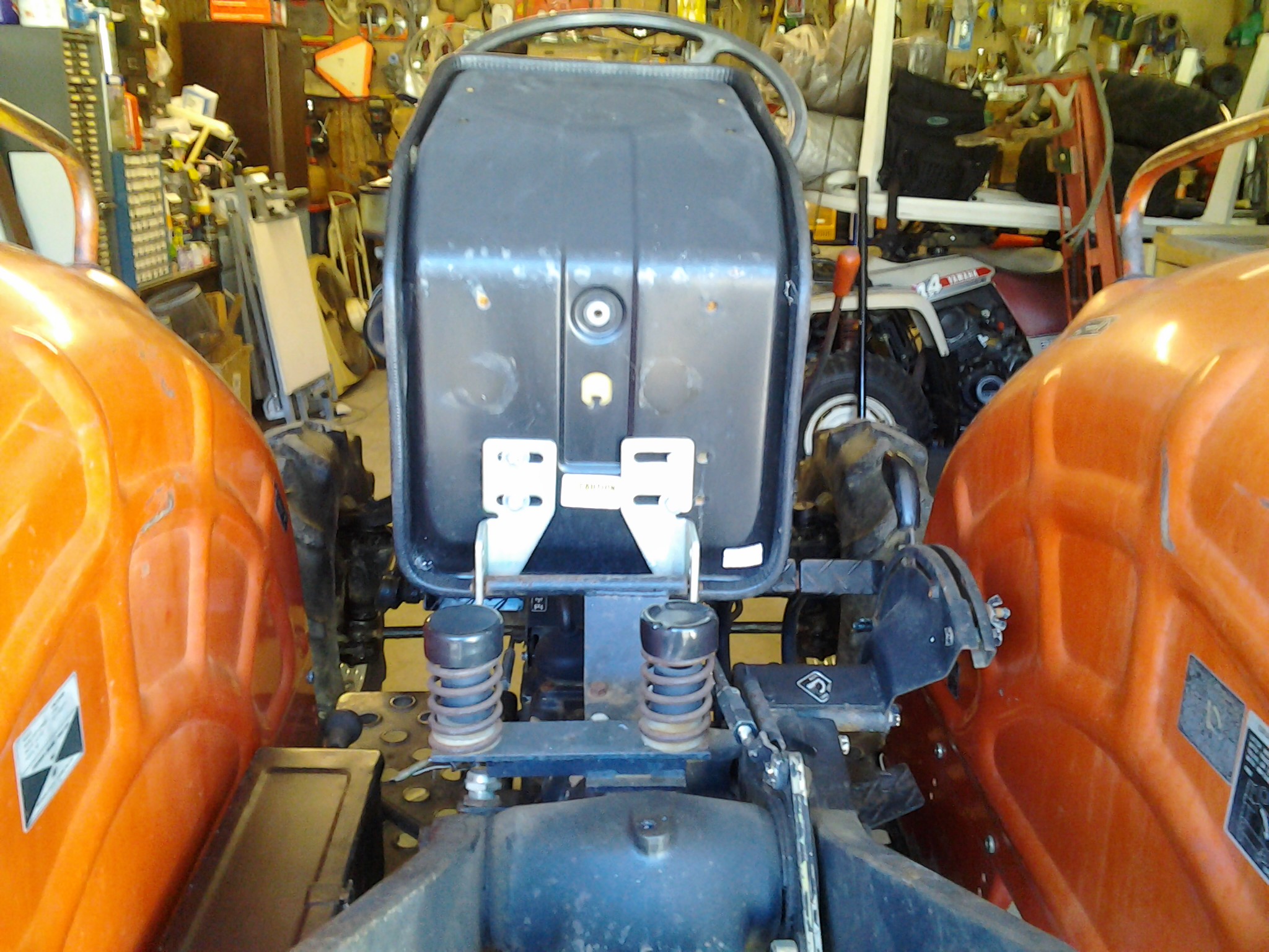

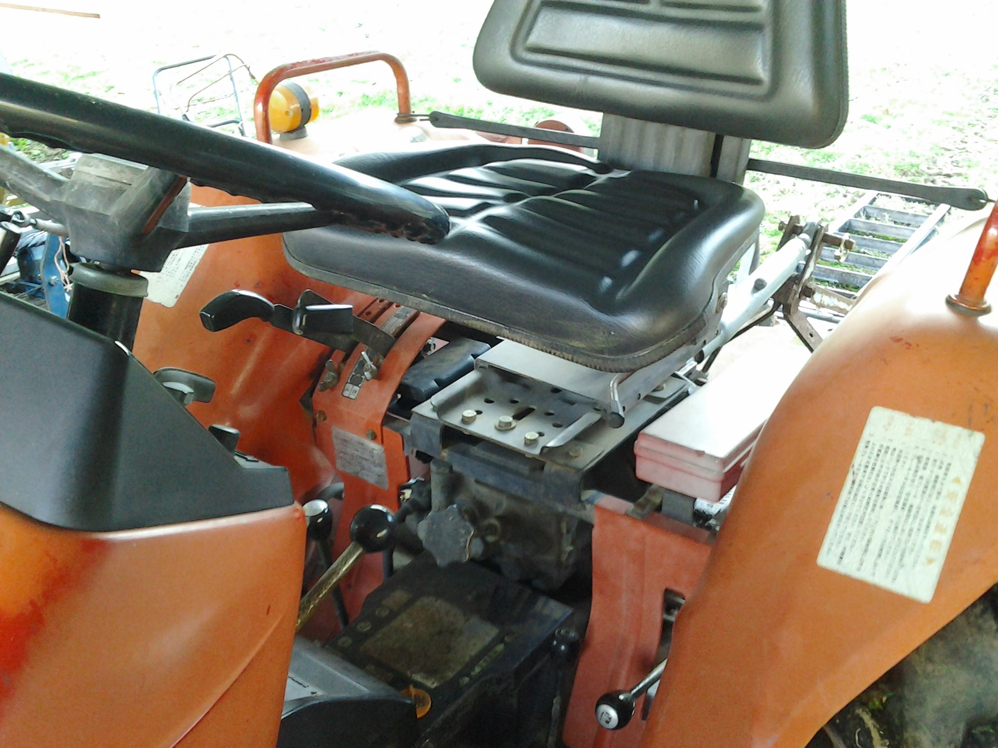

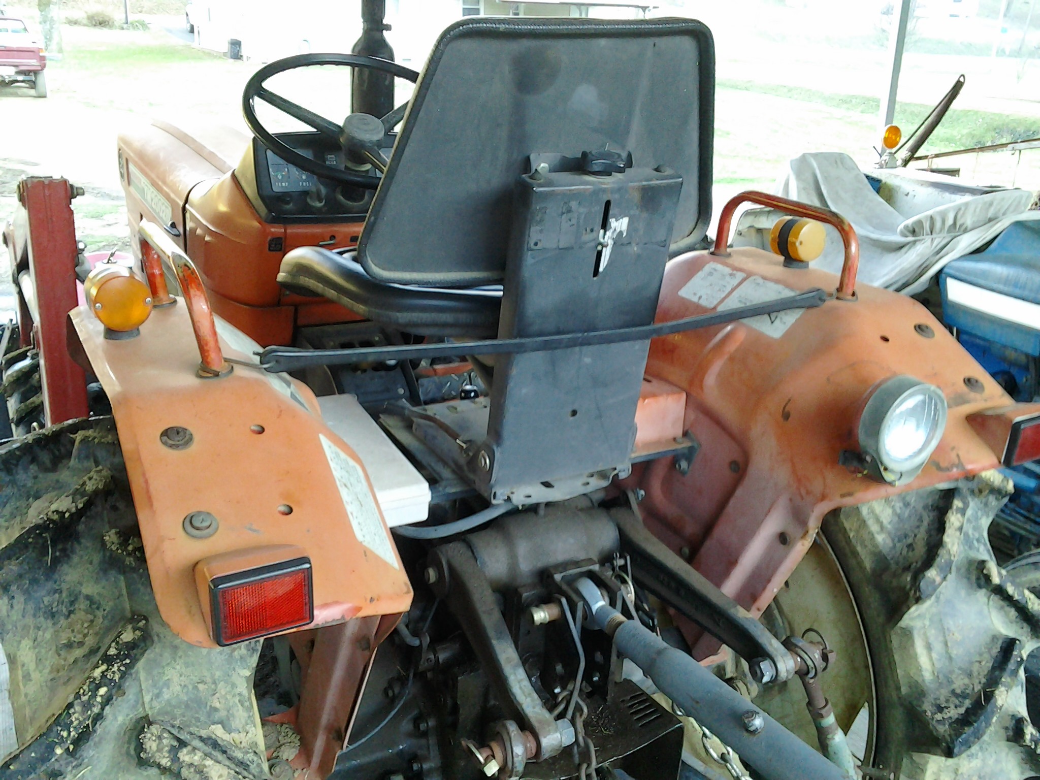

Anybody got an idea on a suspension seat for YM336D. Here's a picture of one I put on my YM2002D. I just can't come up with a plan for the 336? 035.jpg036.jpg037.jpg
   / Seat for YM336D #2
I use the stock seat.. Remove the rubber bumpers ,and installed springs from a riding mower... It works great !
   / Seat for YM336D

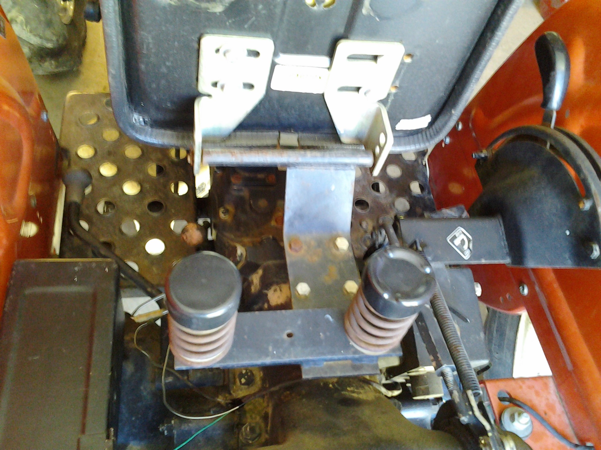

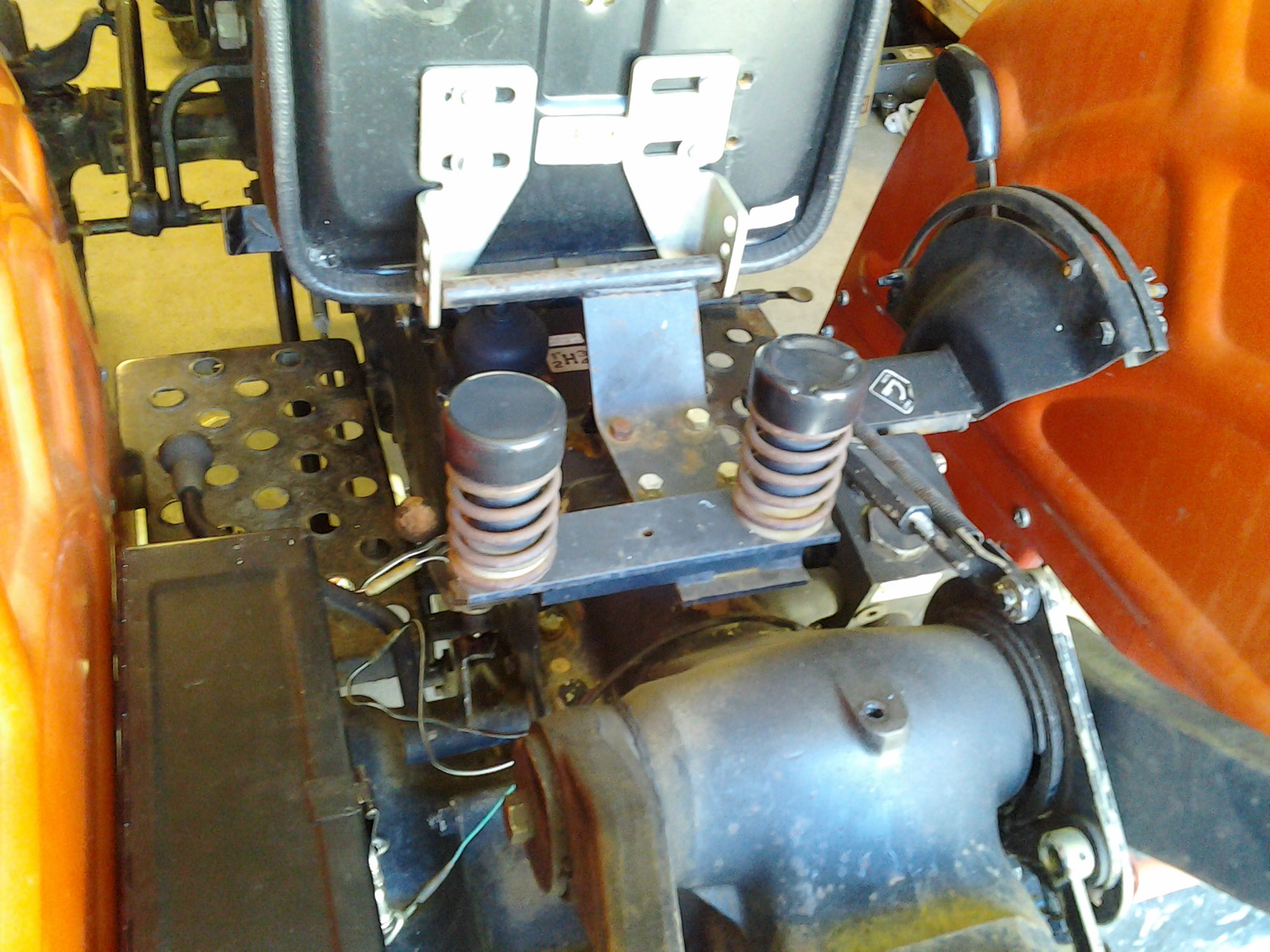

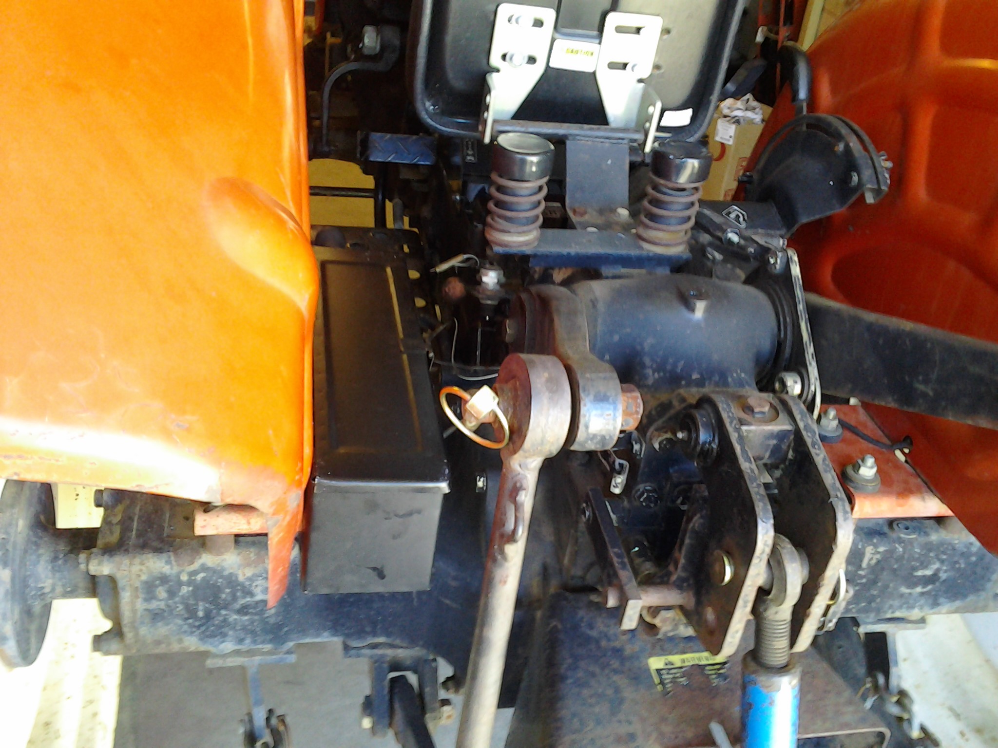

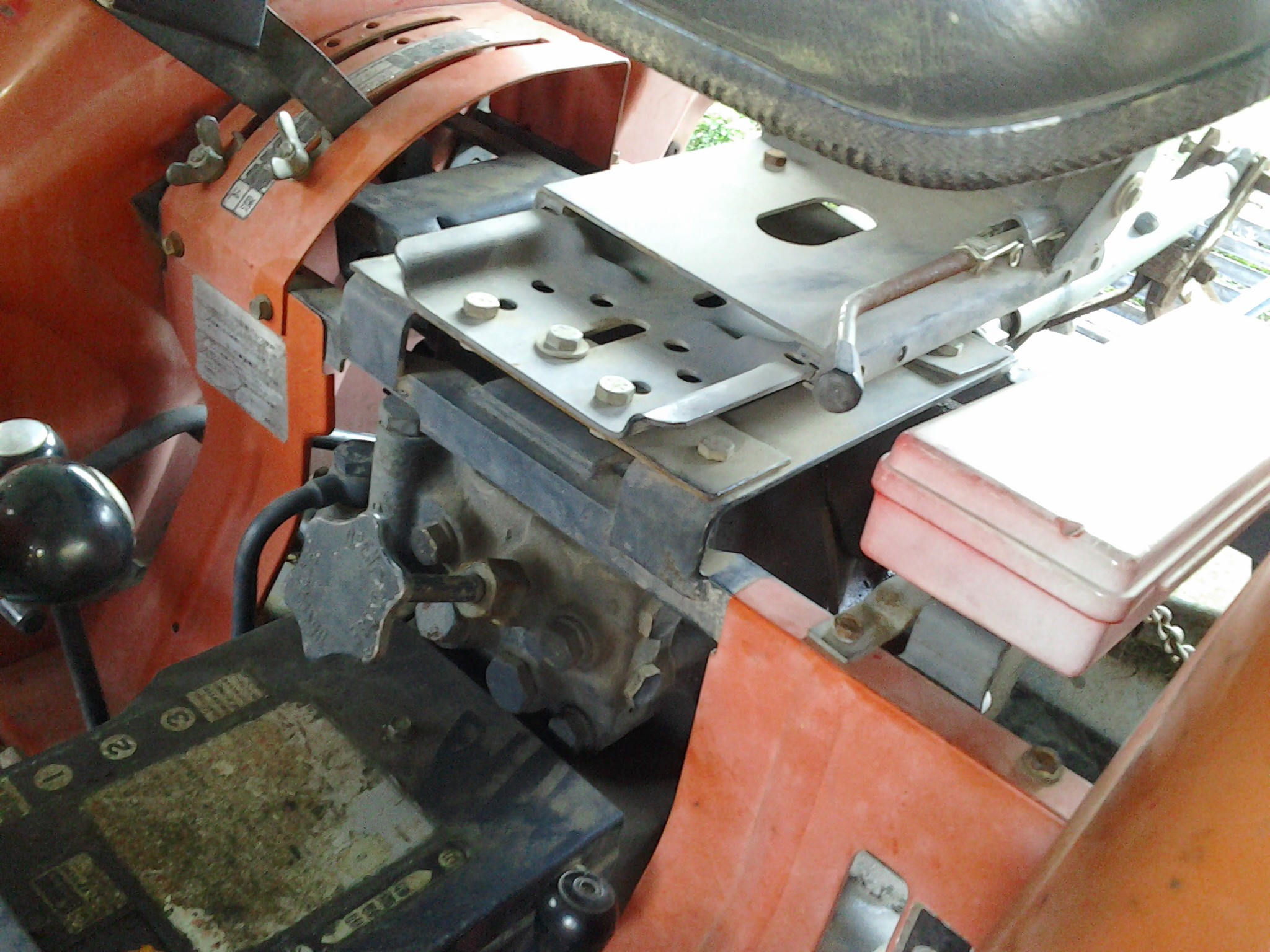

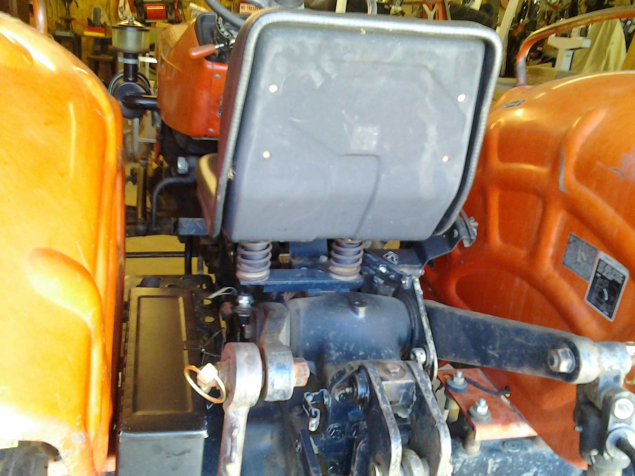

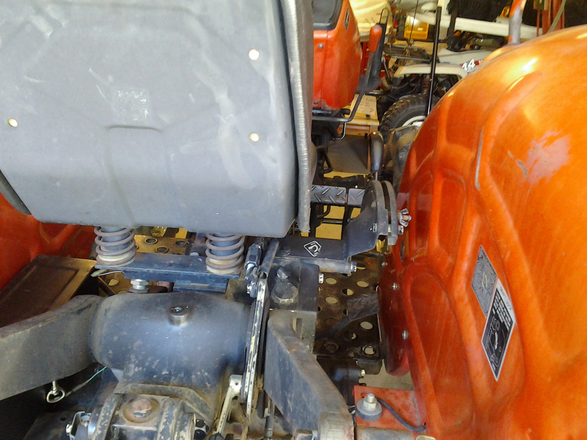

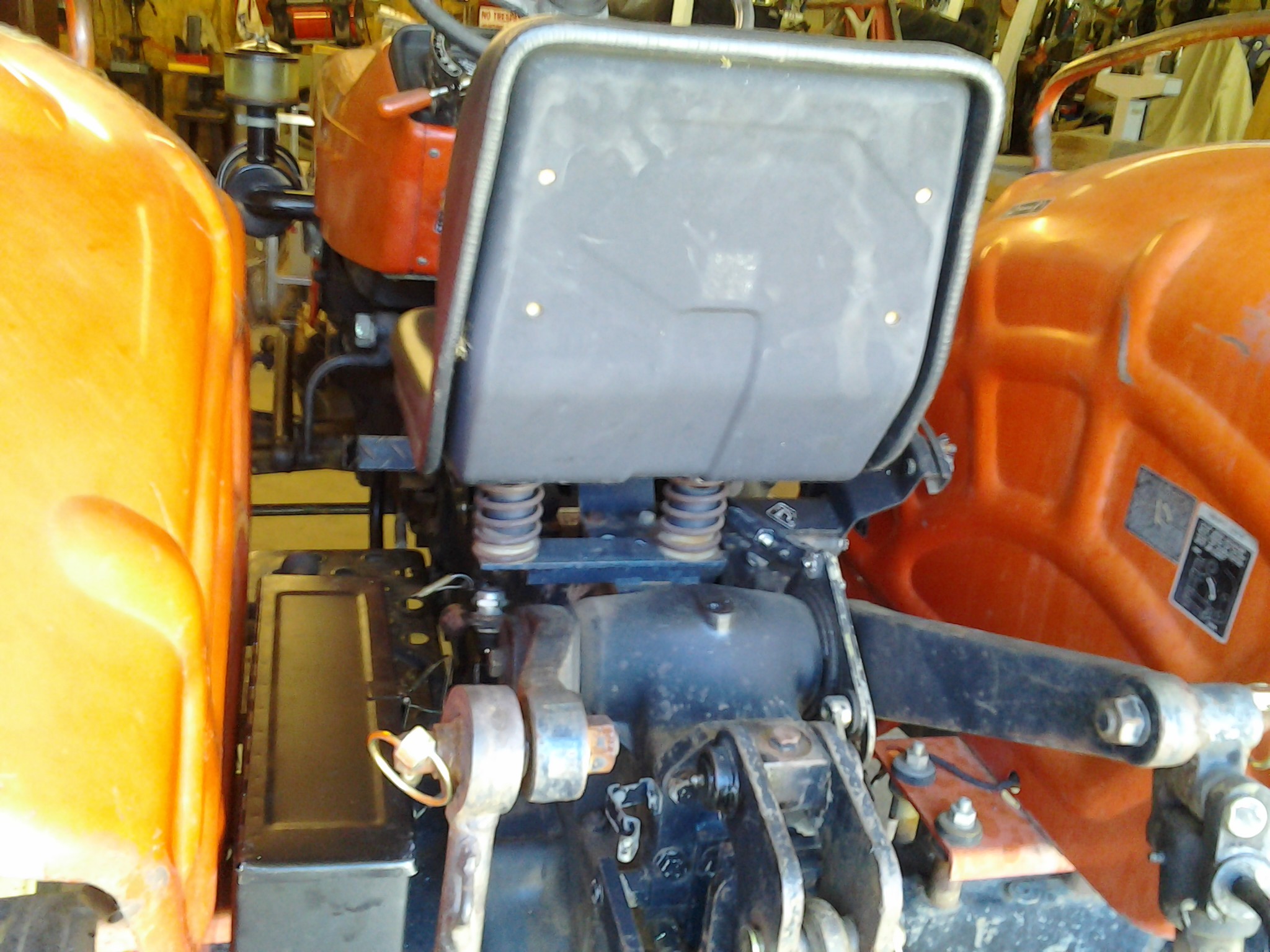

The 336 has springs as original equipment. I just thought the better seat would be a lot more comfortable. It sure is on the 2002. It will mean making a new mounting bracket. I was hoping some had allready done one and could give me some Ideas.I'll take a pictur today and post it later.003.jpg004.jpg009.jpg006.jpg007.jpg008.jpg009.jpgOne problem is the factory seat bracket is slightly off center so the bracket will have to compensate for that.

The 336 has springs as original equipment. I just thought the better seat would be a lot more comfortable. It sure is on the 2002. It will mean making a new mounting bracket. I was hoping some had allready done one and could give me some Ideas.I'll take a pictur today and post it later.View attachment 407523View attachment 407524View attachment 407525View attachment 407526View attachment 407527View attachment 407528View attachment 407525One problem is the factory seat bracket is slightly off center so the bracket will have to compensate for that.
Where did you find those caps that go over the large seat springs? Thank you in advance.
   / Seat for YM336D
I just kept looking for something that was the right size. These were end caps on a container that wire nuts came in. Sometime you have to use what ever works.:)

I put a suspension seat on mine, I think it was a "grammar" brand seat with built in suspension and little arm rests kinda. This was back in the 80's sometime ago and no pics, but I'm sure it involved a little fab work adding metal to make a flat mounting surface. Wish I kept that little tractor! That transmission was the best (3 sp + rev) on the column with no clutching, then 4 speeds (maybe 3) in the "box".
