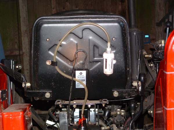

Hello All,
My dealer did not install my seat belts on my Jinma 304 and said he would never use them if he were me, however, I would like to install them anyway and use them, but cannot figure how they are to be mounted. He left the belts with me loosely packed and they also came with 2 brackets, I just can't figure out how to mount them. Anyone have any pictures?? or instructions?

I've had three Chinese tractors, uninstalled belts came with each one. I never put them on either, but assumed they got fastened by the bolts that hold the seat brackets to the hydraulic sump.
//greg//

Momboy007, You can PM me or contact me through my web site www.ranchhandsupply.com if you would like for me to send you some pictures ....... shows more than a thousand words on how and where.
The seat belts are part of the ROPS system for lack of better words. I sell only assembiled tractors and I install them. It's up to the customer to wear them are not. Just remember safety.

I think the odds are probably better with than without. Here is a pic that shows the belt attachment brackets bolted to the lower rear corners of the seat pan.

Momboy007, I just sent you some Pictures of a spring seat..... sorry for the delay.
