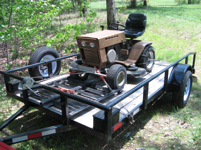

The beast:
1978 Sears "Vari-drive" 11 hp. Modified for brush-hogging; the lower 2 inches or so of the front skirt on the deck has been cut away, and a strip of 1/4" flat bar welded along what is left to restore any lost strength/ stiffness.
Old single cylinder Briggs will burn 1/2 quart of oil in a day, easy. Brake that is supposed to stop the blades when deck is disengaged doesn't work (deck warped so badly from hitting stumps & rocks that the brake shoe no longer contacts the sheave).

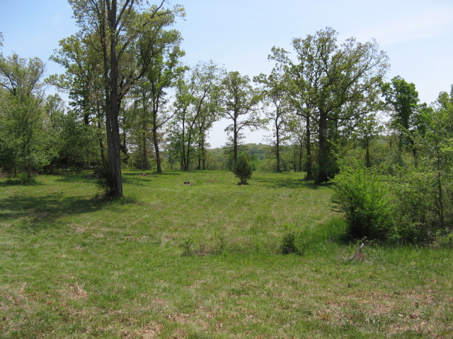

Mowing about 5 acres or so on Sunday, 200 miles from home, and down in the Missouri Ozarks:

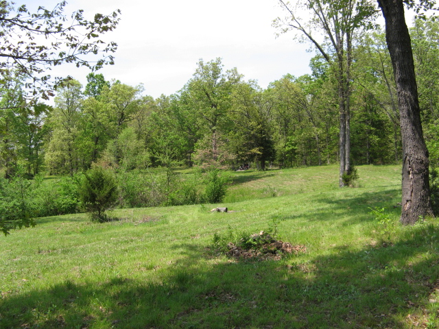

The "neighbors" mark their boundaries well:

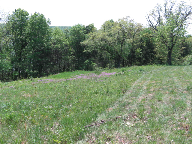

The lake (7,800 acres) just beyond the trees:
Rocks, stumps, stump holes, really rough ground, tall weeds. That little old Sears takes it all in stride. About bucked me off the thing a hundred times or more, but it keeps on running and cutting.

That old mower will probably need some lead substitute to help put the rings and valve seats into better shape. The "unleaded" gas (full of rubber eating ethanol) we have today is not good for those old engines.
You can buy some additive at most autoparts stores to help the eng live.

Well you can't say it doesn't earn its keep.
