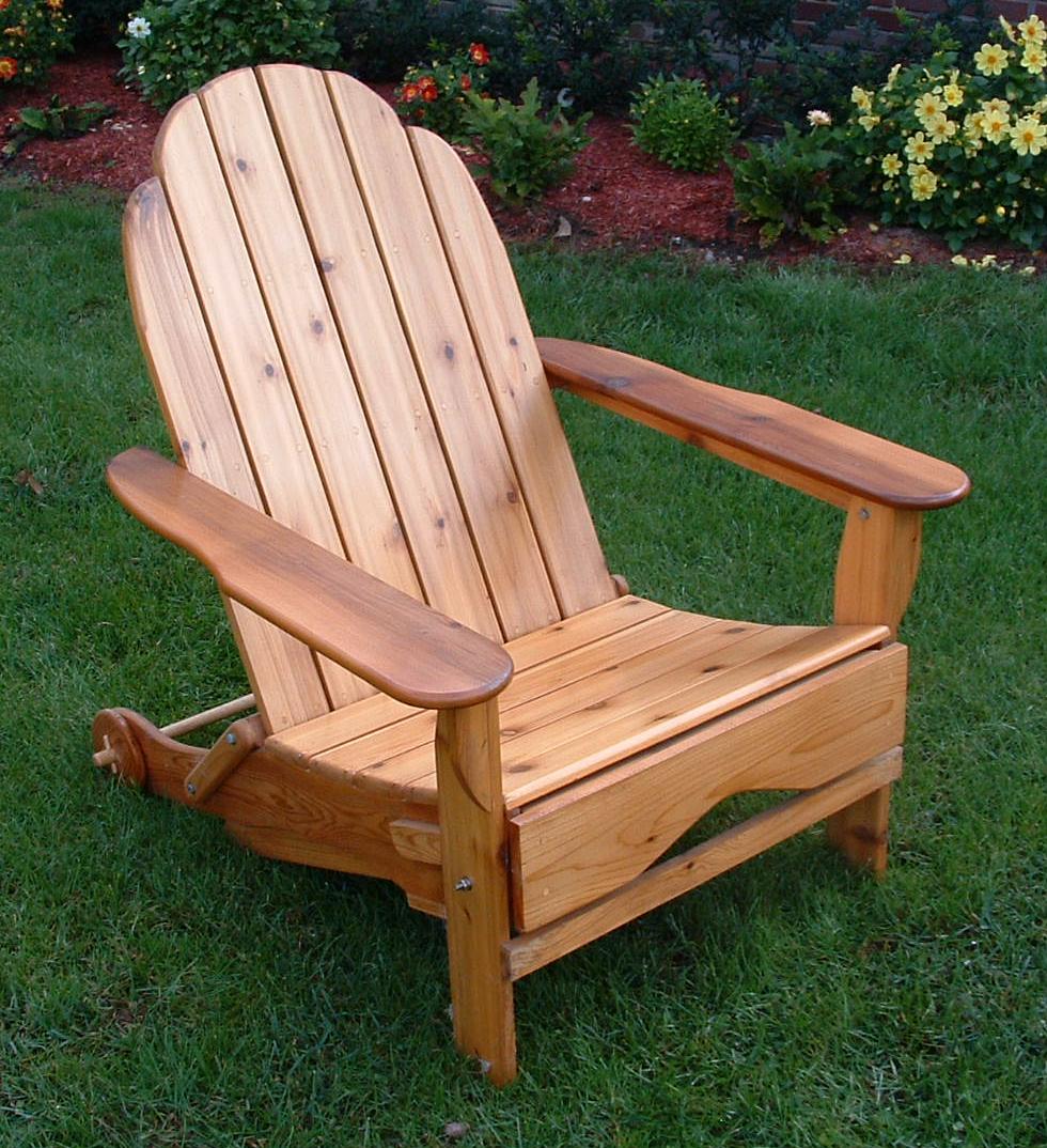

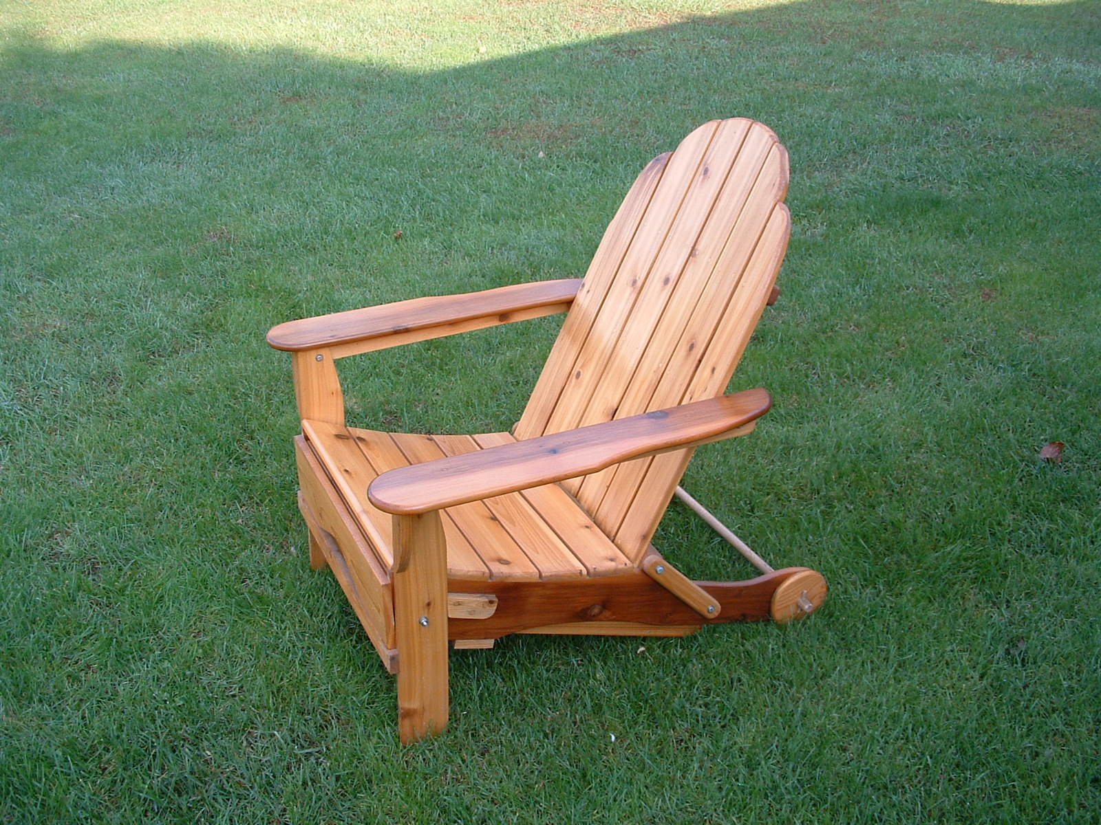

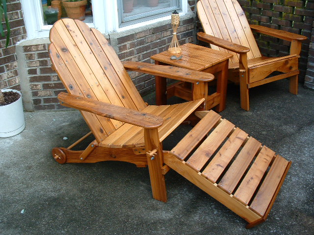

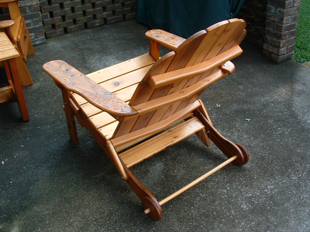

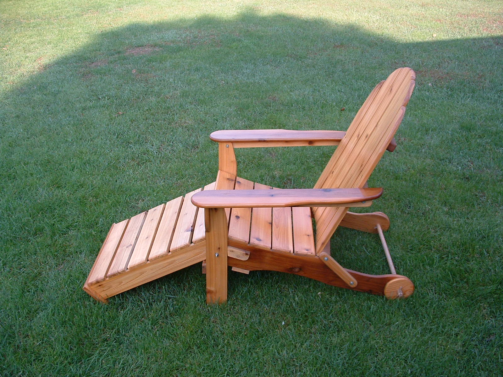

Here are a few pictures of my cedar adirondack chairs. I'm no wood expert so I didn't know that I shouldn't use Poly. They have been outside for 3 years. and still look darn good in my opinion.
Regards,
Duber
