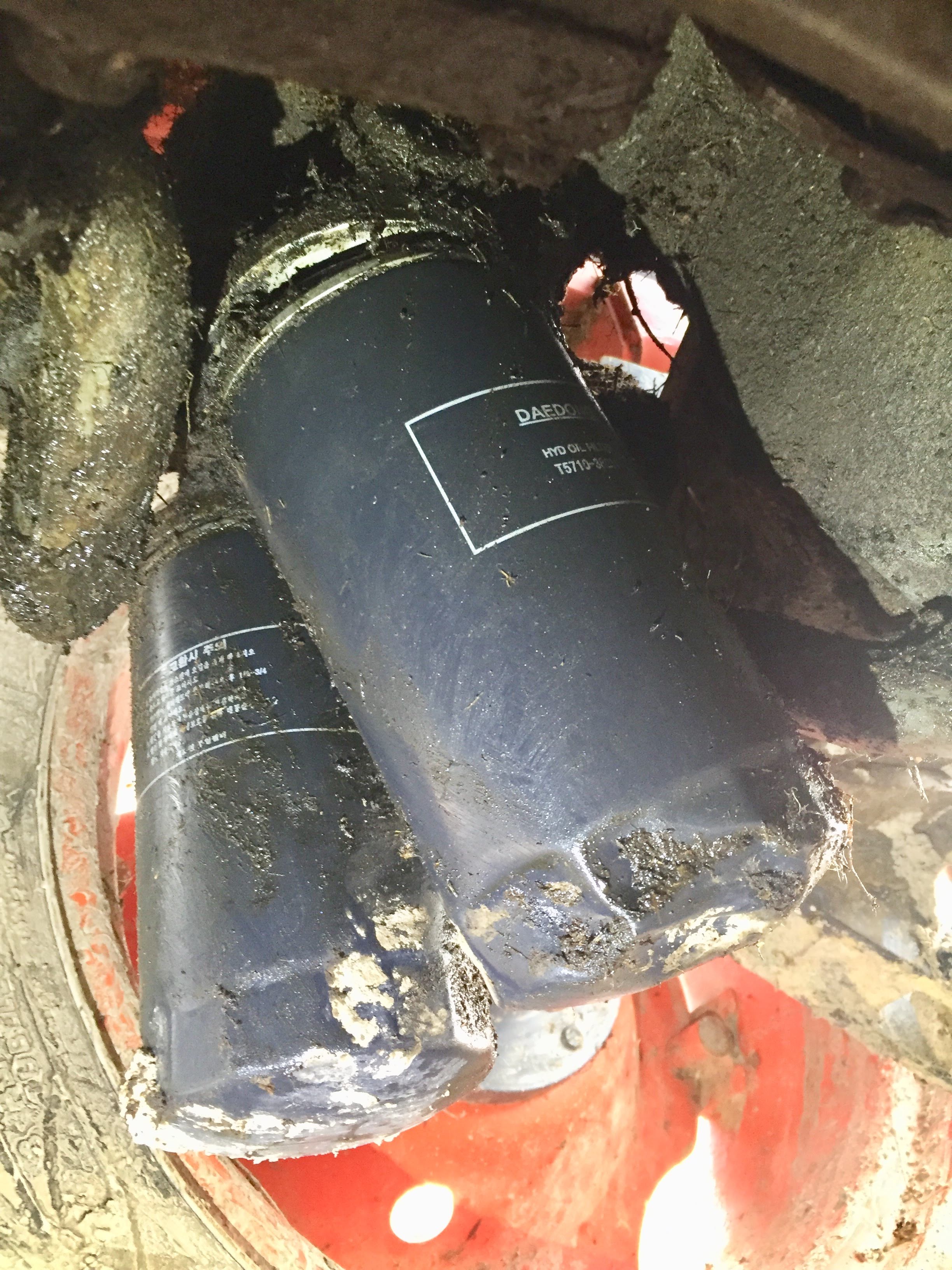

I'll post pictures later when I'm at my computer. Thought I could do it from my phone. On top of that I've just lost all hydraulic power to steering, loader and the 3-point. Only day three and not looking so great.

Not yet, but I think I found the issue, just waiting for a replacement hydraulic oil filter to come in on Tuesday! I got under the tractor and noticed I had bent back one of the hydraulic oil filters. I'm assuming it bent it good enough to restrict oil flow. I ordered a replacement on Monday, but will not be here until Tuesday of this coming week.
