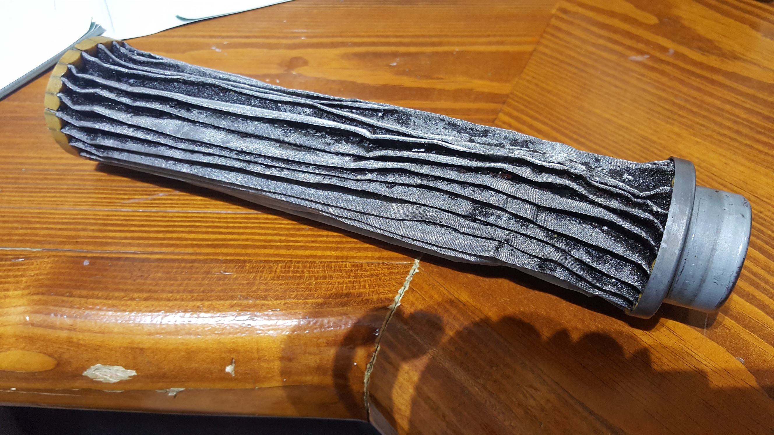

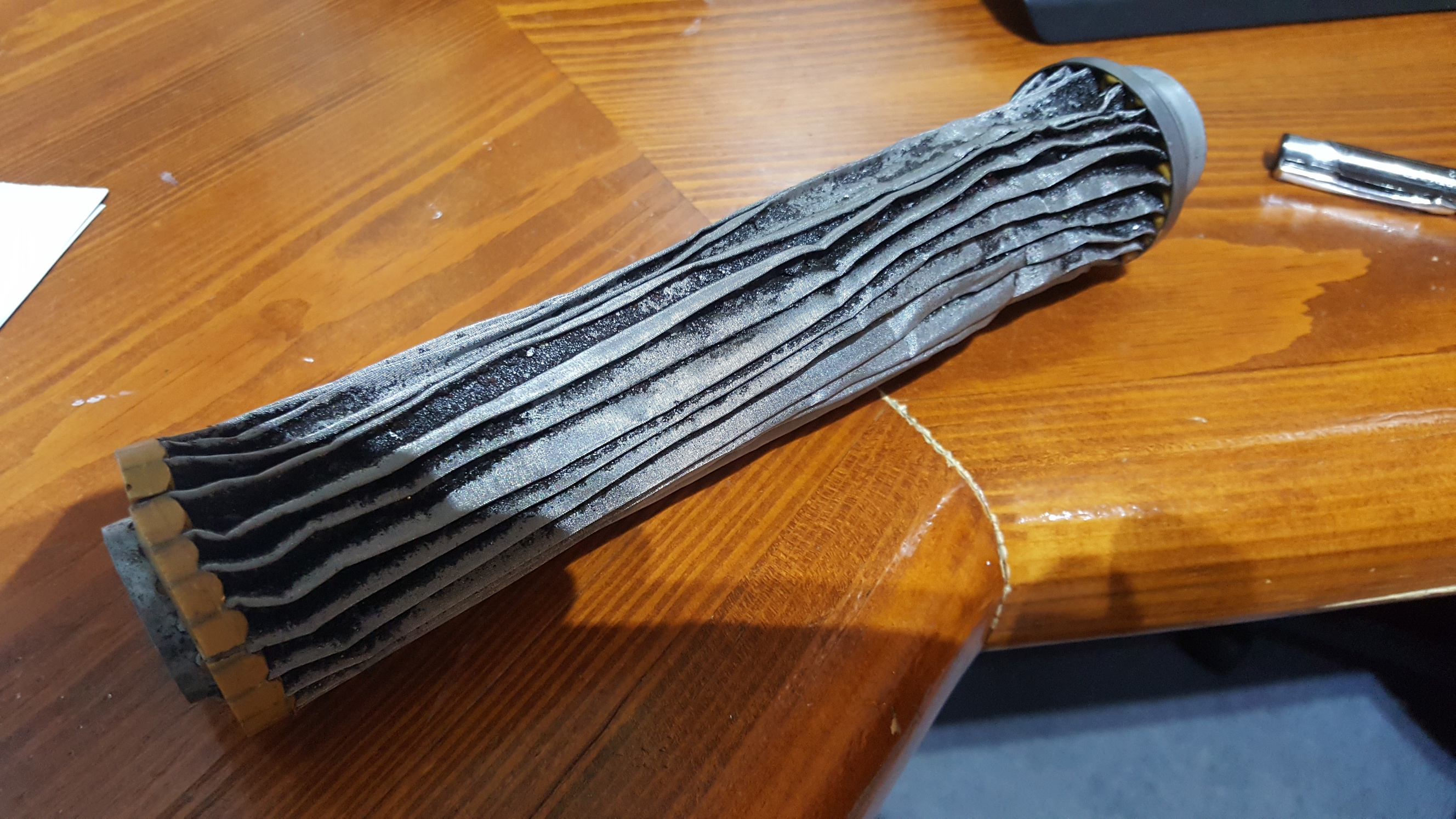

Hi, I have a Iseki TA 320 Tractor and was wondering if anyone knows where I could purchase a screen filter for the gearbox/hydraulic oil

From what I see in your pics that filter is mostly just crudded up.
I would believe that soaking in varsol (or gas) and a blow gun would put it back into service.
Perhaps a little 're shaping' could be done as well.
Even a small tear could be soldered.
   / Screen Filter
Thanks for the advice, I will give that a try first.
