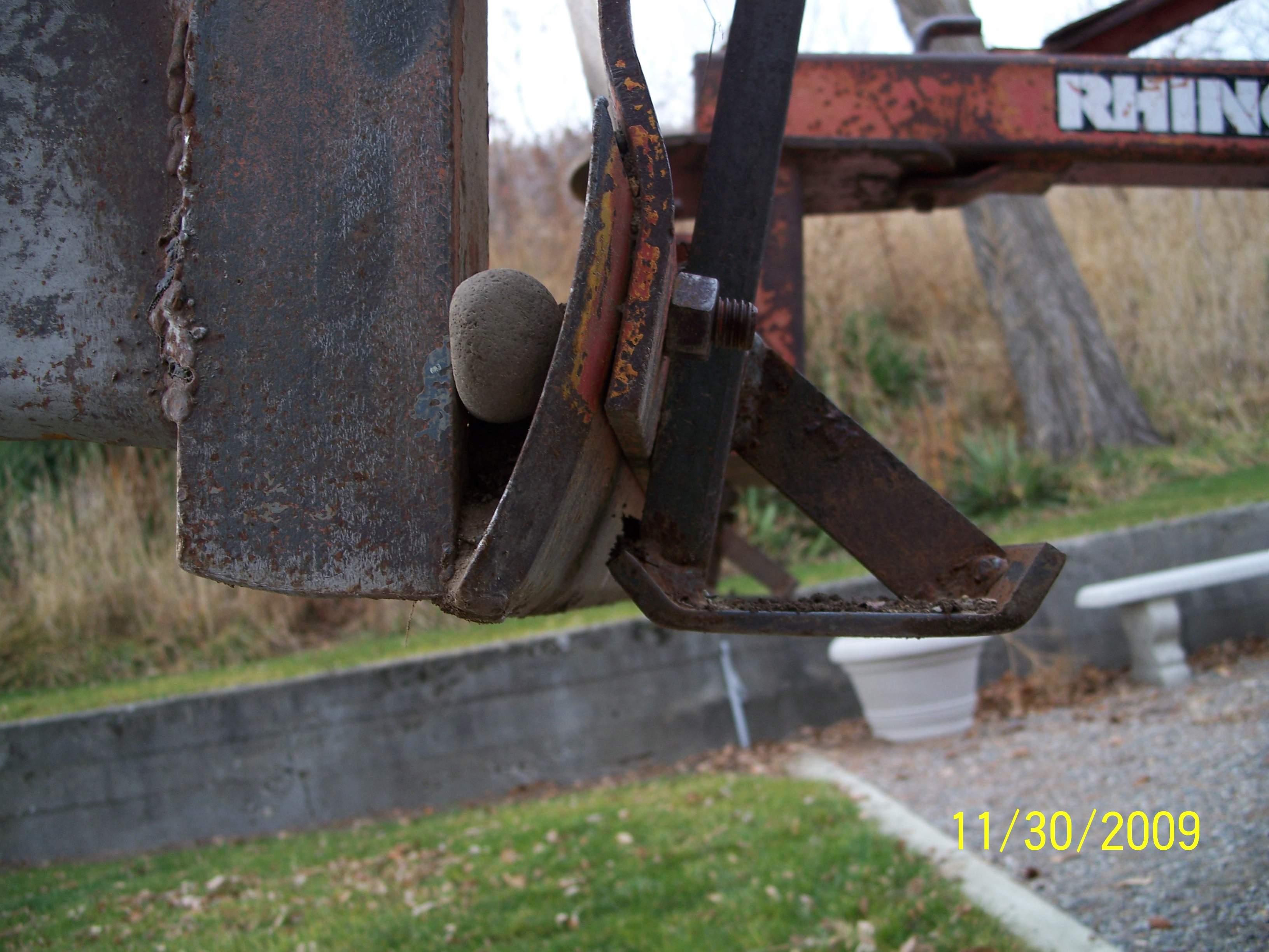

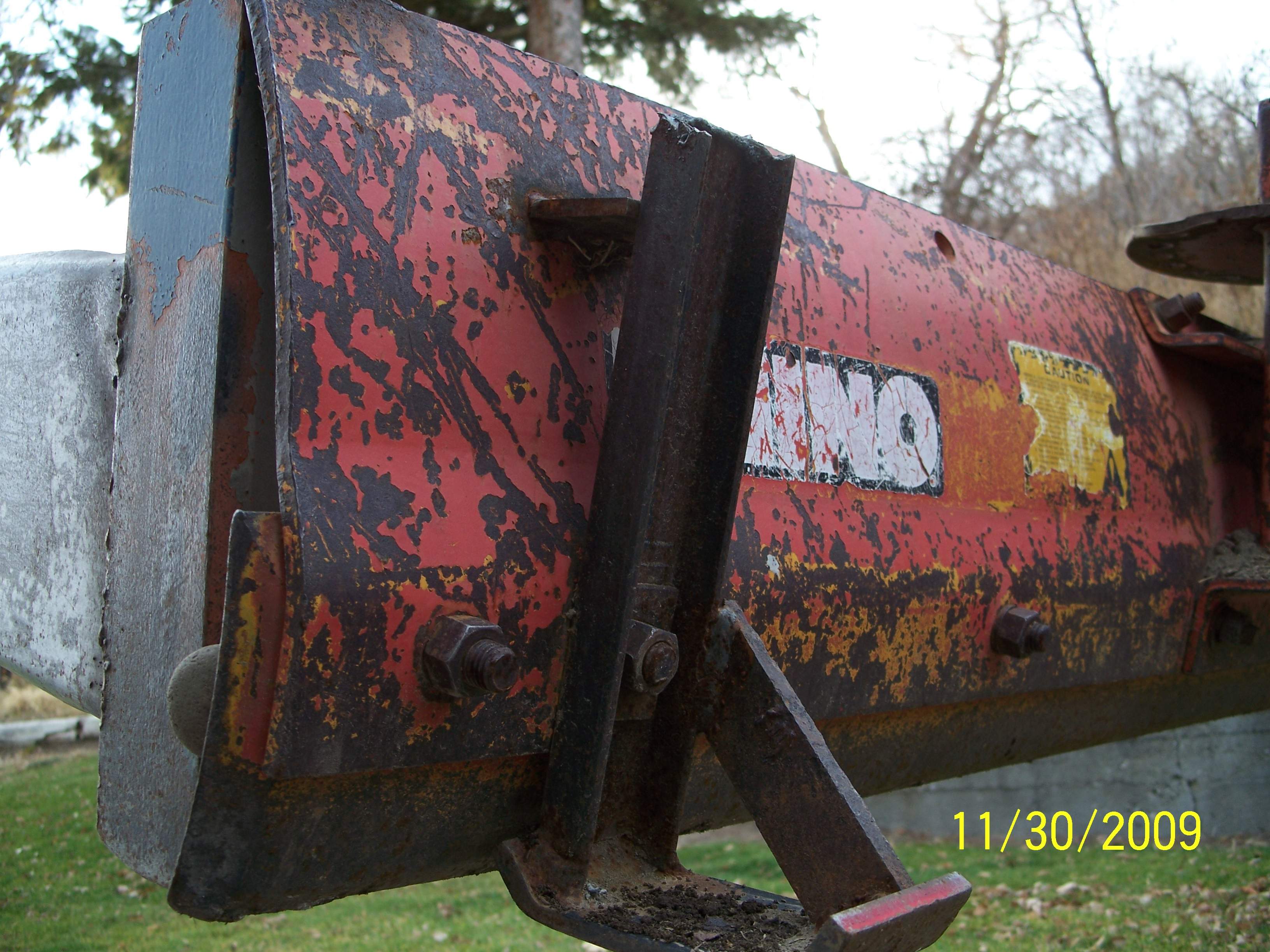

This is what I have built. I had the shoes bent at a machine shop. The channel has a slot cut in it with a plasma torch and a washer installed over the slot to prevent binding. It can be adjusted up/down by loosening the nut. The shoes can be adjusted for final tweaking by use of the top link. This modification has worked better thab I expected. Gravel, dirt, snow, it works perfect.
I think it would work very well with the top link disconnected in the float position also.
I welded some wings on the ends of the blade to act as a box blade also.
