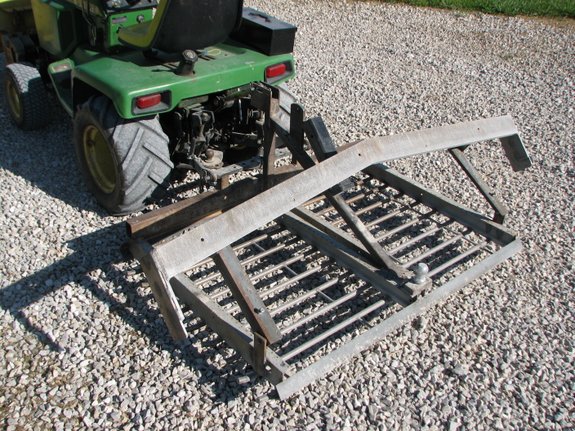

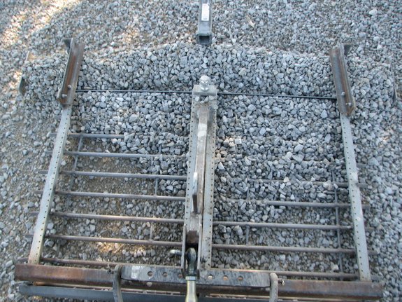

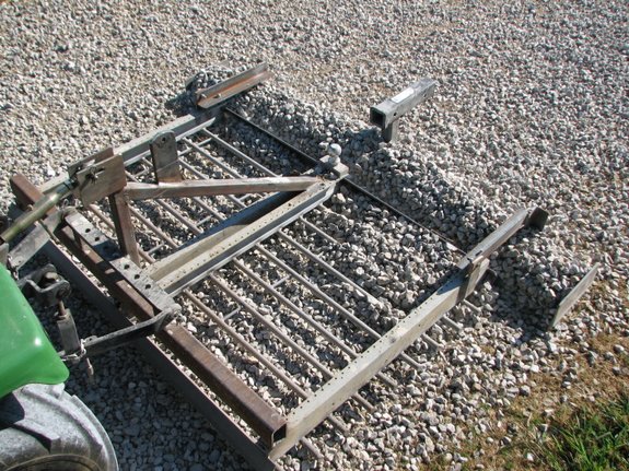

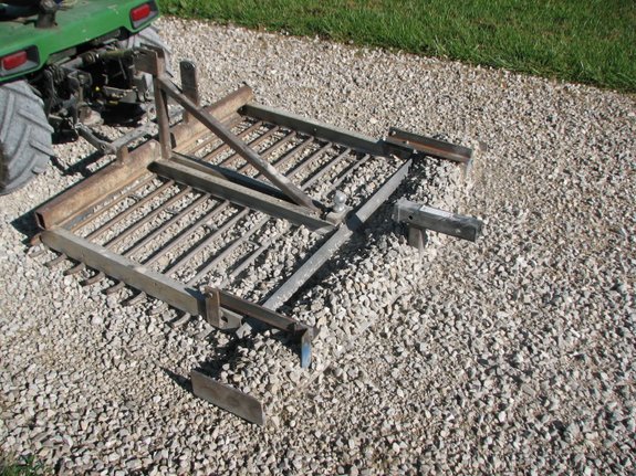

One of my latest projects. I call it a screed leveler because it reminds me of a screed board. The very back drag lifts up off the ground after the main section is about a inch off the ground. Makes for a nice finish. The angle in the back holds enough material to fill in low spots. If you flip the back drag over you can use the drag forward or reverse. The trailer hitch tubing and ball are not used. I changed my mind in the design.

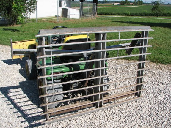

I forgot to mention that I pin it in a vertical position to save floor space while it is in storage.
