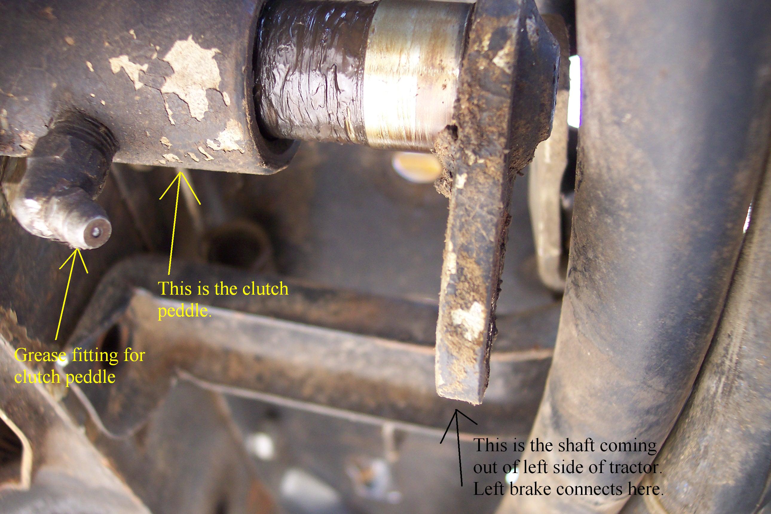

Okay in reply to my own post it transpires that when I hit the clutch pedal this also slightly activates the brake pedal hence the screeching noise mentioned originally so I need to find out why the brake is moving in tandem with the clutch pedal and then I should be sorted.......
   / Screech from rear left hand wheel when depressing clutch pedal #7

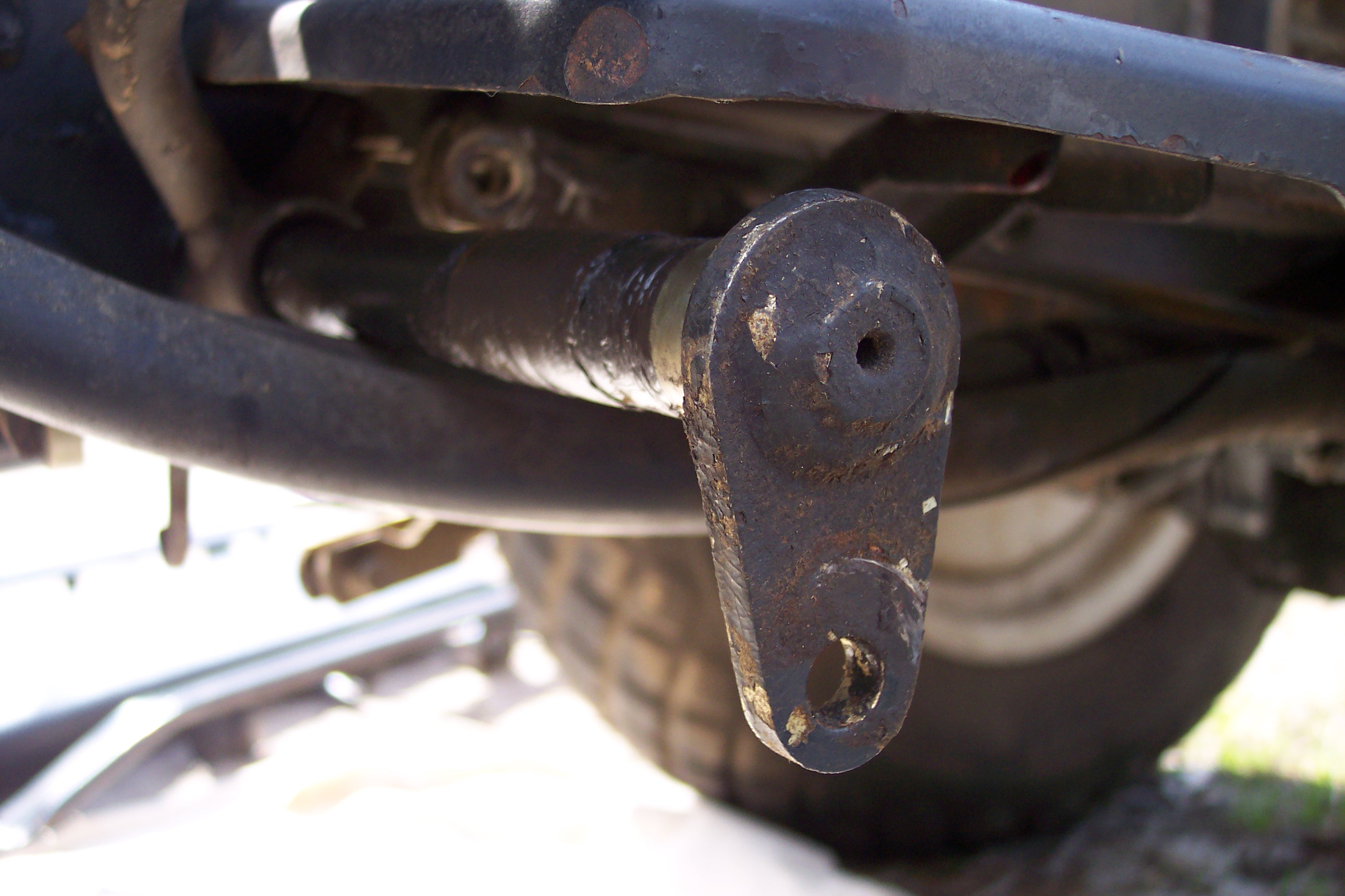

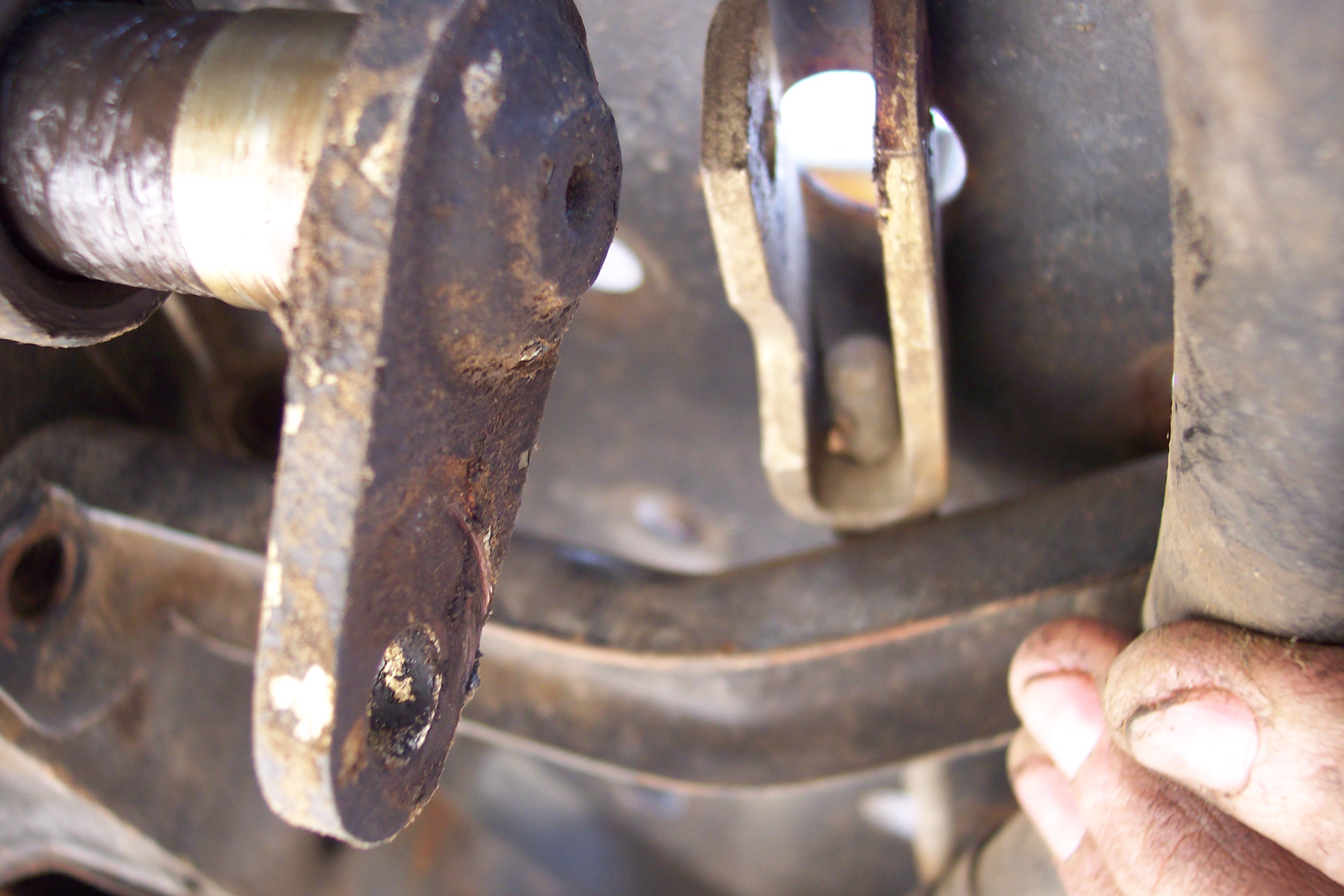

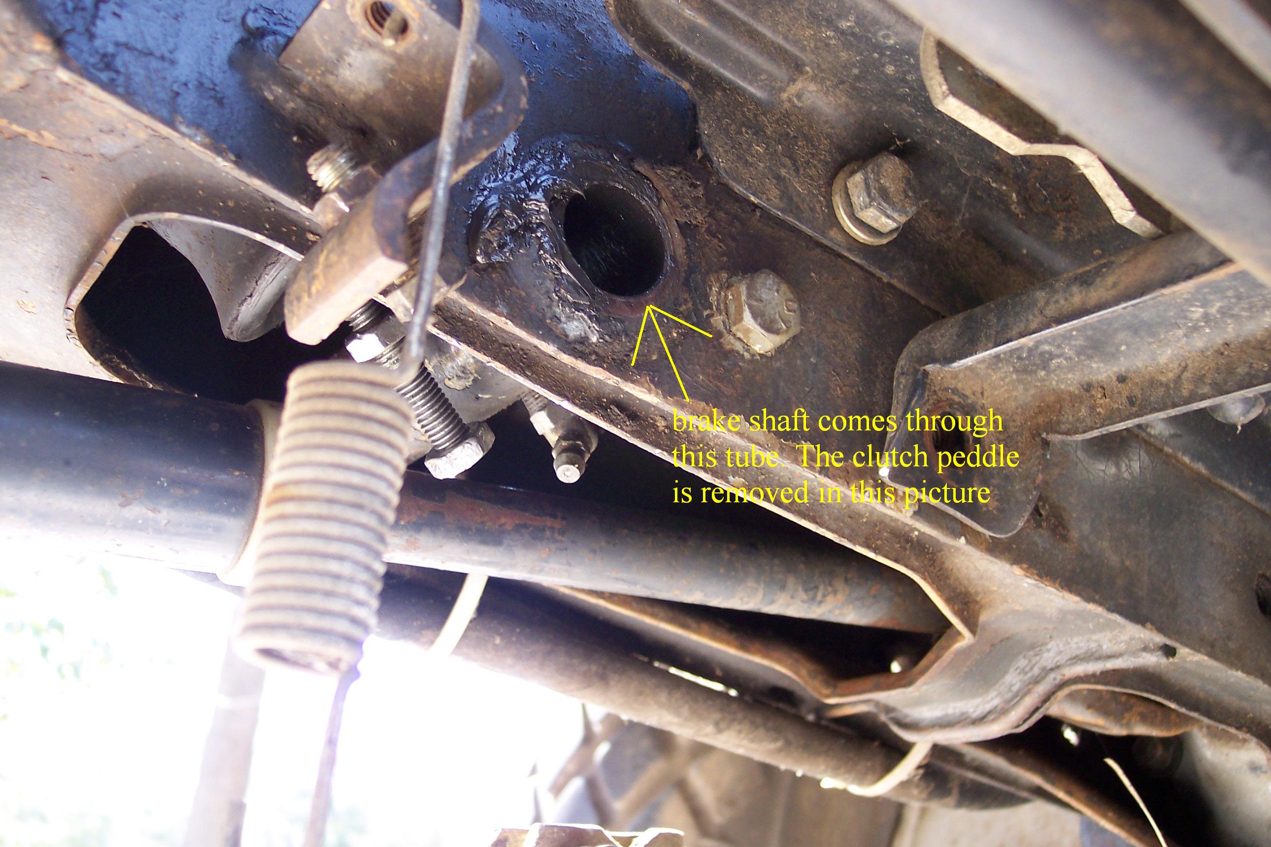

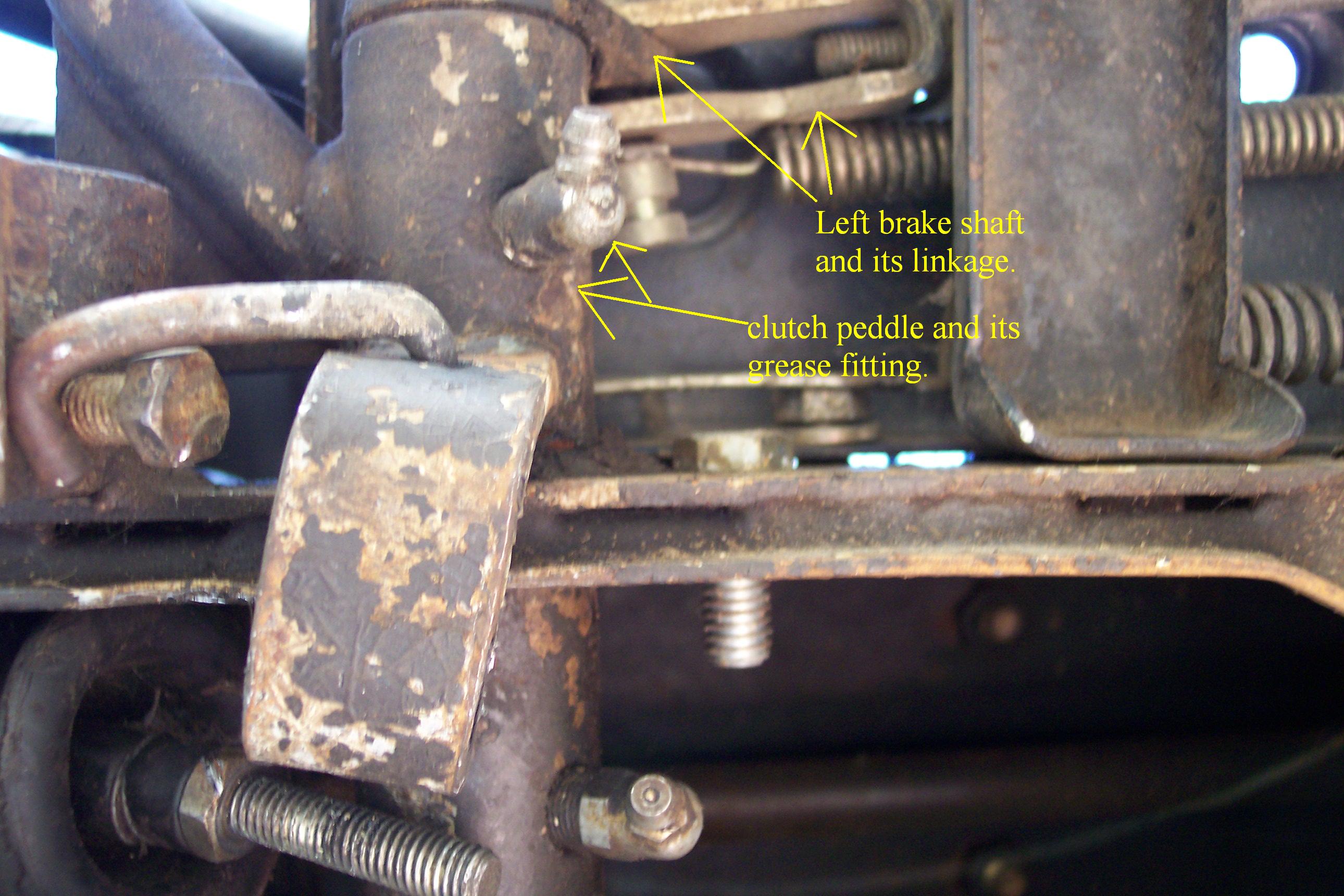

The clutch pedal pivots on the shaft that goes to the left brake pedal.
This shaft crosses from the right side of tractor where the brake pedals
are to the left side to connect to the left brake. the clutch pedal
pivots on this shaft also. If it has not been lubed in a while then
maybe clutch pedal is rusted to this shaft and applying the left
brake. Here a few pictures of this set up. I spelled pedal
wrong in the captions on the pictures. Duh!

Thank you so much for your reply and the pictures......grease gun out I think!!! I note that if I hold the brake pedals towards me with my right foot when depressing the clutch I don't get any noise at all so you've got to be right!!
