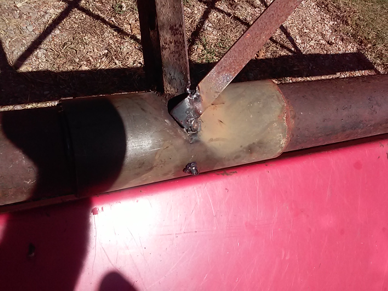

Here's a short video on the grapple I just built, nearly all from the scrap metal pile. Scrapple? The tines are made from worn down scraper blades, the cylinder is a top link cylinder I was not using. I only had to buy $5 worth of fittings to get this project working. Doug

1012161417a.jpg Here's what I did for hinges, just welded the tines to a short length of pipe that slid over the main pipe mount.

Humbly suggest adding grease zerk fittings to your hinges will make them last a lot longer and operate quieter
