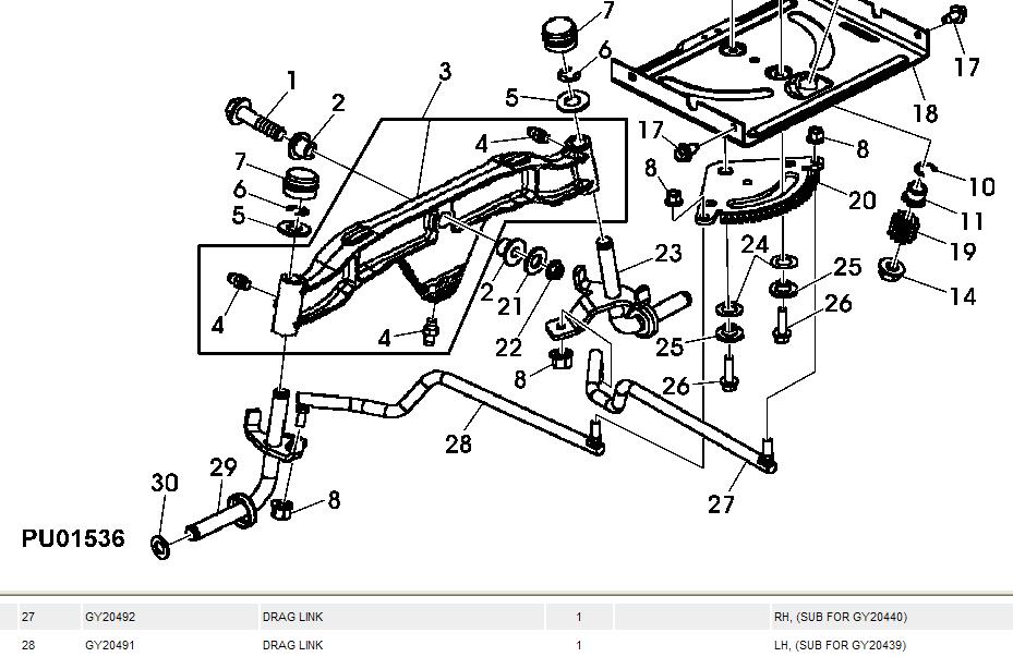

New member here. I have an L2548 that lost its steering. The ball/socket style pivot point in the steering mechanism (one of two in the assembly, one for each wheel) became unattached. It looks like the ball might be pressed into the socket when new. There appears to be no other mechanical connection holding this joint toghether.
Has anyone ever had this happen and if so is it repairable? If not is there a site that I can go to with a parts diagram or assembly diagram that shows these types of part numbers?

I take it they are the drag links, and they can be ordered from Deere. The attached shows them and their part numbers. From jdparts site (free registration) that you can also go to. Enter model no. 2548

Beenthere, thanks for the diagram and the site reference. The "drag Link" is exactly what I was looking for.
