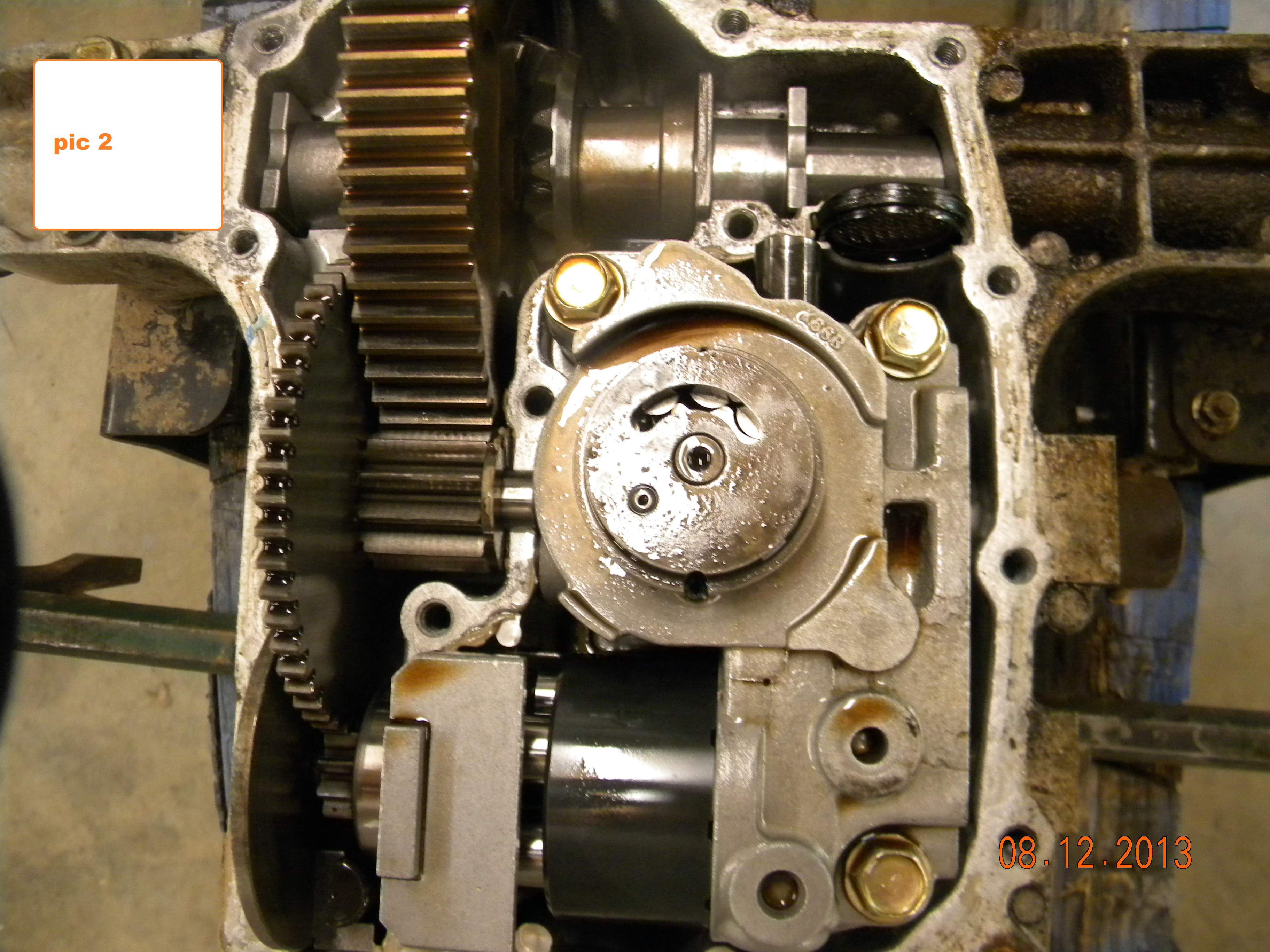

My 2554 has been losing drive power and now has gotten to the point that when trying to go uphill it simply will not do it. The fluid level is fine and clean and I've already changed the drive belt. I took the transmission apart and cleaned the filter and looked around for anything that may be an obvious problem. I did pull the pump to look at it and have a couple of questions there. First of all, dummy me, I didn't pay attention to how it came off, but I need to know how this disc goes back on. Is picture 1 or picture 2 the correct orientation for the disc which is dead center in the photos? And in picture 3, is there supposed to be this much slop between the cogs here? Thanks in advance for information or suggestions... Charlie

BTW, it's a Tuff Torq K66... the exploded view I have says to be sure and get the parts in the correct orientation, but I can't tell by the drawing.
