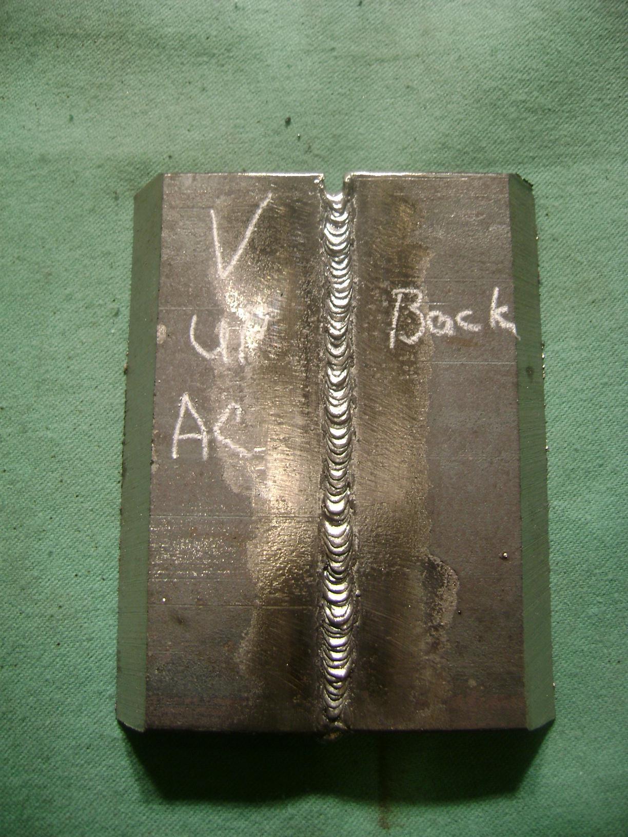

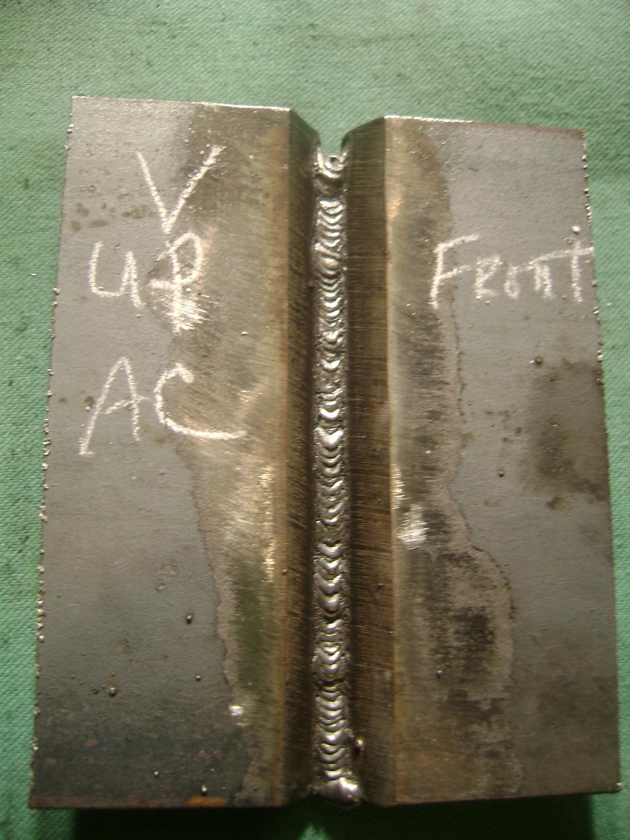

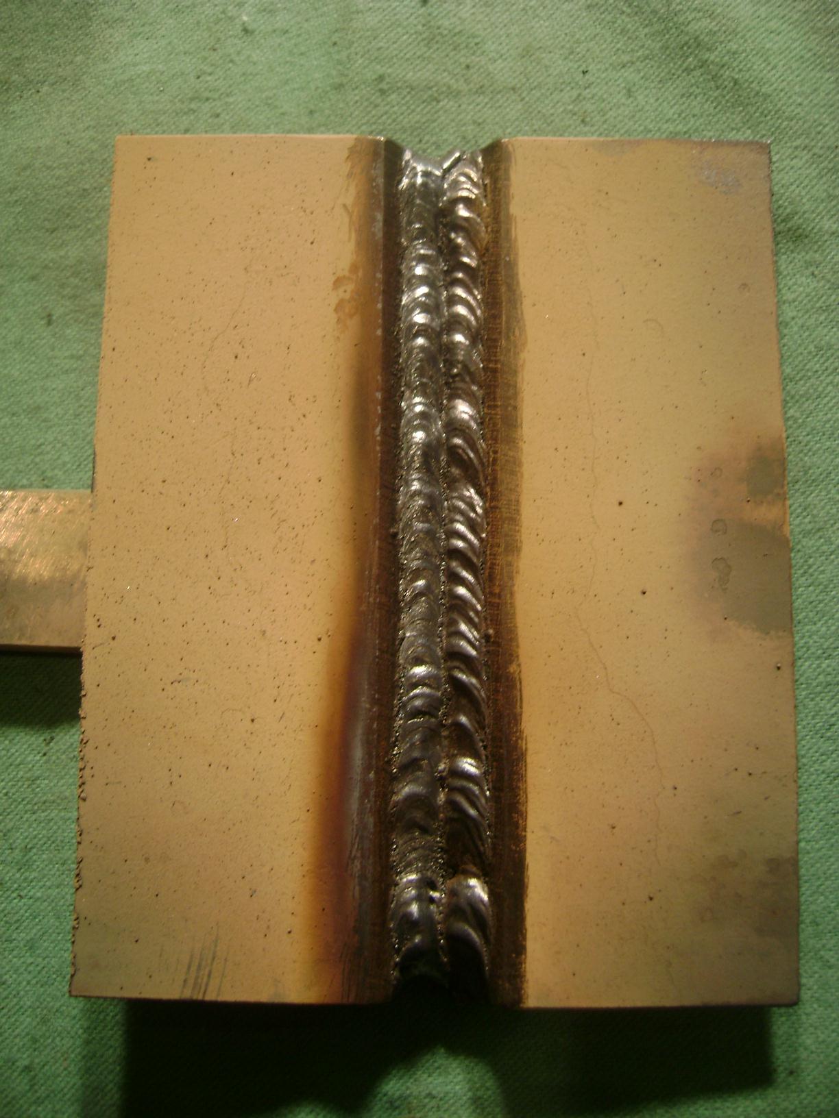

Bah, you only need one or two types of rod to weld and they are very very available at home depot. 6011, 6013, 7018 any of those in the appropriate diameter and you're all set. Do not worry about rod availability with the AC machine.
The AC vs. DC thing is also nothing to worry about for your application. Yes, AC means the current alternates but it alternates 60 times per second just like your light bulb does. Do you see the lightbulb flickering? This is a non-issue. The big benefit of DC welding is that it is easier to weld "out of position" meaning overhead or on a vertical weld. The AC weld puddle tends to drip away if it can. This can be resolved with technique to some extent.
Get the used AC box and try it, you know you can always sell it for what you paid.
I own an old AC225.
I have been able to weld exhaust pipe with the stick welder, not pretty but in a pinch you can do it. Expanded steel for trailers, I've done lots of that, the trick is to start your puddle on the thicker base metal and bring the grate into the puddle.
Rusty 1/4" thick steel is perfect for a tombstone.
