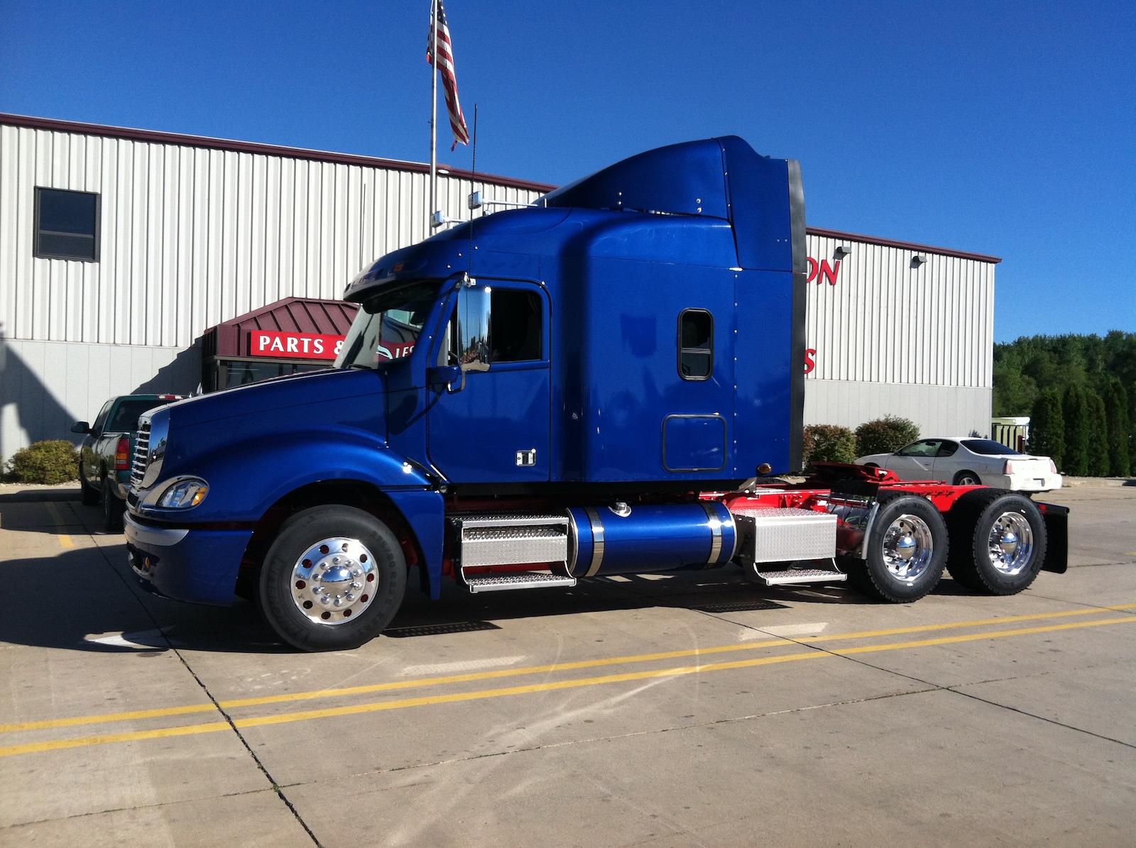

Did you buy a glider/glider kit?
   / Schaeffer 10w30 in Detroit Deisel 60
Yep. A 2013 FL glider. Ordered in February 2012 and put to work in August 2012.
   / Schaeffer 10w30 in Detroit Deisel 60 #4
Very nice....love the color!
It seems like for anybody who doesn't care about going to CA, a glider makes a lot of sense. My neighbor does regular runs to CA, but has had all of his trucks fall victim to emission control problems at one time or another, and those bills are scary!
I started narrowing my lane focus in 1999. Done much better both time wise and profit wise by staying primarily in the upper Midwest. Haven't taken a load to CA since 1998. Just made sense to go glider. Saved almost $40K on a new purchased compared to similarly spec'd emissions truck.
   / Schaeffer 10w30 in Detroit Deisel 60 #6
And none of the hassles of the emissions truck.
   / Schaeffer 10w30 in Detroit Deisel 60 #7
And none of the hassles of the emissions truck. :)
