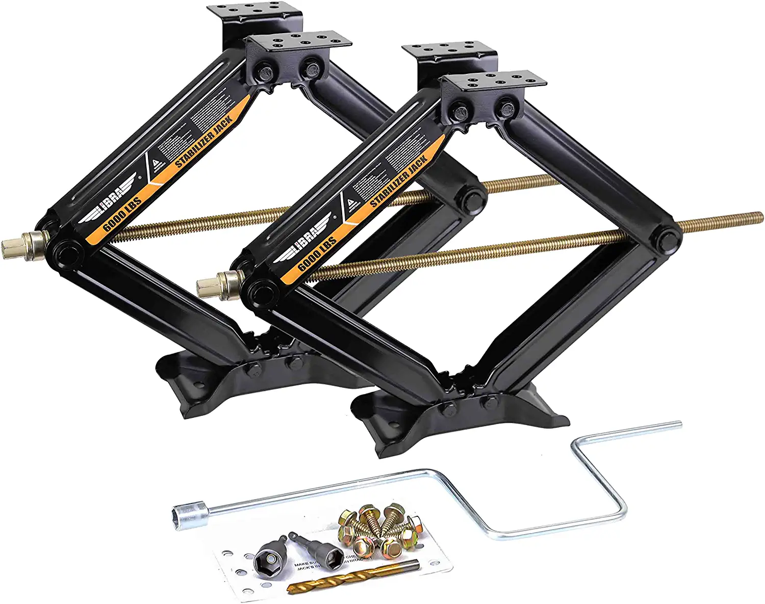

Similar thing has happened to me before also. Scary for sure as well as very dangerous. Here's what I did to resolve future situations like yours for $80 on Amazon:

Jackstands on back of trailer, put truck in 4wd so front axle is in park also. Learned that lesson the hard way when I had a car hauler with ramps.
