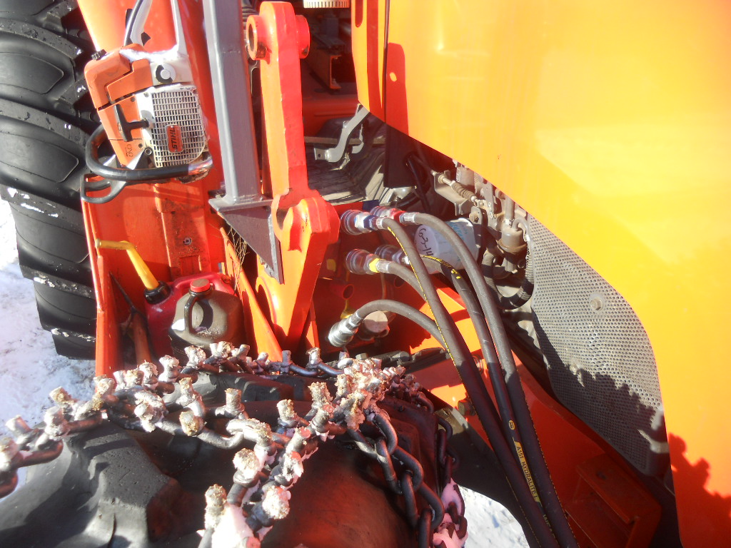

These "ice chaines" are more like ice magnets, expensive but you'd almost think that you were on dry pavement with them. These are "trygg" brand. They will last years & years for your use.
Tractor, Grader & Loader Studded Chains

Interesting you only use the chains on the front tires. Does that work well?

Do you just run the chains on the front? I know a lot of people are nervous about even putting chains on the fronts.

:laughing: That's an old pic. for the oil change date. Yes I only have them on the front. They came from c/l for $300, new chains for the rear (18.4x30) are just under $1500!! :eek:
Luke, I just try to use good sence operating (with my fingers crossed) and it's only during snow plowing duty. Mainly for steering control and one hill I have. I figure once you get that 5 tons rolling, the actual snow plowing load is not that great, ya just gotta maintain your momentum.
