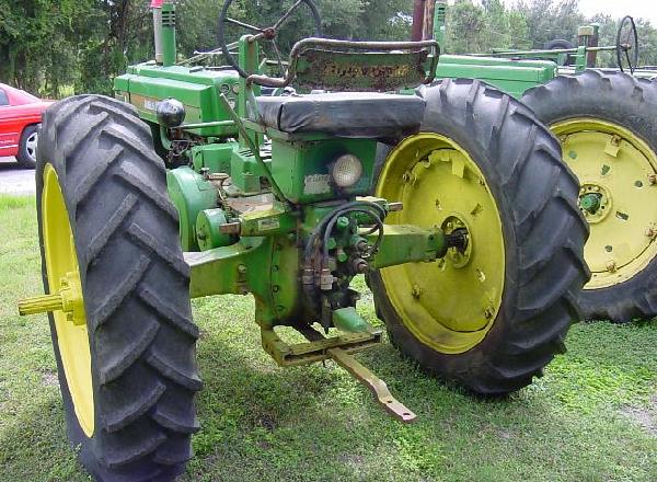

If it is the B your talking about.. you can use external hyds.. it will run off the powertroll lever. I have left the oem JD hyd plugs in the back of my 'B' as they are prone to oring leaks with repeated removal.. etc.. and instead added 2 2' lines off the side tapped plugs, and put quick disconnects on them.
(I've attatchd a pic of my B.. it is back before I restored it.. but I didn't have any other rear shots available.. but you should be able to see the hyd setup in this one.. lines are tapped into the side of the hyd manifold wher ethe oem plugs are. the taps were alreade there.. I didn't drill them or anything.. they were just capped. )
Works great for external hyds..
