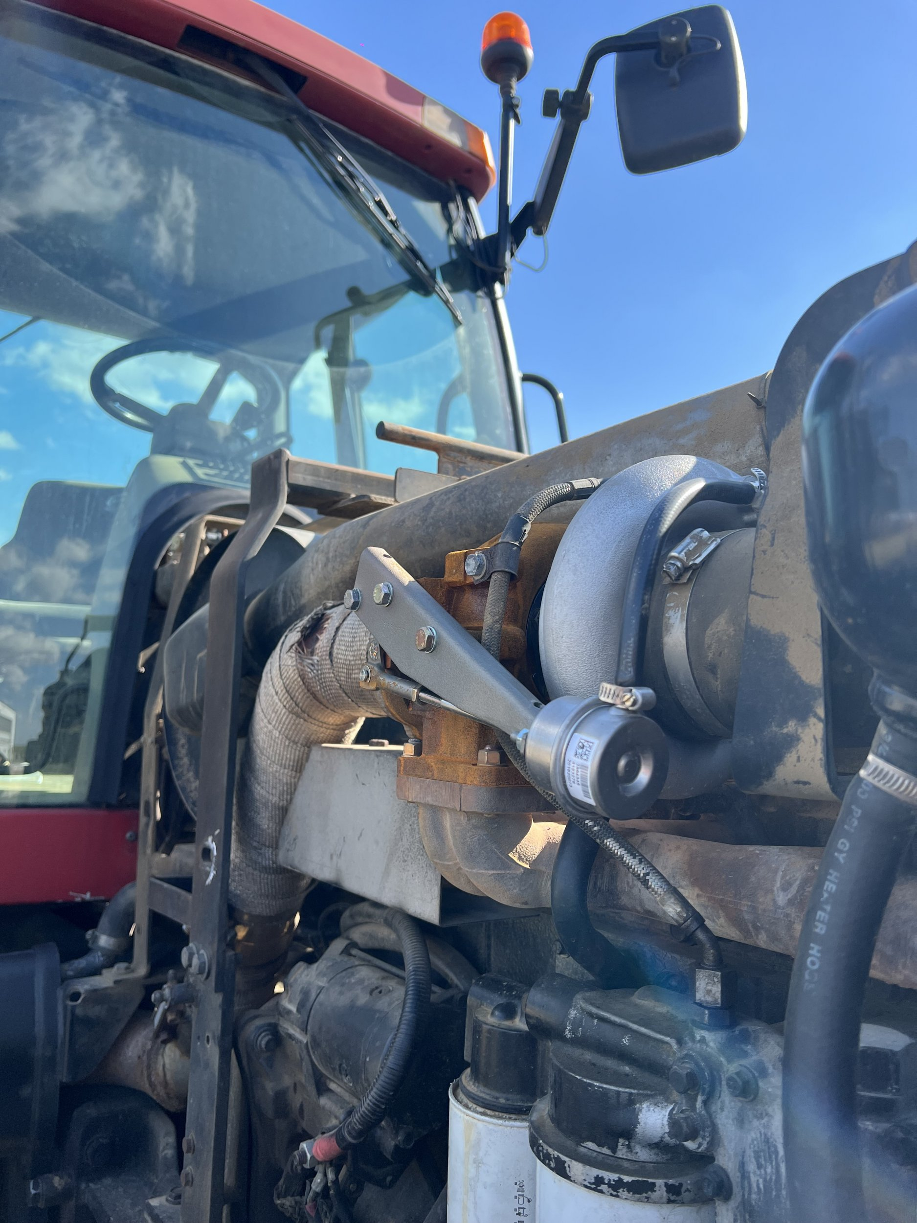

While operating my Magnum last year it was blowing oil out of the breather tube when the turbo was spooled and making max pressure, max RPM and max load (like pulling a heavy square baler up a hill at road speed).
I thought I had a cracked piston or ring, but after performing some tests, we found it was just bad turbo seals.
It had no smoke, but massive blow by from the breather tube. Something I had never seen before to this extent.
Turns out the turbo seals were leaking air, not oil as I had thought. The leaking air was blowing through the turbo drain line into the crank case and acting like a compressor, filling the crankcase up with excessive air pressure. This forced air pressurized oil out of the breather tube.
Also, the muffler atop the engine was partially collapsed, creating back pressure.
I never thought I’d be relieved at having to spend $3,000 for a turbo and muffler, but compared to a $15,000 in frame (actually it’s out of frame) overhaul, I feel somewhat relieved.

New turbo installed. Had leaking seals.
New Muffler installed. Was clogged up and pretty well shot and creating back pressure.
