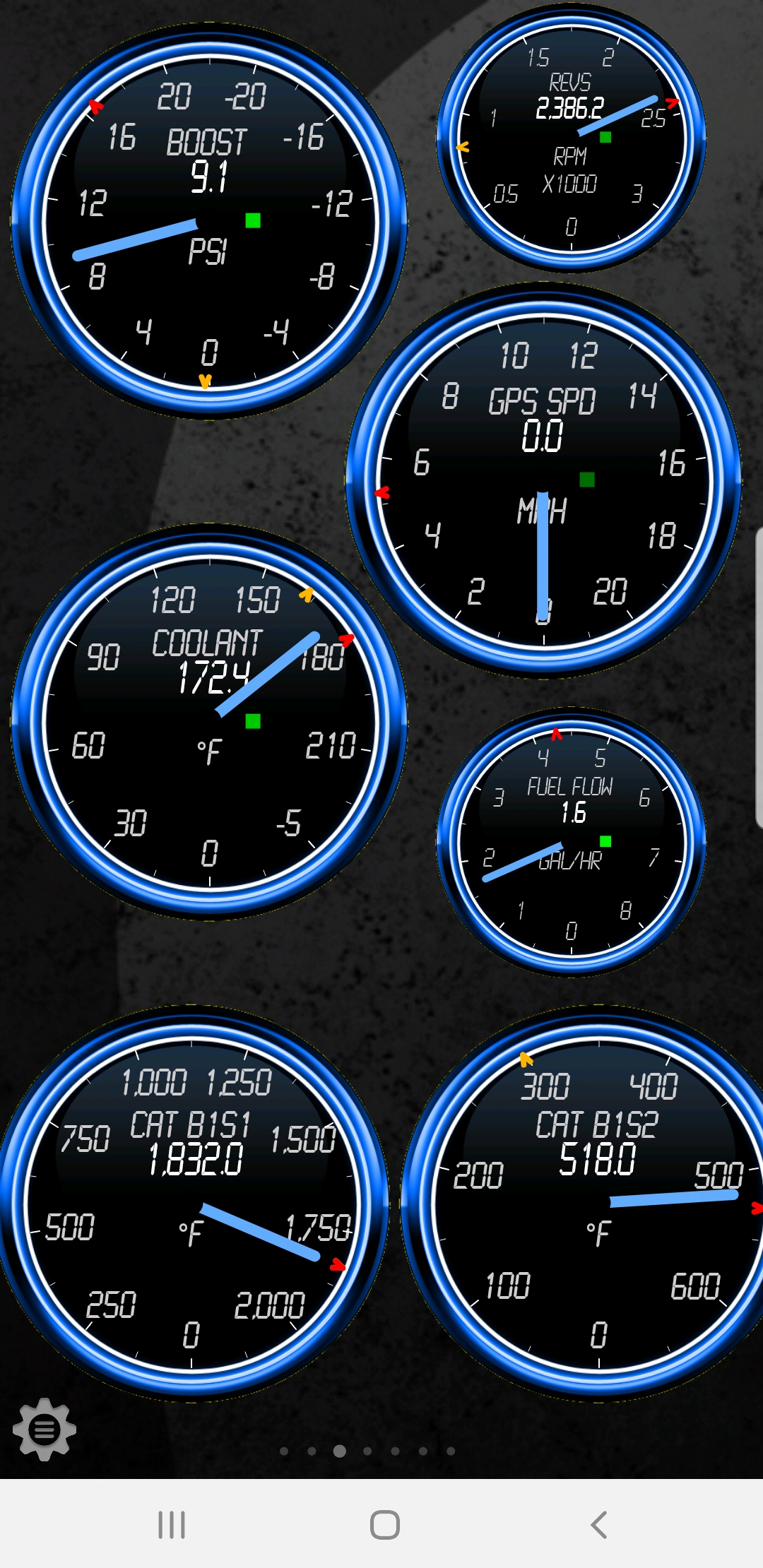

Today roading over to feed the cows I saw a little over 16 psi on the torque app. Didn't get a pic until I got to the gate. You can see the Red marker(s) indicating the highest reading(s).

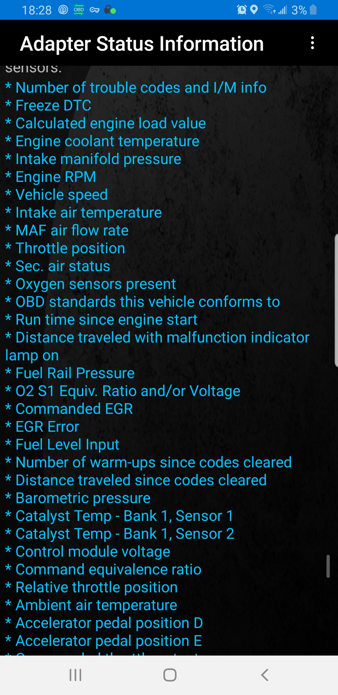

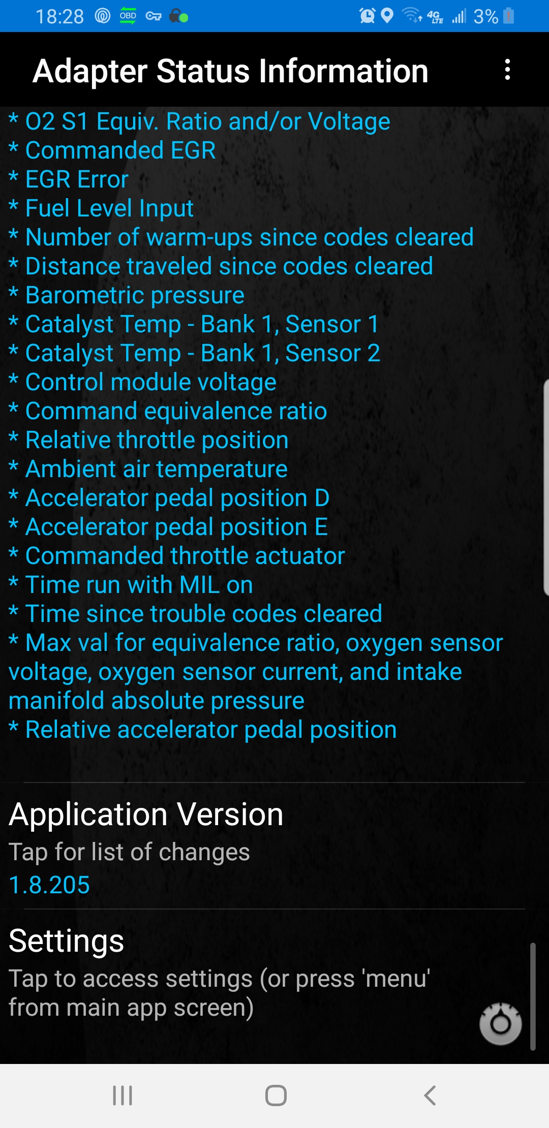

Here are the available sensors according to TP. Couldn't get them all in one screen shot.
Sure would like to get EGT, Oil temp and Hydraulic oil temp. I have been tempted to put aftermarked oil/hydraulic gauges in myself.

What tool is that? I use the Blue Driver for my scan tool on other vehicles (havent put it on the tractor yet) but I like how that one is laid out.

In my tinkering "Torque Pro" has proven to be the best app.

Torque has a list of all possible sensor values and if you connect and go to the gauge setup section, the values that Torque sees are highlighted so you can skip the ones that are not available on the current vehicle.
