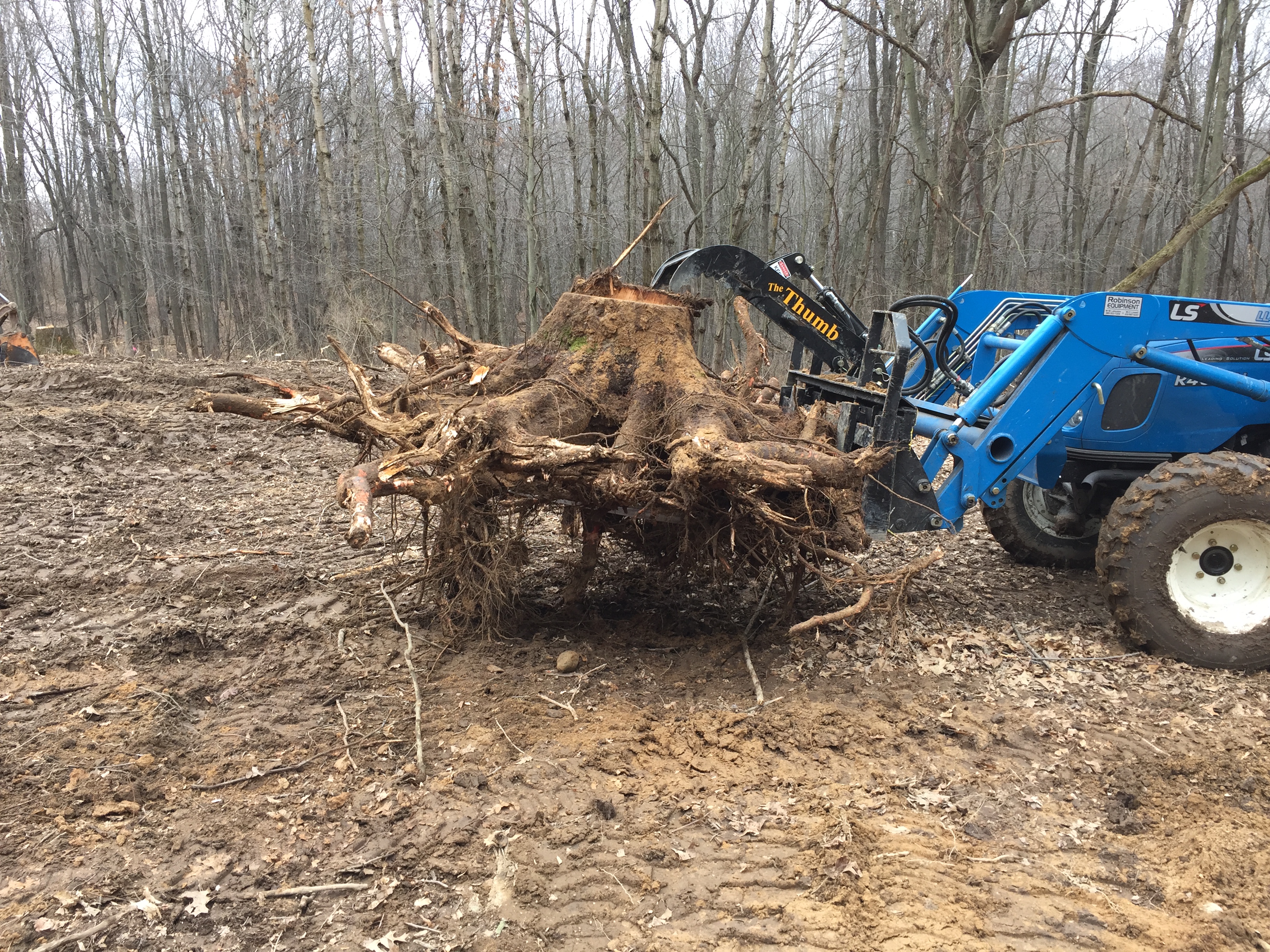

That looks like something that would be just the ticket for my needs.
Is that a commercial unit, or did you build it?
Do you have some detail pictures of how the grapple is mounted, hinged and powered?
Thanks.
   / Sawyer Rob - About that Fork/Grapple combination #2
I bought the combo from ALO, they are IMO the best loader mfg. on the market! ALO makes the factory loaders for all the bigger Massey's, CIH, NH's ect...
You buy their pallet forks, and they sell the grapple as an option. It slides right on the pallet fork frame as it's made right for it, it's about as perfect design as it could be.
It's powered from the remotes out on the loader arms, and activated by a button on the joy stick,
They are super strong, I slide the pallet forks together, and push them right into the ground, grappling a big rock and pulling it right up and out of the ground!! lol
They are just so usefull!!
