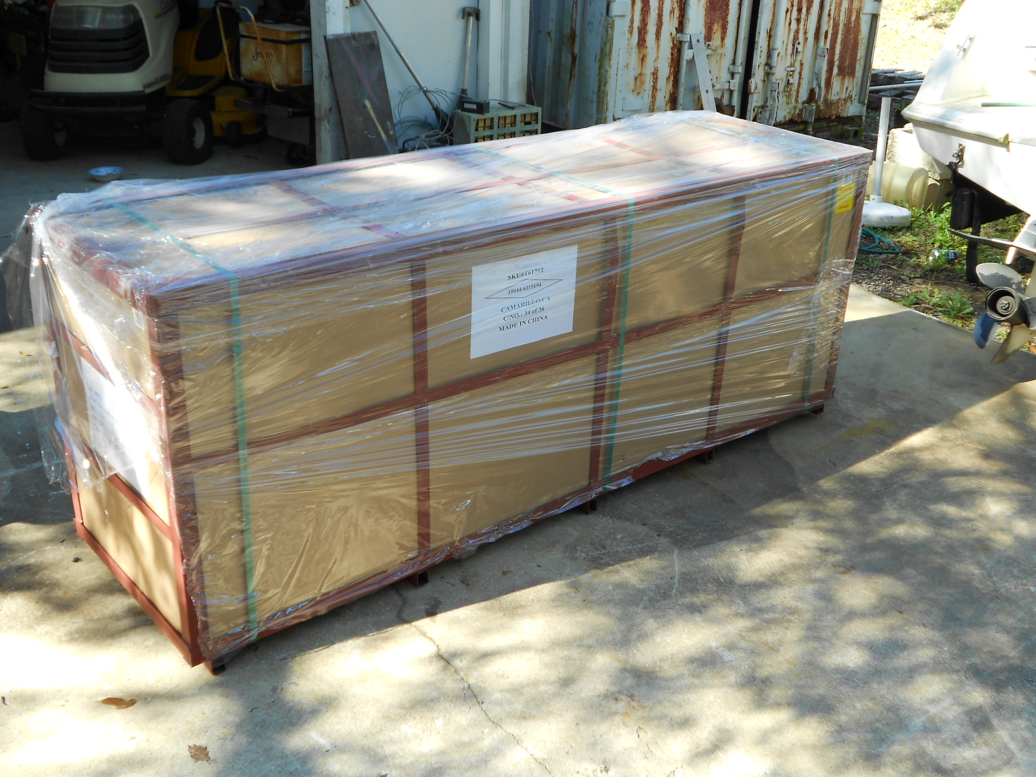

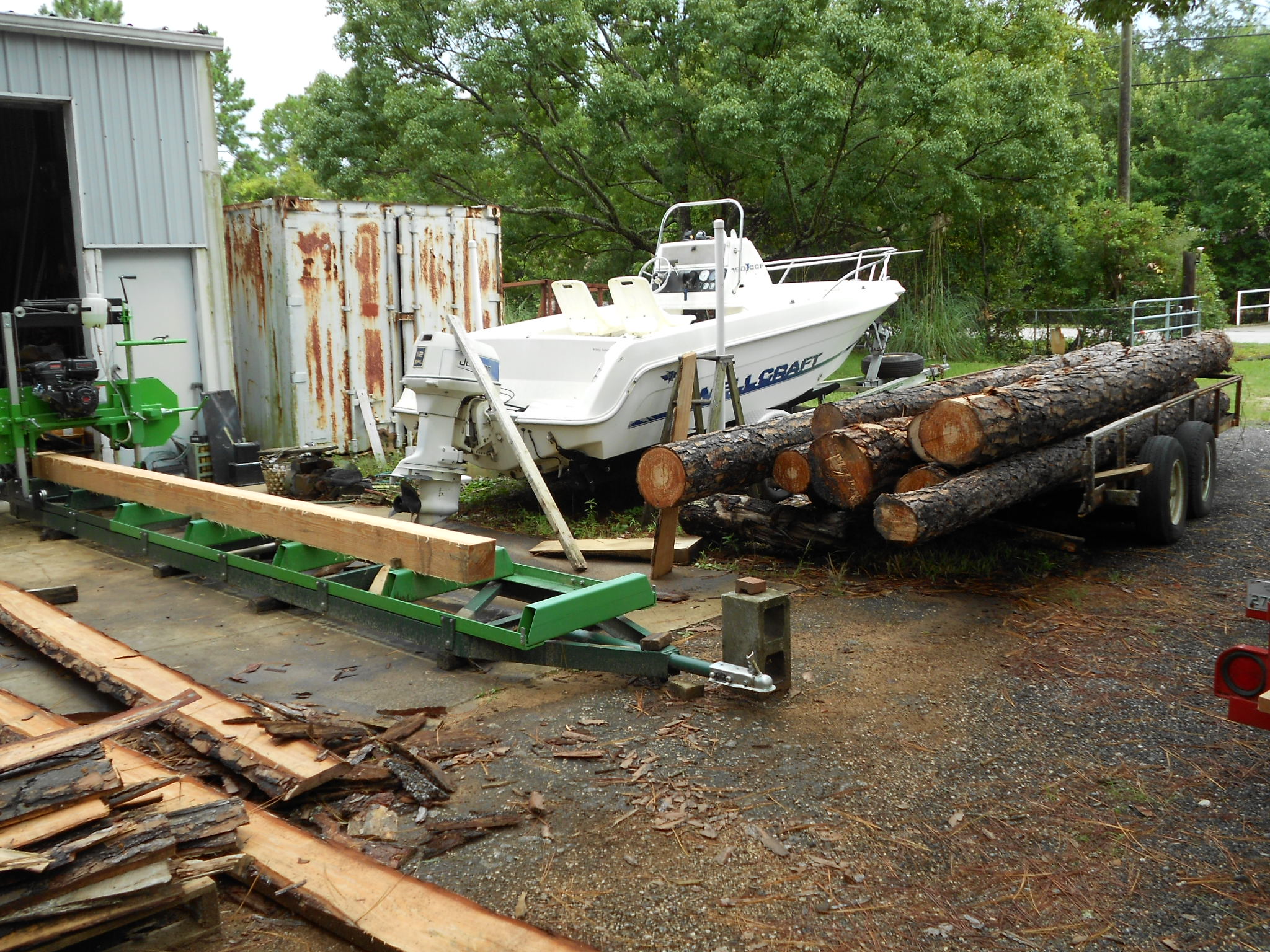

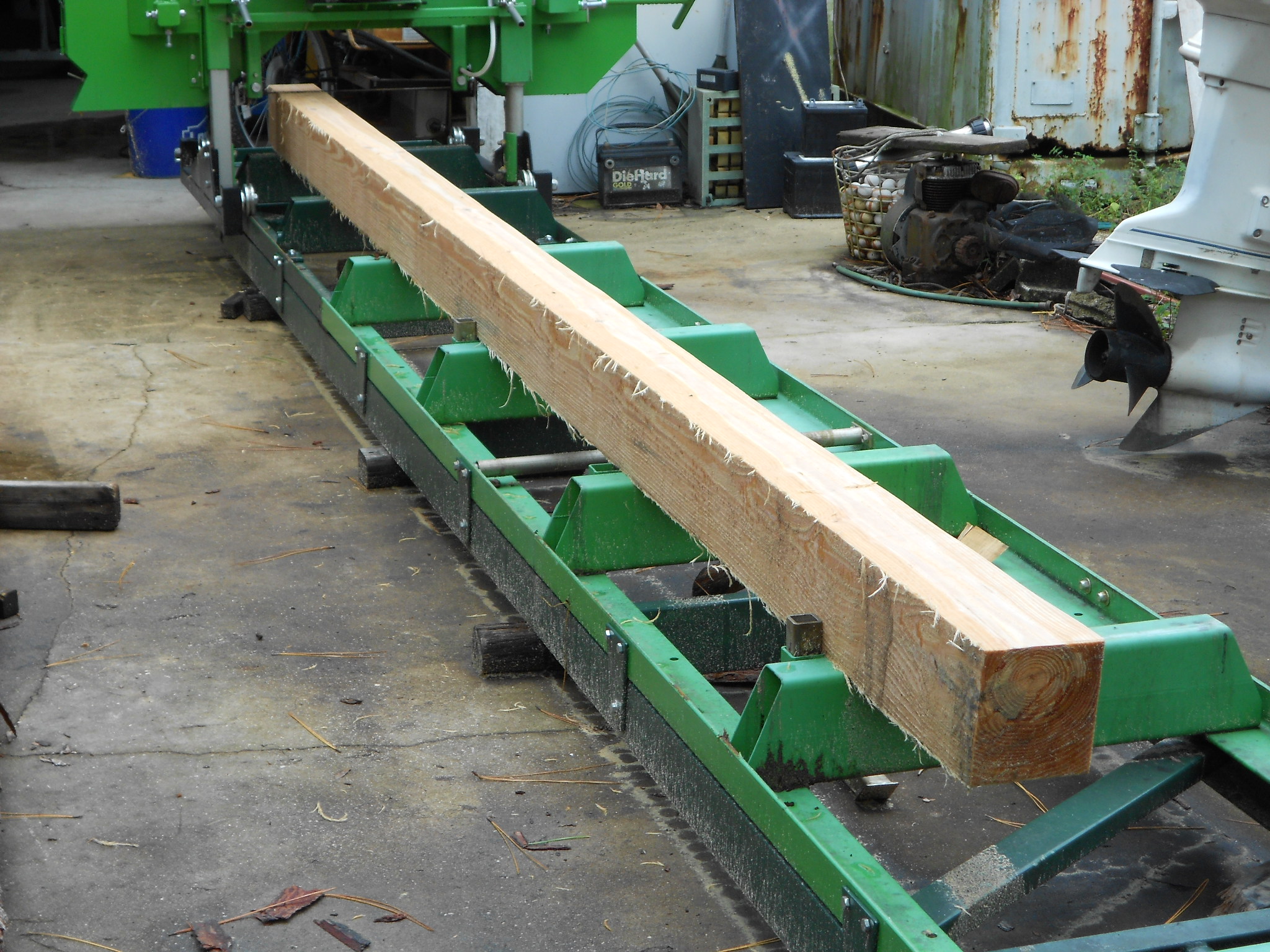

I've had the HF Mill for about 5-6 years and think it is well worth the money!
I did make a bed extension so I can cut 16' boards.
There is a learning curve but it's not bad and mistakes are not that expensive. (wasted logs)
I think it is fun to make boards out of logs. If you have an A M then you should know what I mean.
