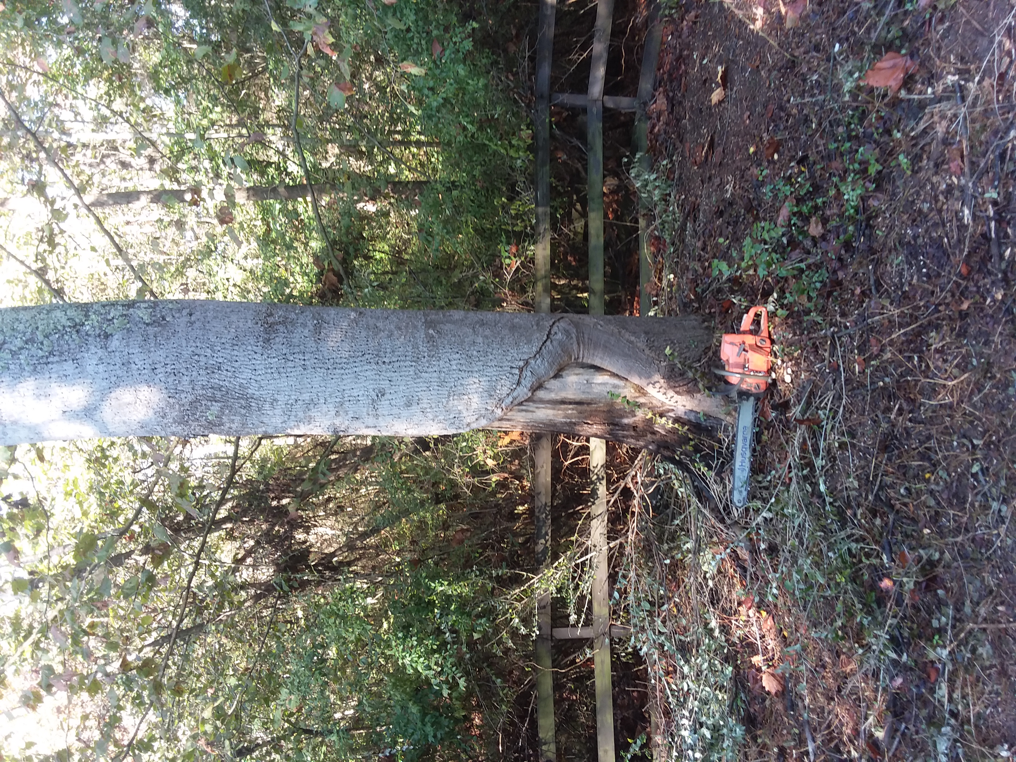

My Husqvarna 365 is 21 years old. Always been good till now. Cutting some trees for a customer when it ran out of fuel. Filled it went to finish and saw would only run wide open, if it tries to idle it dies. Have to choke to start and same thing. Tried different gas no change. Obviously it gets fuel or it wouldn't run wide open. So filter is good. When you return to idle it sounds like a saw does when it runs out of fuel. Is it sucking air?
Any suggestions. I hate to take it to a shop.
