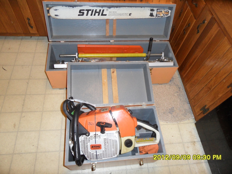

I paid $450 for this Stihl 120cc setup:
attachment.php
But it came with a $200 Granberg Alaskan MK III chain saw mill, so I thought it was worth the price :).
Got to love CL.
