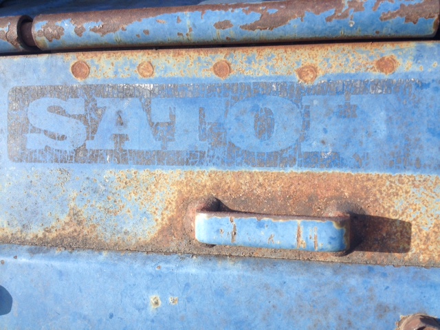

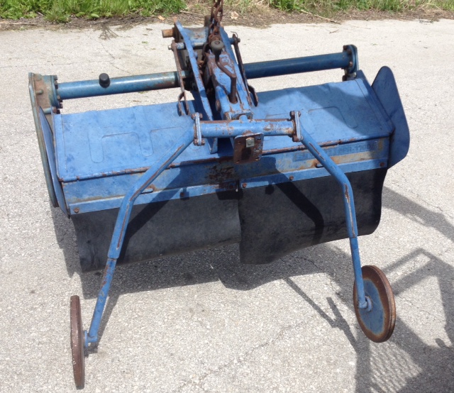

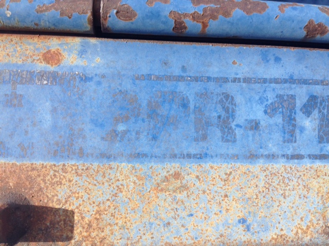

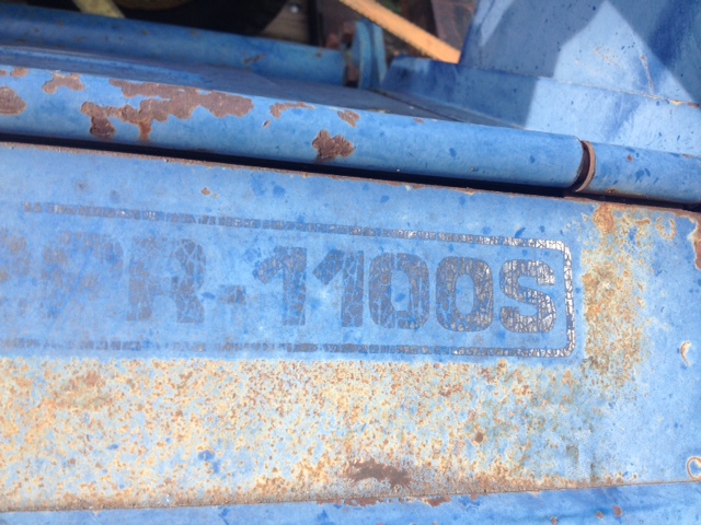

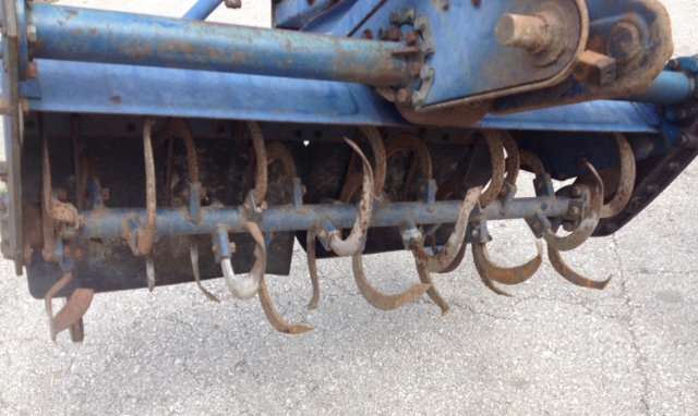

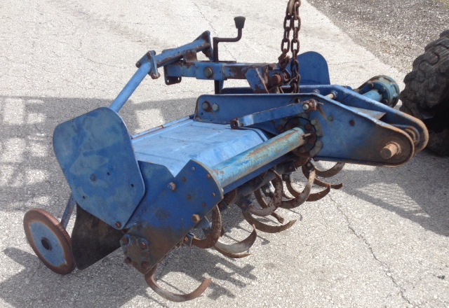

I've found a Satoh rototiller that I want to sell and wanted to let you guys know.
I've never put power to it but it spins free by hand and is nice and quiet.
It's located in Kansas City Mo. but I'm also willing to ship it.

Looks like that would be an interesting job to adapt that to a Cat. 0 hitch. Do you have the complete driveshaft and what does it have on the other end 540PTO? How much are you asking for it?
Bryce
   / Satoh rototiller 2PR 1100s #3

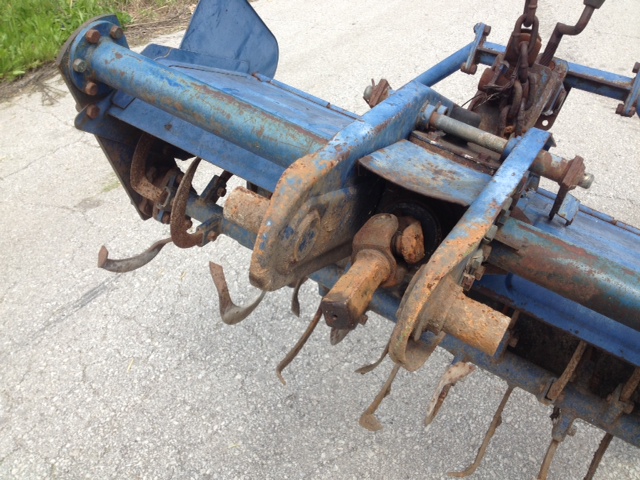

Which direction PTO does the tiller take? Some (maybe all of this model?) used counter-clockwise PTO inputs.

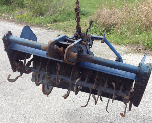

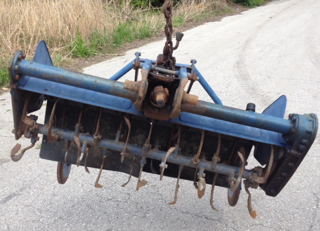

Sorry I should have said I'm asking $600 for it.
I've pictured what I have and I believe that's all that necessary to run it on the Satoh tractor.

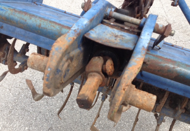

   / Satoh rototiller 2PR 1100s #5
Do you have the front half of the pto shaft??? thanks; sonny580
   / Satoh rototiller 2PR 1100s #6
Here's a picture of a couple of the additional parts needed to use that tiller on a Mitsubishi/Satoh tractor. Pictured are the front half of the drive shaft. This mates with the square shaft on the tiller and the other end goes on the native spline of the PTO (not out of a reverser box - the reverser box needs to be removed to use the tiller). The second piece is a the large blue bracket that accepts the round pins pictured on the front of the tiller. There are also some special spacers and pins to fix the tiller to the bracket that I don't have pictures of. Hope this helps explain whats needed!
   / Satoh rototiller 2PR 1100s #7
This tiller was built for the S370. It is a reverse rotation from the standard pto, has 18 spline pto, & uses a 2 point hook up.
