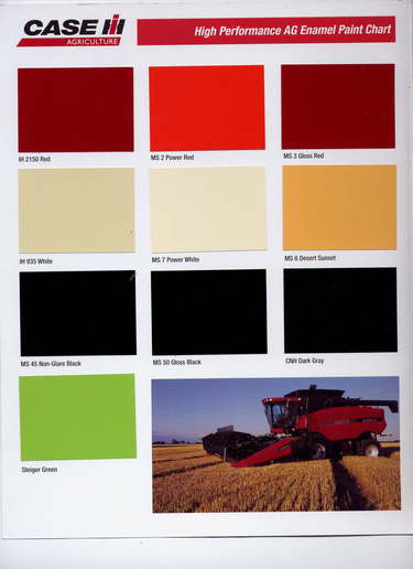

I shot the rims with IH White and its not white at all, its beige!
:confused:

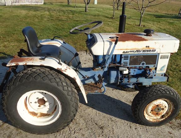

Do you have pictures of tractors you have painted?
   / Satoh Blue and White
Here is what my tractor looked like orignally.
I will post a picture of what the rims look like tonight.
I have to think a "gloss white" would be a lot closer??
Also attached is an IH paint chart.

   / Satoh Blue and White #8
