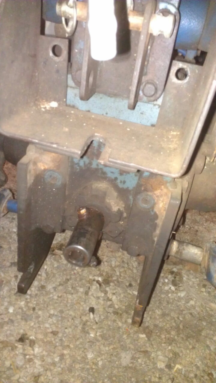

I have a problem that most Satoh owners wish they had. I have an S-370D Beaver with front end loader and backhoe. I just bought an S-373 Beaver with a tiller. Tiller is a 1110S model but what I didn't check before purchase was the PTO rotation. My S-370D PTO turns CCW, this newer Beaver turns CW. My plan was a use the tiller on my S-370D and sell the S-373. The S-373 is in alot better shape than my S-370D. Can I move my backhoe and loader to it? Problem still is the backhoe uses a PTO pump, which needs to turn CCW. I only want to keep one tractor. Any ideas appreciated.
   / Satoh Beaver tiller
#2

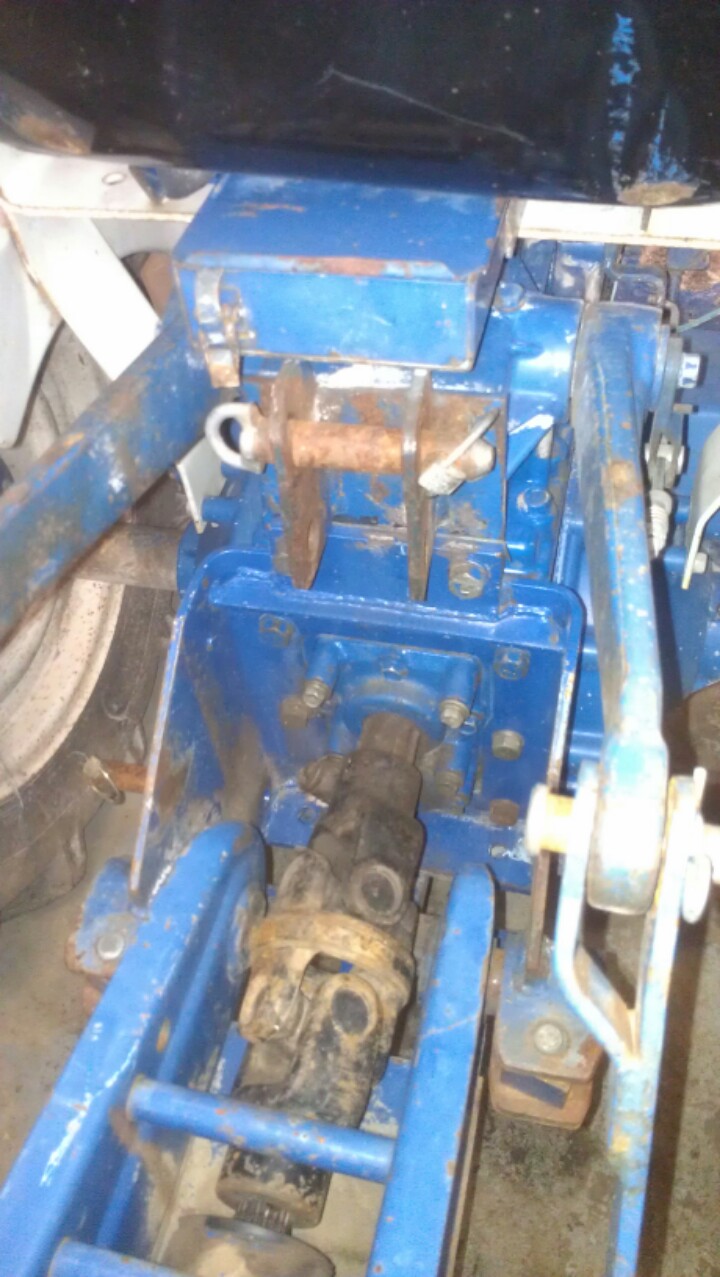

one pic is pto from the S-373 and the other is from my S-370D with the coupler on it for the Backhoe pump. Do I have a PTO reverser on the S-373? Is it easy to remove and put on every time I want to use the tiller?
   / Satoh Beaver tiller #3
373 doesn't appear to use a reverser. Is your backhoe a Blackhawk? I'd think it easier to adapt the loader and hoe to the 373 than it will be to find a reverser for your 370 though I do recall seeing on one eBay recently.

After staring at the tiller with a beer in hand. I came up with a possible answer. Since the tines are removable, all I need to do is remove them and turn them the opposite direction. Also the PTO shaft on the 373 is 6 spline, so I will need the adapter to fit on my 370. What you do guys think of this idea?
   / Satoh Beaver tiller #9
You'll be happier if it's turning properly. If you revers their direction you'll be moving the tilled ground where you don't want it.
Buy the reverser, sell 373 and done.
   / Satoh Beaver tiller #10
I believe there is a tensioner on the drive chain of the tiller that would be damaged if you ran it in a reversed direction.
The adapter is available for the PTO output.
