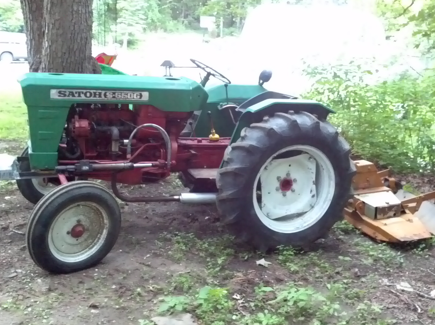

1974 650g satoh
need to know what valve to with and what order after that,when adjusting valves
   / satoh 650g #2
Not sure what you are asking. Please clarify.
   / satoh 650g #3
On any cylinder, Adjust the intake when the exaust starts to open. Adjust the exaust when the intake starts to close.
